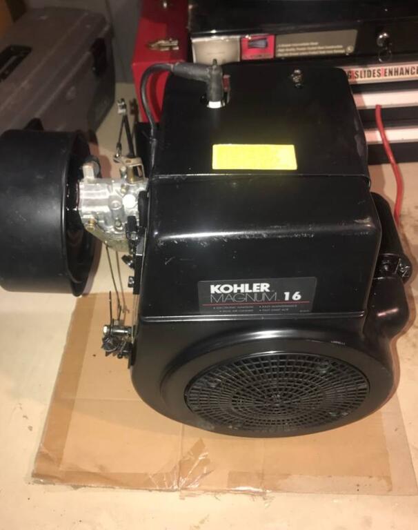

ML3 2,464 #36 Posted December 4, 2025 I did find a Magnum 16 about an hour from me. Just not sure if its enough hp/torque to run the Bervac as well as the hydro too..... Also may have a lead on 18hp Briggs thats out of a Workhorse 1 Share this post Link to post Share on other sites

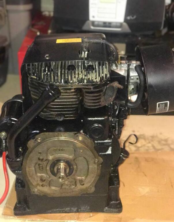

bds1984 1,516 #37 Posted December 5, 2025 A K341 will have more than enough power for your need. The only concern I would have with the example you found is the stubby crankshaft on the PTO side. 2 1 Share this post Link to post Share on other sites

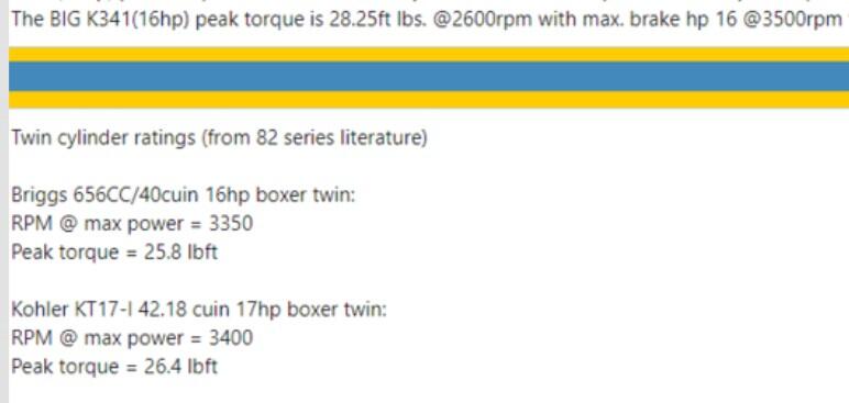

ebinmaine 80,068 #39 Posted December 5, 2025 Here's some interesting numbers. The 16 HP single cylinder Kohler torque is 28.25. KT17 Kohler twin is LOWER at 25.8. That's fine most of time but WILL matter under serious loads. The Briggs... I couldn't find a direct comparison but this 16 HP opposed twin would obviously be close. It would be reasonable to assume that an 18 HP would be 2 to 2.5 lb-ft higher. So figure 27.8 to 28.3 for a Briggs 18. I'd still take a Kohler 16 single cylinder... rougher running for sure. And VERY strong for the given amount of cubic inches. 3 1 Share this post Link to post Share on other sites
sqrlgtr 3,583 #40 Posted December 5, 2025 Just for giggles what is the shaft size for a k341 Kohler on say a C160? I thought that pic of the shaft looked smaller dia. and length, but pics are deceiving sometimes. 1 Share this post Link to post Share on other sites
ebinmaine 80,068 #41 Posted December 5, 2025 4 minutes ago, sqrlgtr said: Just for giggles what is the shaft size for a k341 Kohler on say a C160? I thought that pic of the shaft looked smaller dia. and length, but pics are deceiving sometimes. Seems to me it's a 1 1/8" diameter. Length? @pfrederi any idea? 1 Share this post Link to post Share on other sites
sqrlgtr 3,583 #42 Posted December 5, 2025 1 minute ago, ebinmaine said: Seems to me it's a 1 1/8" diameter. Length? @pfrederi any idea? I thought they were just looked small in pic to me. 1 Share this post Link to post Share on other sites
ML3 2,464 #43 Posted December 5, 2025 11 minutes ago, ebinmaine said: Seems to me it's a 1 1/8" diameter. Length? @pfrederi any idea? The seller said in the ad that the shaft is 1". I'll contact to ask bout the length. From what little I researched it there were a few different shaft sizes for the magnum16. For sure dont want to be under powered or even just adequately powered. Really dont want to go under the original 18hp. Its still a fairy expensive purchase & last thing I want is to go through all the trouble & have it not work well. As far as the single Kohler being rougher running.....I dont care about that. Still gonna see what happens with the 18hp from other lead I have...... 1 Share this post Link to post Share on other sites

kpinnc 18,851 #46 Posted December 5, 2025 3 hours ago, ML3 said: did find a Magnum 16 about an hour from me. Just not sure if its enough hp/torque to run the Bervac as well as the hydro too..... Also may have a lead on 18hp Briggs thats out of a Workhorse Normally I would say between these the Kohler is superior. A Kohler Magnum engine is nearly bullet proof with decades of longevity built in. The engine in your pic is unfortunately not suitable for Wheel Horse in any way due to the stubby PTO shaft. No adapter made will make it capable of supporting the side loads generated on these machines. If you made it work, it would eventually fail and likely damage things even possibly the operator. If the Briggs has at least 2 and 3/4 inches of PTO shaft it will work better in this case. If you have to sleeve it to 1.125, it is still a safe option. I'm a huge fan of Briggs Vanguard v-twins. I have several of them. That being said, I do not expect them to last like a cast iron Kohler will. 3 Share this post Link to post Share on other sites
