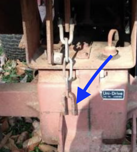

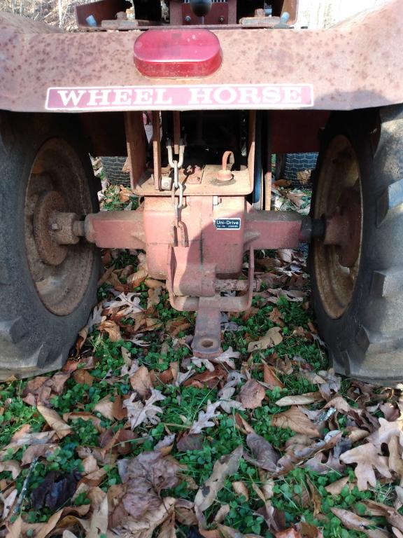

Handy Don 17,558 #3 Posted November 19, 2025 (edited) By the way, this clevis (blue arrow) attaches to the top of the clevis hitch's arm for lifting. At some point, a PO had an implement on the rear of this tractor. Edited November 19, 2025 by Handy Don Share this post Link to post Share on other sites
