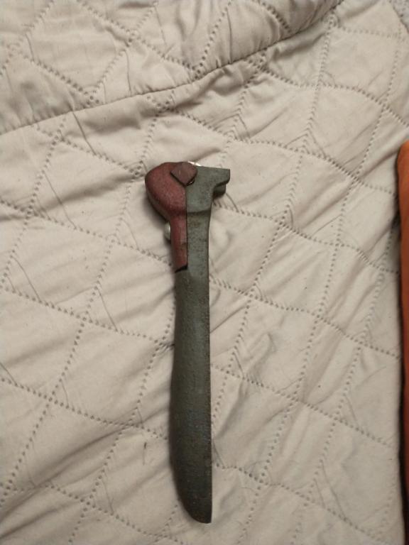

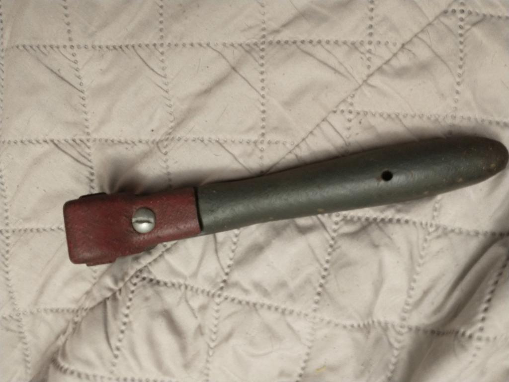

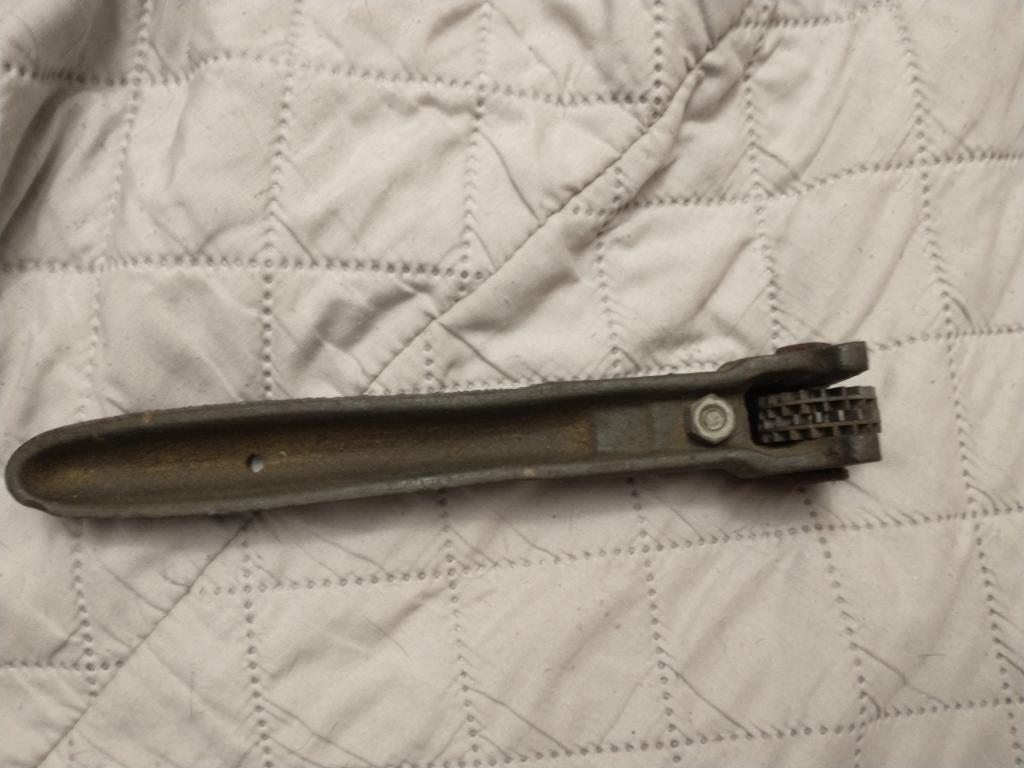

ebinmaine 77,541 #1 Posted November 18, 2025 This was with a bench grinder we just got from an auction. It has 4 separate "gear" rollers? that move independently of one another. A stone dressing tool of some sort? 2 Share this post Link to post Share on other sites
Bar Nuthin 2,219 #2 Posted November 18, 2025 (edited) That's a dressing tool for your grinding wheels. To true up the face of the stone. Best if you have a solid guide you can rest against to stay flat with the face of the stone. Edited November 18, 2025 by Bar Nuthin 10 1 1 Share this post Link to post Share on other sites
Ed Kennell 45,039 #3 Posted November 18, 2025 I have better results using the single diamond point dresser. Working the stop against the grinder work rest. 1 1 1 Share this post Link to post Share on other sites

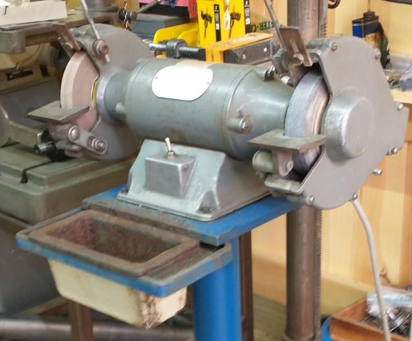

ebinmaine 77,541 #4 Posted November 18, 2025 2 hours ago, Bar Nuthin said: solid guide you can rest against Here's the machine. Two solid guides. Two different stones at two different angles. 1 hour ago, Ed Kennell said: I have better results using the single diamond point dresser. Working the stop against the grinder work rest. I have a couple much smaller dressing tools made from square stock coated with diamond grit. Never used a round ended one. 2 1 Share this post Link to post Share on other sites
formariz 12,356 #5 Posted November 18, 2025 (edited) Curiously I never liked using either type. I use and have great results using an old used diamond cutting saw blade. I find it easier to control and more versatile being able to use the very tip or the sides. Easier to control with faster results. Edited November 18, 2025 by formariz 5 4 Share this post Link to post Share on other sites
ri702bill 11,395 #6 Posted November 19, 2025 Similar to the one I have... I did have to disassemble it to add a washer spacer at one end of the stack to limit the amount of "wander" the wheels had. That improved the wheel finish. I thought for a minute that the wheel on the right of your grinder was green, not gray. Green is for dressing carbide - and that wheel is expensive... 1 Share this post Link to post Share on other sites

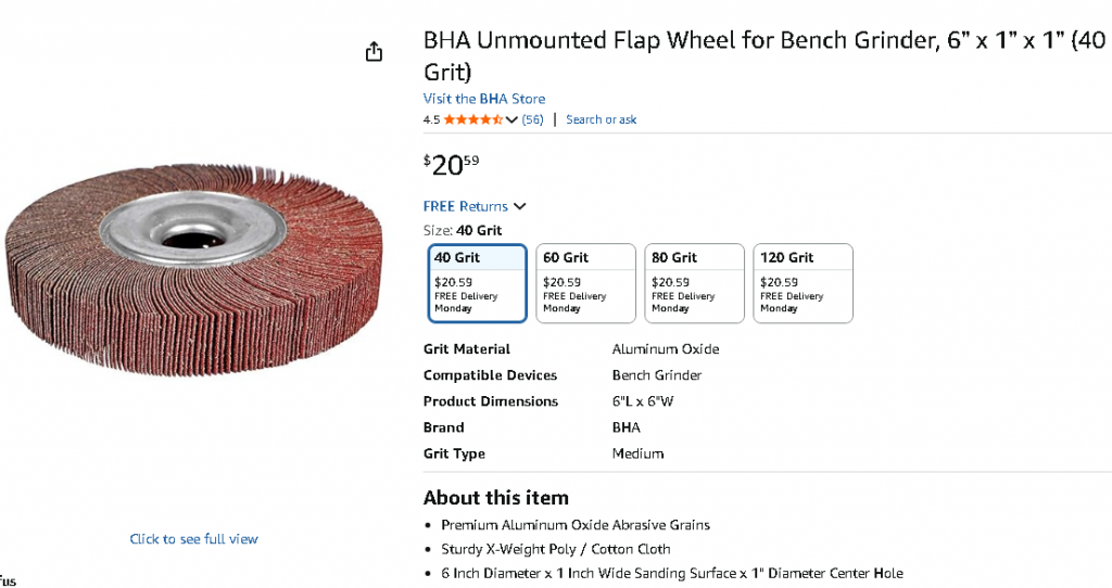

JoeM 9,646 #7 Posted November 19, 2025 Not much for stone wheels, installed a 6 inch flap disc. It self levels. I really have no need to sharpen tooling tho. About once a year I can reinstall a wheel and do the saved up bits etc, and have a session. 4 Share this post Link to post Share on other sites
ebinmaine 77,541 #8 Posted November 19, 2025 39 minutes ago, JoeM said: Not much for stone wheels, installed a 6 inch flap disc. It self levels. I really have no need to sharpen tooling tho. About once a year I can reinstall a wheel and do the saved up bits etc, and have a session. Interesting thought. I could do that too. What grit wheel do you use? Share this post Link to post Share on other sites
lynnmor 8,645 #9 Posted November 19, 2025 Your wheel dresser may need new star wheels. This type of dresser works well if you are grinding things that quickly load up the wheel, they quickly clean and true the wheel but the dust can be incredible. 3 1 Share this post Link to post Share on other sites

ri702bill 11,395 #11 Posted November 19, 2025 Your wheel dresser may need new star wheels... Yup. Those wheels wear as does the stone wheel. 1 Share this post Link to post Share on other sites

JoeM 9,646 #14 Posted November 19, 2025 I have an 80 on it now but 40 is best for what I do. Got to check to see if the wheel comes with spacer bushings to fit the grinder shaft, I had a set from before and can't remember is these came with or without. 1 2 Share this post Link to post Share on other sites

ebinmaine 77,541 #18 Posted November 19, 2025 25 minutes ago, JoeM said: I debur metal stuff, edges, holes etc. the flap works real nice for sharping axes, mower blades too. I did use it some on small parts to take off some paint along with a wire wheel on the other side of the grinder. Kind of the clean up center. Pretty much identical to our usage here. Definitely a worthwhile looksee into the flapper for me. Share this post Link to post Share on other sites
