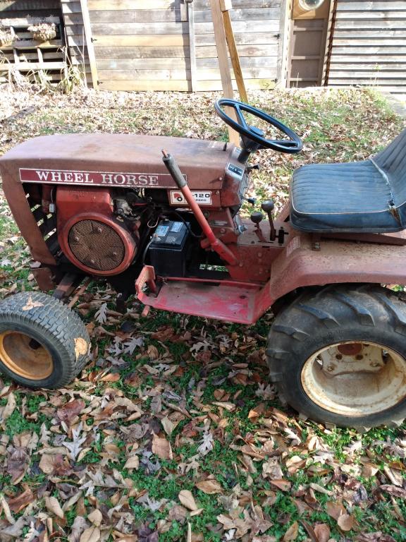

NCSteve 24 #1 Posted November 18, 2025 I have owned my 1976 C120 now for 30 minutes! I bought it to do some driveway leveling, so now I need to start researching blades and blade attachments. The tractor appears sound, and it starts and runs ok, but it moves very slowly. I need to explore belt, clutch spring, etc. I think. Any suggestions for reasonably priced blades would be welcomed! 2 4 Share this post Link to post Share on other sites

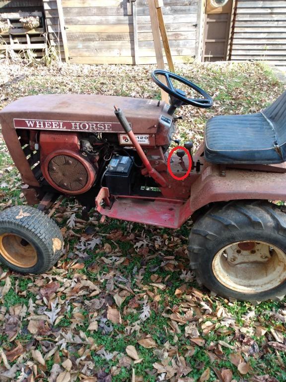

8ntruck 9,420 #4 Posted November 18, 2025 to the forum. The C120 is a very capable machine. It should handle driveway grading just fine. As far as the tractor moving very slowly, you need to know that it has a two range transmission. When in low range, high gear is just a tad faster than 1st gear in high range. 1st gear in low range is about 1 mph - maybe. The short shift lever that moves right and left is for selecting high or low range. Left for low, right for high. In your picture, it looks like it might be in the low range position. The shifter fork on the high/low range shifter can be damaged if you use excess force on it. Good luck and have fun with your recently acquired toy, no, tool. Check out the manuals section of the forum. You will probably find an owner's manual for your machine there. 3 Share this post Link to post Share on other sites
953 nut 70,653 #5 Posted November 18, 2025 In your photo I can see that the High-Low range lever is in the Low position. The attached owner manual should be helpful. 3 4 Share this post Link to post Share on other sites

NCSteve 24 #8 Posted November 19, 2025 Thank you all for the kind welcome and good advice. I can easily shift into all the gears in both H and L range. I think the belt is the problem.It is very loose and looks ancient! I will replace that first. 3 Share this post Link to post Share on other sites

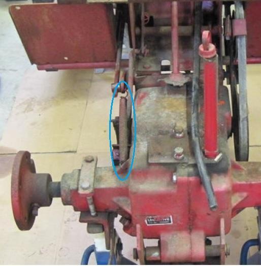

Racinbob 13,290 #13 Posted November 20, 2025 I'm onboard with Eric on the drive belt. You're best to just use a Toro belt. Do a search for Wheel Horse (or Toro) 7473. Also like he said the idler can be suspect. Make sure it's good or just replace it. Then there's the spring. I've seen many replaced with something close from the hardware store. That's a no no. While you're searching for the belt also search for a 108035. I always try to keep a couple spares on the shelf. Once you've addressed those items and you have it working well you can go on to tweak the linkage if you'd like to but I've found that unless there's excessive wear it's really not needed. 1 1 Share this post Link to post Share on other sites
