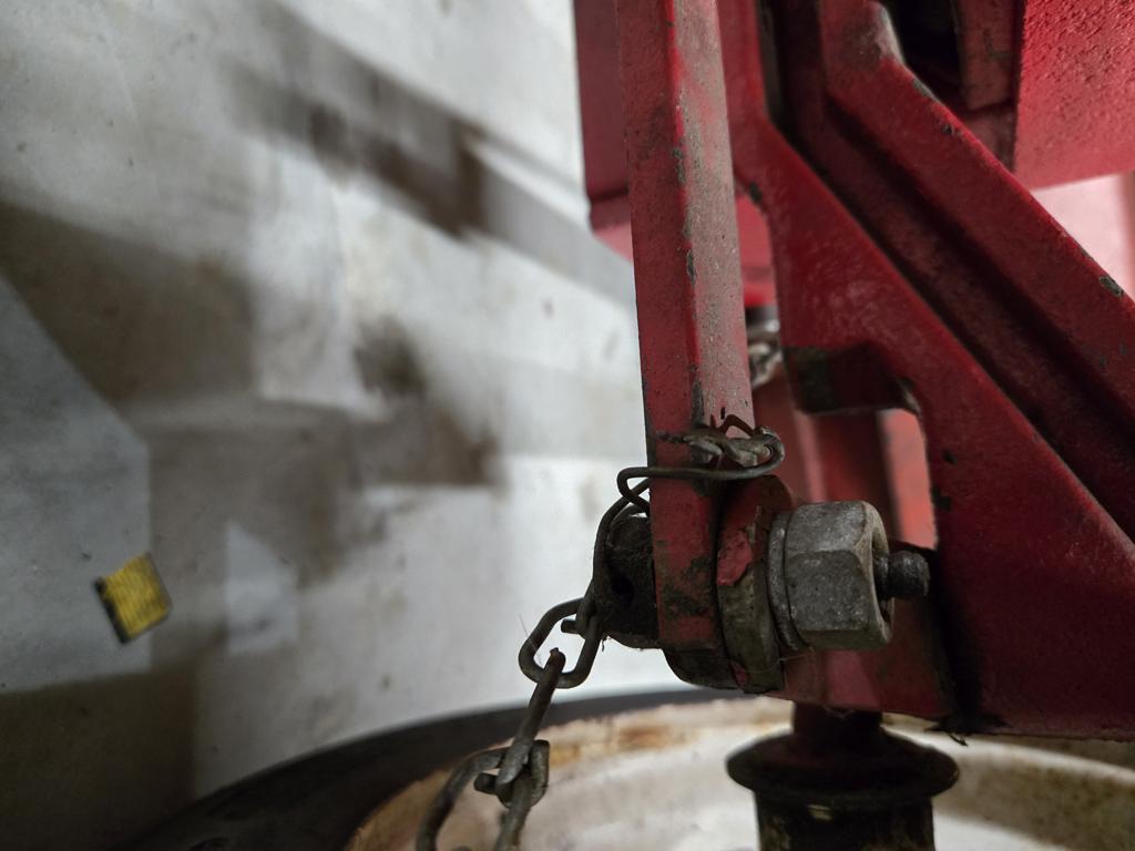

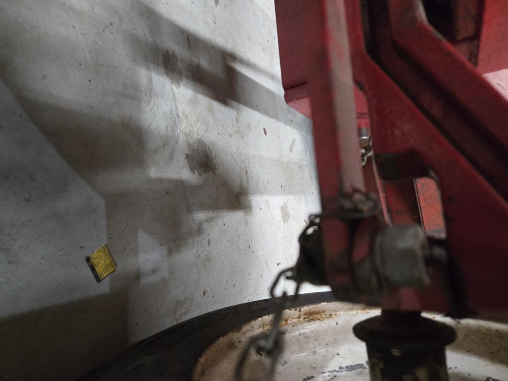

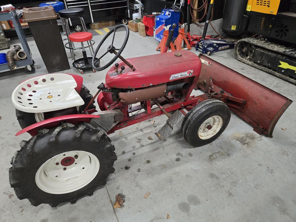

WH-Dave 7 #1 Posted November 17, 2025 Does anyone have any photos of a Suburban with a plow and the pedal hooked up to the pin for changing the blade angle? I recently bought the plow pedal off eBay, but I can’t figure out how the chain is supposed to route without rubbing on the front axle. Did they just let it rub back in the day? I’ll post some photos later. 2 Share this post Link to post Share on other sites

wallfish 20,744 #5 Posted November 18, 2025 2 hours ago, WH-Dave said: I’ll post some photos later. post them The pin hangs lower than the axle and the lower end of the pedal is much lower than the axle so it shouldn't be touching it. It might if you have a RJ frame mount on a Suburban tractor. The frame mount should look just like the drawings posted 2 Share this post Link to post Share on other sites

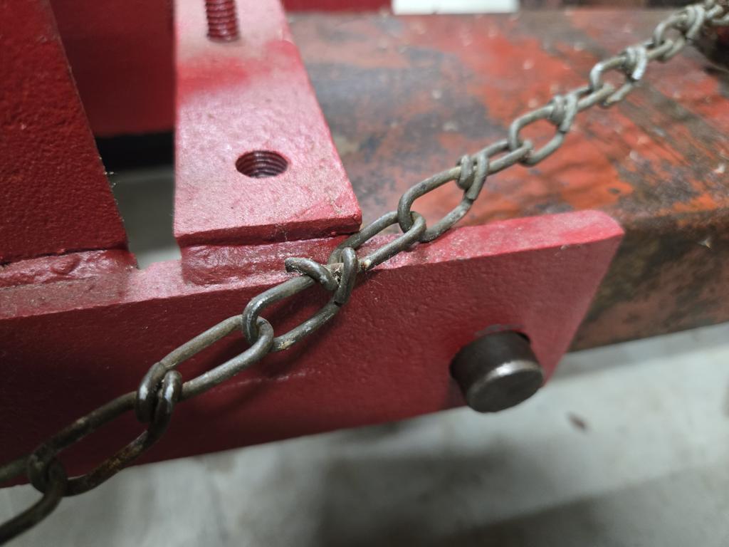

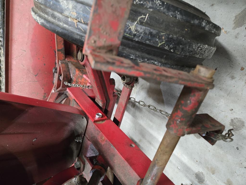

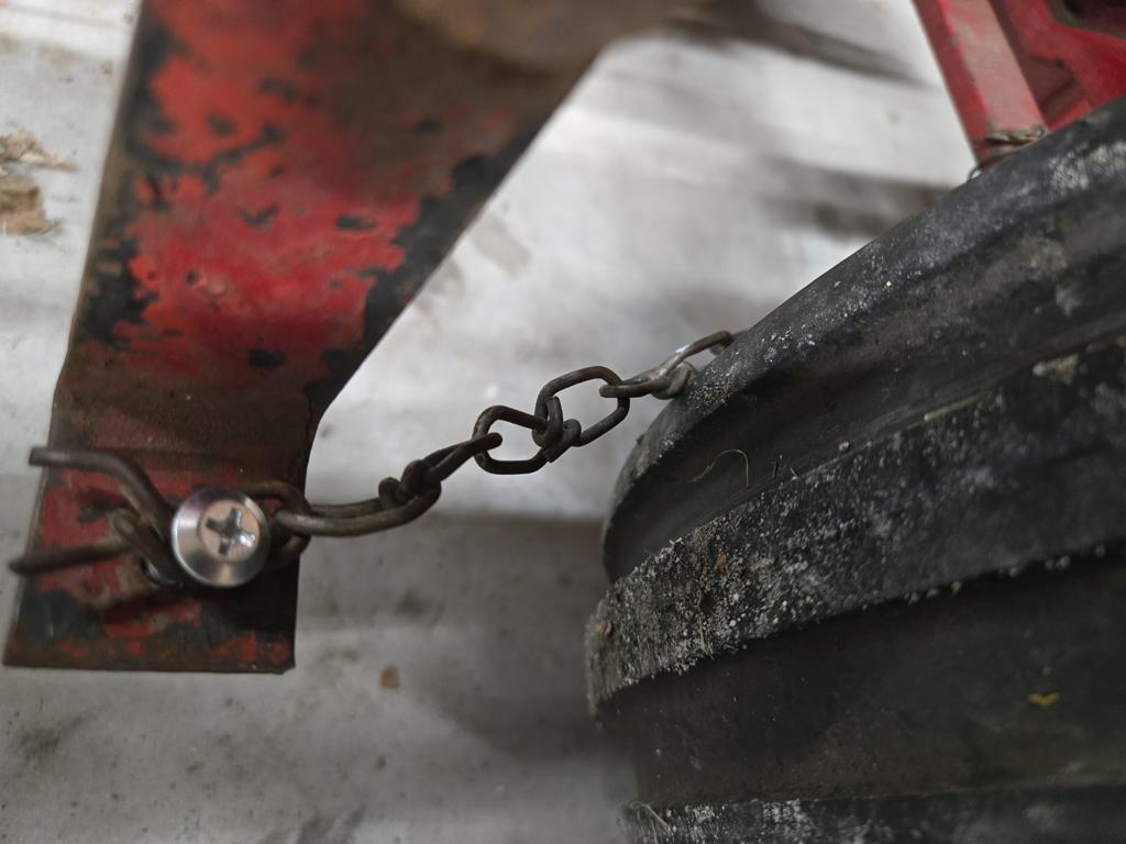

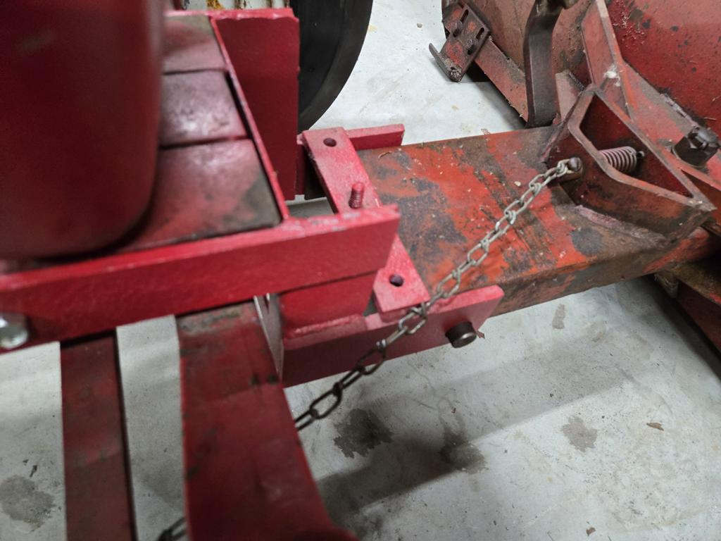

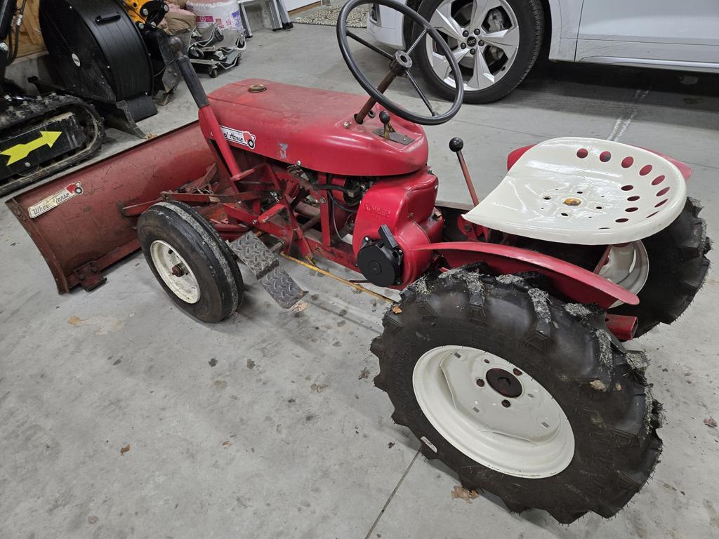

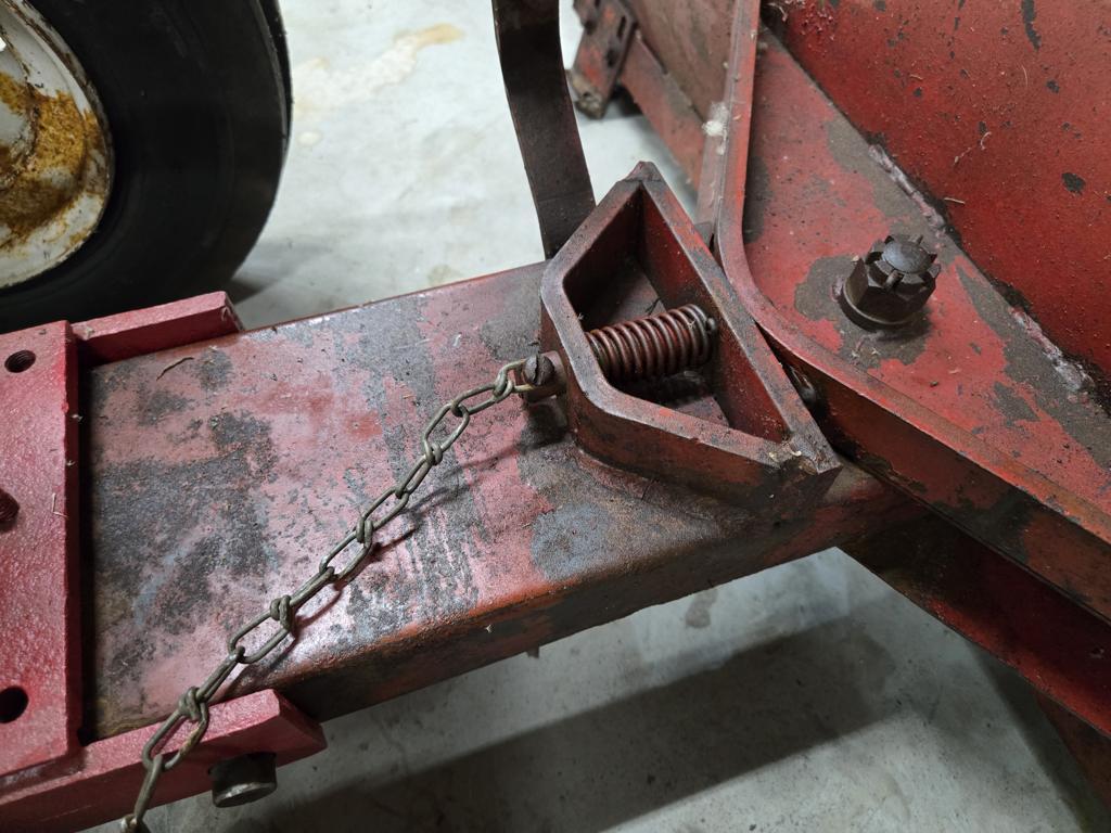

WH-Dave 7 #6 Posted November 20, 2025 (edited) Here are a few photos. The first couple are just to show the tractor. The rest show where the chain hits. I tried flipping the pedal around both ways. I originally thought it went above the axle, but now it seems clear that it goes below… I think. It's a work in progress, don't judge the random bolts, etc Edited November 20, 2025 by WH-Dave Share this post Link to post Share on other sites
