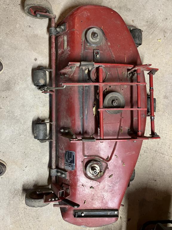

Toolmanbill 48 #1 Posted November 17, 2025 (edited) Trying to get deck welded and need to remove pulley and spindle and get the pulley off.looks like it should pull off.is it possible it is just frozen? I live in the woods and it is tough on the decks.this is the 3rd deck in 31 years. 2 sets of # on deck 1542sd03 and 1050621.any advice would be appreciated. Edited November 17, 2025 by Toolmanbill 1 Share this post Link to post Share on other sites

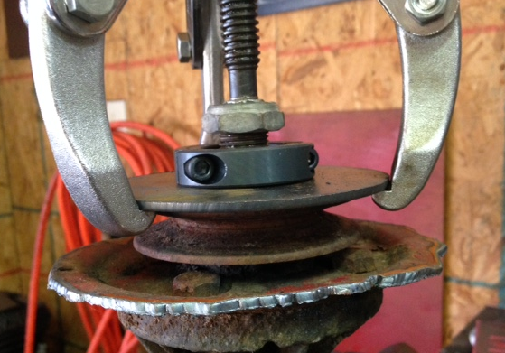

Ed Kennell 47,946 #2 Posted November 17, 2025 Two of these work ....sometimes. 1 Share this post Link to post Share on other sites
nylyon-(Admin) 9,196 #3 Posted November 17, 2025 What Ed said, have to get under the center of the pulley. I have had a couple where the pulley just bent, then have to get a new pulley. 1 Share this post Link to post Share on other sites

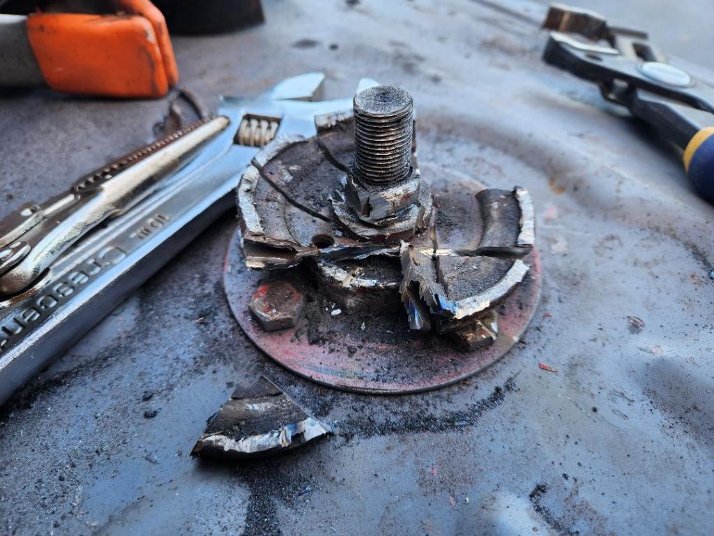

Brockport Bill 2,553 #5 Posted November 17, 2025 i have had a few decks i bought used that i tried to rescue rehab that had obviously been left outdoors -- I used every imaginable idea and suggestion but they were totally rust frozen on shaft -- used multiple penetrant products for weeks -- used heat - used wheel puller - used 2 pry bars etc -- but at some point i had to surrender to the rust gods -- then its time to cut pulleys off -- the biggest challenge then is to not destroy the top of shaft with grinder disc which sadly isn't always possible. Just recently had to buy two new spindle shafts from KB. 1 Share this post Link to post Share on other sites

peter lena 10,125 #8 Posted November 17, 2025 @Toolmanbill your second picture is perfect for wonder bar placement, need 2 WONDER BARS , slide one on each side UNDER PULLEY AND ROCKING on the spindle mount bolt , push both bars OUTWARD t the same time , the leverage equalization ,gives a solid EQUAL LIFTING FORCE , of course penetrating oil before attempt , done a number of them , makes a tough job easy , you are PUTTING 90 DEGREE BAR END UNDER PULLER , ON TOP OF BOLTS THAT HOLD SPINDLE TO DECK , lift off is easy . if it were me I would also plan on doing bearing swap out and re greasing those spindle bearings , lucas xtra HD green chassis grease , done a number of decks , have also added a spindle belt idler , to reduce belt bounce . let me know how you are doing , pete 1 Share this post Link to post Share on other sites

JoeM 10,318 #10 Posted November 17, 2025 I drive wood wedges under two sides of the pulley, you have to try to get as close to center as possible. I use door and window shims and put the nut on the top of the thread and give the shaft a wack. sometimes heat will help. I tried this one time and could not get enough clamping force on the fit. and it pulled off. Might have gave up to soon and should have redesigned the clamp. 1 Share this post Link to post Share on other sites
953 nut 70,653 #11 Posted November 18, 2025 8 minutes ago, JoeM said: drive wood wedges under two sides of the pulley, you have to try to get as close to center as possible. I use door and window shims and put the nut on the top of the thread and give the shaft a wack. A pair of wooden wedges on each side of the pulley driven toward one another will provide good even pressure. Put the nut on the shaft and use a brass hammer or a piece of hardwood to protect the threads and a BFH Tool with a good hard whack should pop it off. 1 Share this post Link to post Share on other sites
Brockport Bill 2,553 #12 Posted November 18, 2025 i have used the map gas -- multiple penetrants - plus the 2 "wonder" pry bars - and the hub puller -- none worked after many weeks -- thus was time to cut off the pulley Share this post Link to post Share on other sites

JoeM 10,318 #15 Posted November 18, 2025 (edited) On 11/17/2025 at 7:13 PM, 953 nut said: A pair of wooden wedges on each side of the pulley driven toward one another will provide good even pressure. Put the nut on the shaft and use a brass hammer or a piece of hardwood to protect the threads and a BFH Tool with a good hard whack should pop it off exactly! precisely! spot on mate! perfectly said! I do have a fine thread nut welded to a piece of 1/2" square steel that is put on the top of the threaded shaft when the BFH comes out of the drawer. Edited November 19, 2025 by JoeM 2 Share this post Link to post Share on other sites
gwest_ca-(File Mod) 12,557 #16 Posted November 18, 2025 If you have the hub well supported a second sledge hammer and a friend helps. Hold one hammer on the nut and hit it with a second hammer. This prevents damage to the spindle and threads. And don't be afraid to hit it. One good slam is more effective than a few taps. 2 Share this post Link to post Share on other sites
