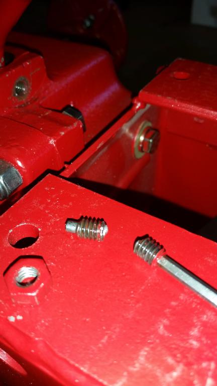

BradKahler 416 #51 Posted November 18, 2025 50 minutes ago, ri702bill said: Yup, sorry to say, but the special full dog point 1/4-20 shifter retainer screw IS broken off and must be dealt with... The unbroken one would protrude out of the boss by about 3/8" to accept a hex nut to set the adjustment. SOMRTIMES, you can get lucky drilling it with a left-handed bit, the size for a screw extractor, aka Easy-Out. Your next task!!! I was afraid it was broken It looks like a good candidate to weld a nut on the end. Any idea if that has been tried before on this bolt? I've used the weld a nut process multiple times in the past with pretty good success. 1 1 Share this post Link to post Share on other sites

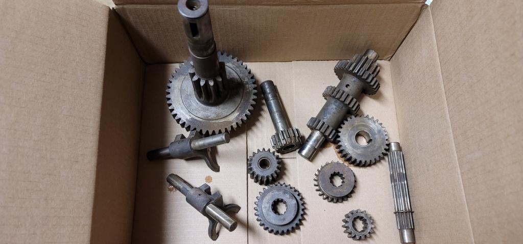

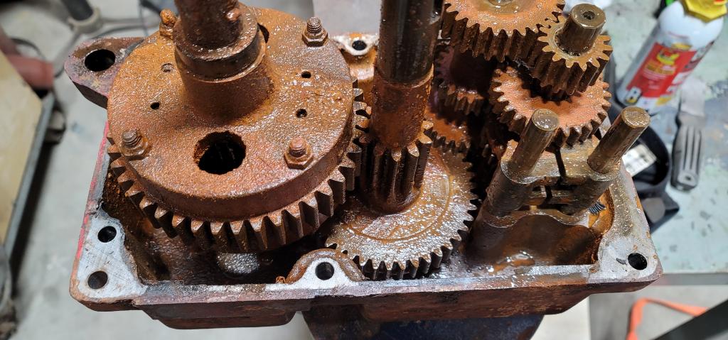

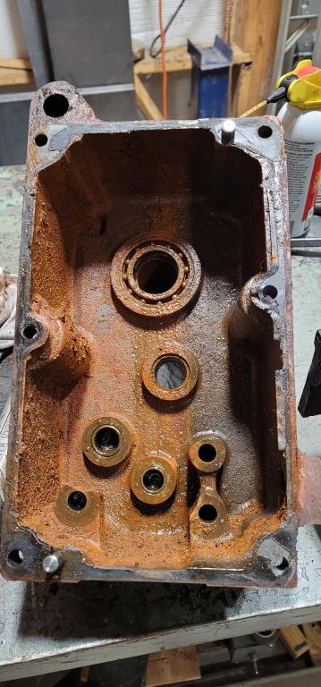

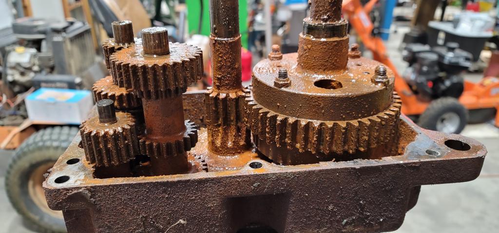

BradKahler 416 #56 Posted November 18, 2025 Today turned out to be a productive one. I had no problems getting the case split and you can see from the pictures the transmission is really grungy inside. There was no metal debris inside at all, other than the water and oil that created that grunge. I've started cleaning the parts in my ultrasonic cleaner and so far I'm really happy with the results. The first batch of parts spent about 58 minutes in the cleaner. Tomorrow I'll need to clean out the ultrasonic cleaner and then I'll run all the parts through it again. I'm not sure yet how I'm going to clean the two cases. I think they are to big to fit in the cleaner so I may end up using a pressure washer for the first pass and then figure out what to do after that. Making progress 3 Share this post Link to post Share on other sites

953 nut 70,661 #58 Posted November 19, 2025 14 minutes ago, BradKahler said: pressure washer for the first pass and then figure out what to do after that. Pressure washer and a small wire brush should do the trick. If you haven't visited Lowell's site for the parts you'll need here is a link. https://wheelhorsepartsandmore.com/product/base-kit-1-for-manual-transmission/ Your 1533 bearings ( the big ball bearings on the inner end of the axle) will probably clean up and be able to be reused, if not he sells them too. 1 1 Share this post Link to post Share on other sites

WHX?? 58,388 #63 Posted November 19, 2025 (edited) Yes call Lowell before you order. He'll be happy to answer any questions and make sure to get the right stuff. Tell him the boys from RS sent ya ... he knows most of us. I take it you got the dog point out? Welding a nut on is an excellent idea. They tend to snap right at the end of the hex but many times back right out. 1/4-20 is the thread size. I have replacements I can send you one if needed. @Racinbob and I buy them in bulk then take turns passing them out... Your tranny is in good shape as these go. I saved this one. Had rust boogers for a week but saved it. 13 hours ago, ri702bill said: Do check the condition of the 2nd / 3rd gear. Yes put up a pic we can tell you if it's any good or not. Edited November 19, 2025 by WHX?? 4 Share this post Link to post Share on other sites

BradKahler 416 #65 Posted November 19, 2025 10 minutes ago, WHX?? said: Yes call Lowell before you order. He'll be happy to answer any questions and make sure to get the right stuff. Tell him the boys from RS sent ya ... he knows most of us. I take it you got the dog point out? Welding a nut on is an excellent idea. They tend to snap right at the end of the hex but many times back right out. 1/4-20 is the thread size. I have replacements I can send you one if needed. @Racinbob and I buy them in bulk then take turns passing them out... Your tranny is in good shape as these go. I saved this one. Had rust boogers for a week but saved it. Yes put up a pic we can tell you if it's any good or not. THAT is an impressively dirty transmission I forgot to mention the dog bolt. Yes, I welded a nut on it and it the bolt spun right out. In hindsight I probably could have just used a pointed punch and spun it out. I'm not sure why it was broken when it was obviously not rusted in place. I would definitely be interested in one of your replacements I'm in the process of cleaning the ultrasonic cleaner so I can run everything through it one more time. Later today I'll tackle the cases, I may just go to the local car wash and deal with them there. Thanks! 2 Share this post Link to post Share on other sites

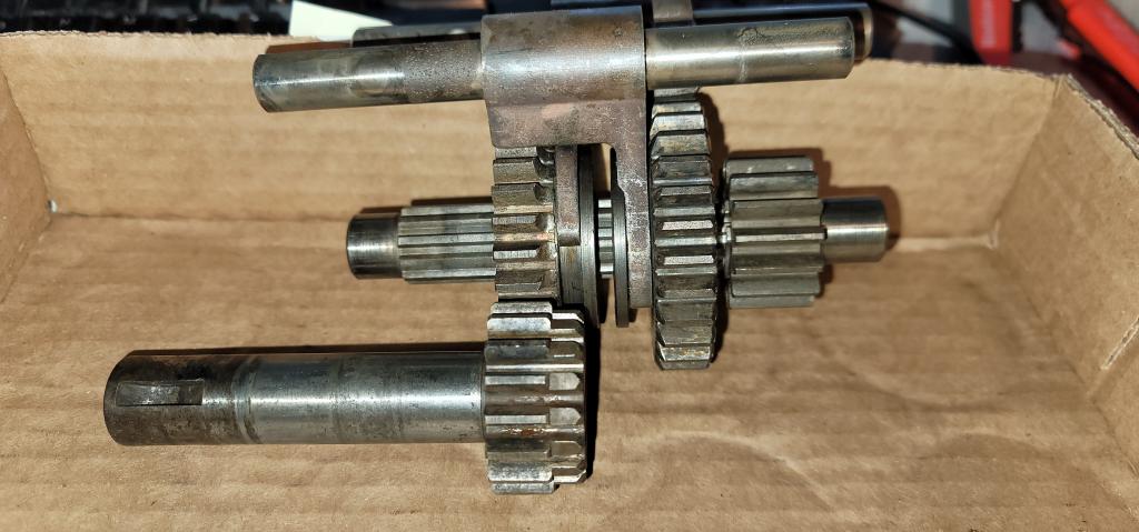

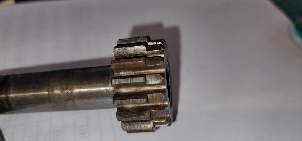

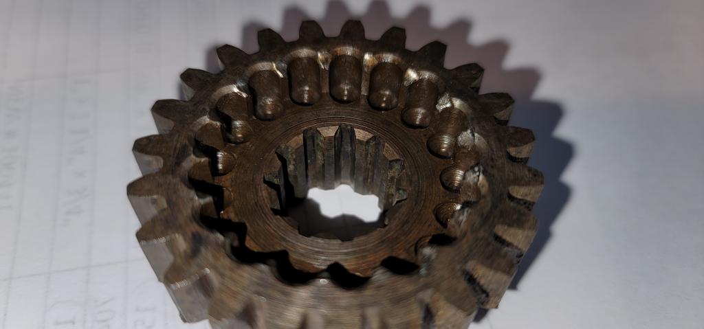

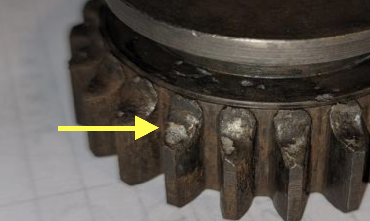

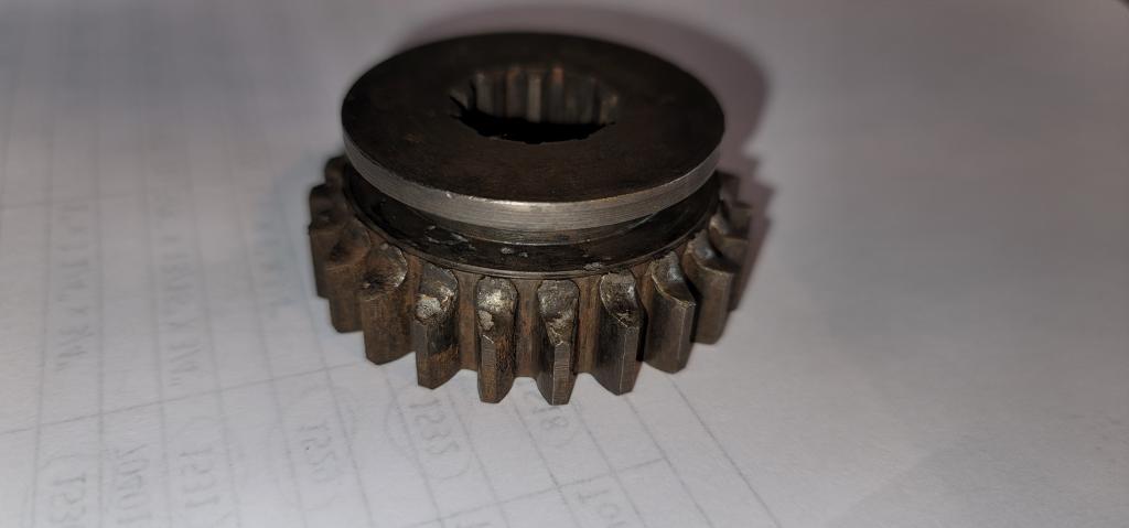

BradKahler 416 #68 Posted November 19, 2025 18 hours ago, ri702bill said: So far, so good! Do check the condition of the 2nd / 3rd gear. The third gear side has the row of drilled holes that should not show excessive wear... That is waht causes the Unidrive to jump out of high gear. New reproduction gears are available thru Lowell too. I've finished running all of the gearbox innards through the ultrasonic cleaner multiple times and they all look really good. Here's a couple of shots of the requested gear. Other than some possible slight burrs on each tooth edge I don't see anything wrong with it, but I'm not really sure what to look for on this gear. 1 Share this post Link to post Share on other sites
Handy Don 17,735 #69 Posted November 19, 2025 (edited) About ⅓ of each tooth has been ground away at the arrow. Edited November 19, 2025 by Handy Don 1 1 Share this post Link to post Share on other sites
BradKahler 416 #70 Posted November 19, 2025 3 minutes ago, Handy Don said: About ⅓ or each tooth has been ground away at the arrow. Ah, so the tooth is supposed to be full length. I thought maybe it was a feature similar to the input shaft gear. I suppose it's far enough gone that it needs to be replaced? Share this post Link to post Share on other sites
stevasaurus 23,892 #71 Posted November 19, 2025 It's the 2nd picture of post #68 that you want to look at. Those thin teeth on the inside of the gear ware out fast when shifting without comming to a complete stop. When they are worn enough, that is when the trans will pop out of 3rd gear under a load. Yours look to be in good shape. I would not replace it. Check the fit by putting the 2nd and 3rd fork gear on top of the input gear. 3 Share this post Link to post Share on other sites
BradKahler 416 #72 Posted November 19, 2025 3 hours ago, stevasaurus said: It's the 2nd picture of post #68 that you want to look at. Those thin teeth on the inside of the gear ware out fast when shifting without comming to a complete stop. When they are worn enough, that is when the trans will pop out of 3rd gear under a load. Yours look to be in good shape. I would not replace it. Check the fit by putting the 2nd and 3rd fork gear on top of the input gear. So the wear in the first picture isn't an issue? Does the attached photo show what you're referring to? 2 Share this post Link to post Share on other sites

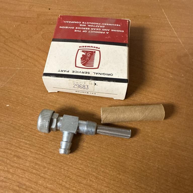

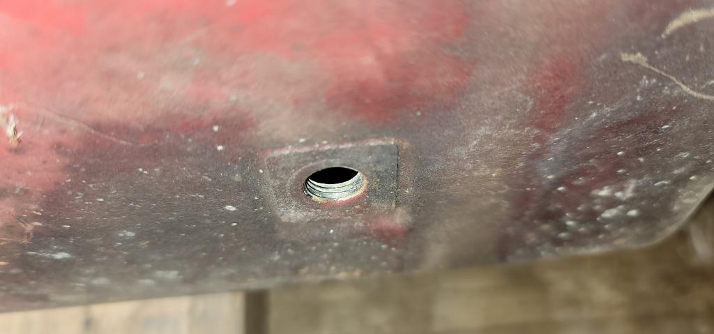

BradKahler 416 #73 Posted November 20, 2025 I have a question. The original petcock knob was missing and the shaft was frozen. I have an NOS petcock ready to install. There didn't appear to be any sort of sealant on the threads originally. Is it kosher to just thread the petcock in with no tape or sealant? Thanks Share this post Link to post Share on other sites
Handy Don 17,735 #74 Posted November 20, 2025 2 hours ago, BradKahler said: just thread the petcock in with no tape or sealant? I am very leery of tape or sealant exposed to gasoline so I don’t do it. Shredded tape or excess sealant loose in a fuel system are my concerns. There are paste and tape options that are "fuel safe”, though, so it’s up to you. 1 Share this post Link to post Share on other sites
BradKahler 416 #75 Posted November 20, 2025 1 hour ago, Handy Don said: I am very leery of tape or sealant exposed to gasoline so I don’t do it. Shredded tape or excess sealant loose in a fuel system are my concerns. There are paste and tape options that are "fuel safe”, though, so it’s up to you. Yeah, I'm not a fan of tape in this situation either, especially considering the threads on the petcock are exposed inside the tank. I do use Gasgacinch from time to time but again, the depth of the threads means the Gasgacinch will be inside the tank as well. I think I'll forgo tape or sealant and see if I get a seal the natural way. Thanks for the comment! 1 Share this post Link to post Share on other sites
