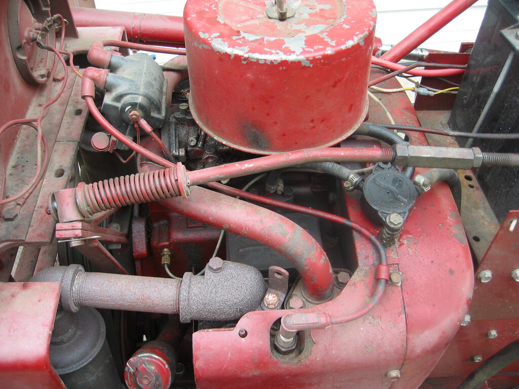

Teddy da Bear62 172 #27 Posted December 31, 2025 I have searched the parts manual, the service manual and the internet. I cannot find a photo or diagram showing the location of mechanical fuel pump on engine block. I believe it sits on top of the block, below the carbetrator and between the jugs. Can anyone with a D-200 post a photo of their fuel pump? Share this post Link to post Share on other sites

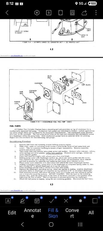

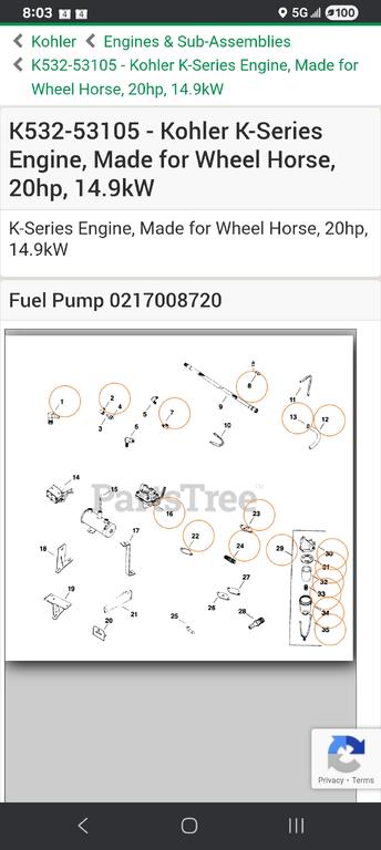

Teddy da Bear62 172 #29 Posted December 31, 2025 The illustrations from parts tree on the k532 and spec number for wheel horse. Includes diagram from service manual. They surely look mechanical to me.....sigh Share this post Link to post Share on other sites

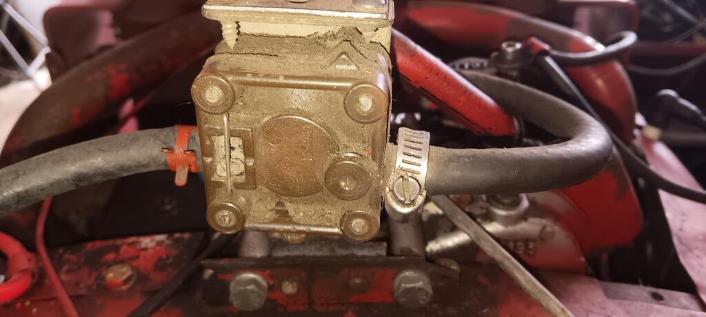

Teddy da Bear62 172 #32 Posted January 4 Vacuum fuel pump. Are you seeing what I'm seeing??? This thing looks packed with sediment!! (zoom in real close) Share this post Link to post Share on other sites

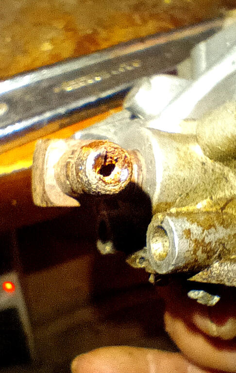

Teddy da Bear62 172 #33 Posted February 4 (edited) The old bear has had, still has pneumonia. Spent 3 hours in driveway during second snowstorm trying to open it up to go to work. 1st. storm dumped 3ft. (not a typo) in my driveway and a 4ft. drift in front of my garage doors. It was really fluffy snow and easy to get rid of next day. But still a surreal landscape. The next weeks snow was about 18" and much heavier. It came with near zero temps that nearly killed da bear. Haven't had much time to work on the D-200. But did look at inlet nipple for fuel. It was packed shut!!! Yeah, the auctioneer said it ran when they parked it for the auction. I should have asked "what year was that?" Edited February 4 by Teddy da Bear62 1 Share this post Link to post Share on other sites
