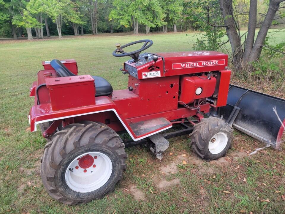

Teddy da Bear62 192 #1 Posted November 14, 2025 (edited) Ok fellow horsemen and da ladies! I recently rounded up a D-200 with a blade at auction. I have been going over it. And think I've got the booby prize.🏆 First ...can't run the numbers as there don't seem to be any. As I recall? Plate was suppose to be below steering column? It's not. It does have a single brake on left side, might indicate an early model 1974? The steering column itself needs support badly! It's wobbly. The oil was overfull and I'm really worried about that. Wrong gas tank. Wrong oil filter. Two screws missing from air cleaner backing plate (hope not mashed by cylinder or caught in valve.) Hood was carved up. It pops off, but doesn't stay running. I have not done compression test yet or checked fuel pump. Plugs were sooty (valves)(missing screw) 🥺 This will be for sale eventually as I just don't have room and was impulse buy. Edited November 14, 2025 by Teddy da Bear62 2 3 Share this post Link to post Share on other sites
pfrederi 21,342 #2 Posted November 14, 2025 Based on the forked motion control plate with out a cover on the lower fork and the parking brake under the instrument panel (just like my D200) I would say yours was model 1-0630 from 1974 Engine spec would have been 53105 1 1 Share this post Link to post Share on other sites

JoeM 10,318 #4 Posted November 14, 2025 Just looking at the good. OE mufflers, rare find Nice Wide plow, desirable Tires look fairly new Part of a three point peeking out the back, another nice find. And I am really digging those ammo box arm rests. just plain cool I think the first thing if you are taking the carb off is to fish around in the intake manifold for those missing screws. might surprise you and take off after a little TLC 2 Share this post Link to post Share on other sites

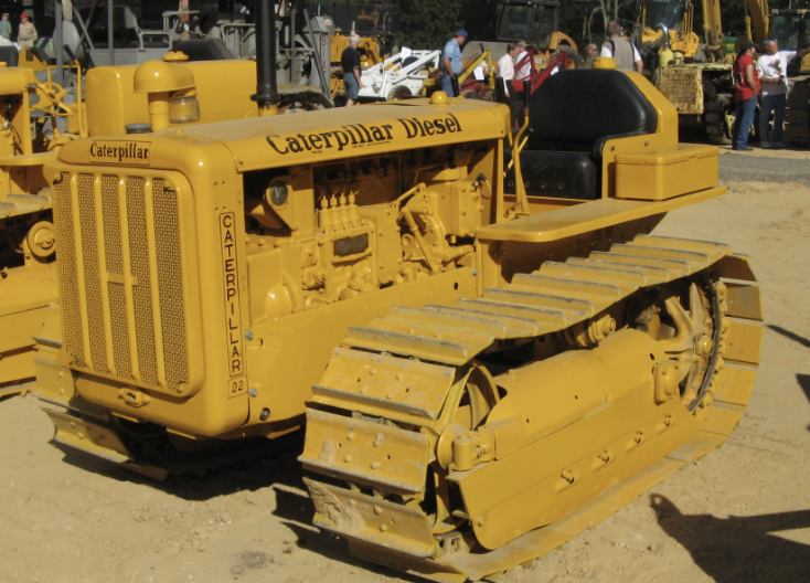

Handy Don 17,735 #6 Posted November 15, 2025 17 hours ago, JoeM said: And I am really digging those ammo box arm rests. just plain cool The boxes remind me of the only Caterpillar dozer I ever got to operate. It was from the 40’s and resembled this one: 2 Share this post Link to post Share on other sites

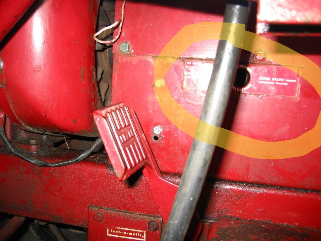

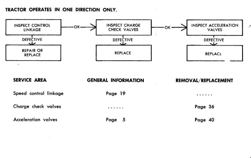

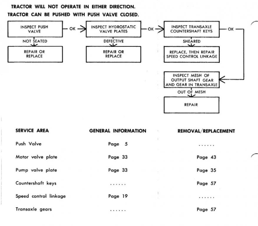

Teddy da Bear62 192 #7 Posted November 16, 2025 (edited) I say ammo boxes on the fenders and tripod on the hood for my B.A.R. and I'm ready for the unruly neighbors. Or zombie apocalypse, whichever comes first (sometimes they are one and the same) 🤣 1. Hey 1974 D-200 experts! Is there a tow valve on this model? Rolls easily in reverse. It will NOT roll forward even in what seems like neutral (shifter). 2. There is a hole above brake pedal. With a label (painted over of course). Flashlight told me there is a small screw head inside the hole. What does it do? 3. Seems PTO handle and all that goes with it down to the front pulley is missing. I'm going to need a parts list. And since hundreds of you have junk D's just lying around? Finding used parts should be no problem! Right? Right? *crickets* Edited November 16, 2025 by Teddy da Bear62 Share this post Link to post Share on other sites

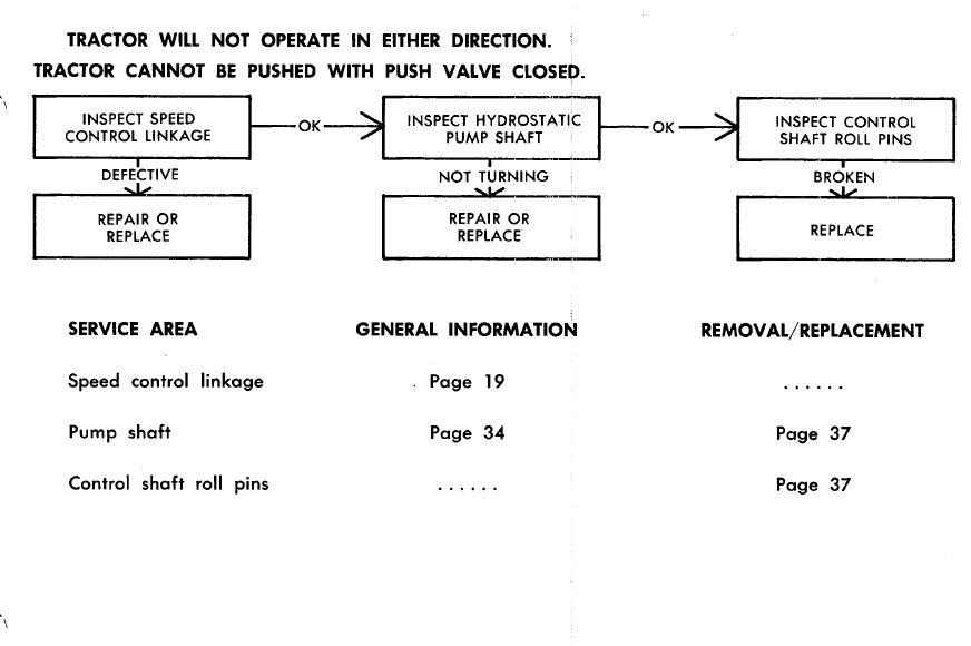

pfrederi 21,342 #8 Posted November 17, 2025 It is tow valve. To really diagnose have to get it to work. Clockwise to tight closed she should not roll counter clockwise a turn she should roil. Dumb move by Sunstrand they used a straight slot for the valve you use a straight blade screw diver. if it is frozen you will probably shear the head off the valve. Soak it for a few days with penetration stuff. On C series horses you can access the valve and use vice grips/pipe wrench to break it free on the D series serious disassembly is required to access it. I have often said when wheel horse built a D series it started with a guy holding the hydro pump in the air while the rest of the crew assembled the tractor around it. Share this post Link to post Share on other sites
Teddy da Bear62 192 #9 Posted November 19, 2025 (edited) On 11/17/2025 at 8:43 AM, pfrederi said: It is tow valve. To really diagnose have to get it to work. Clockwise to tight closed she should not roll counter clockwise a turn she should roil. Dumb move by Sunstrand they used a straight slot for the valve you use a straight blade screw diver. if it is frozen you will probably shear the head off the valve. Soak it for a few days with penetration stuff. On C series horses you can access the valve and use vice grips/pipe wrench to break it free on the D series serious disassembly is required to access it. I have often said when wheel horse built a D series it started with a guy holding the hydro pump in the air while the rest of the crew assembled the tractor around it. That is a tiny screw head for such a large tractor tow valve! 🤣🤣🤣 When I saw your photo. My label was below the hole. Also reminds me. I need D series mid tach-o-matic too. God what they didn't steal off this tractor! Edited November 19, 2025 by Teddy da Bear62 Share this post Link to post Share on other sites

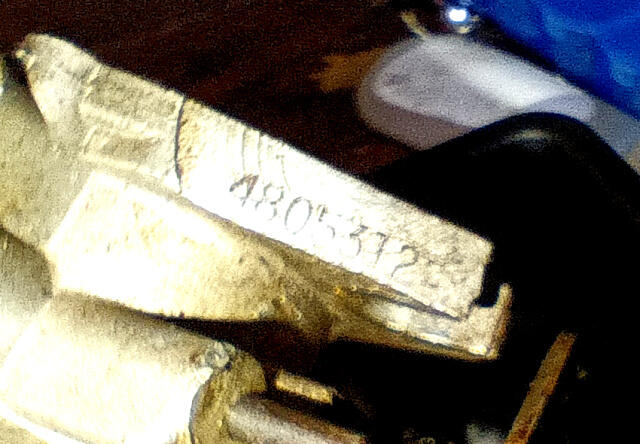

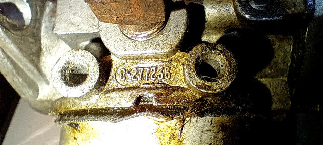

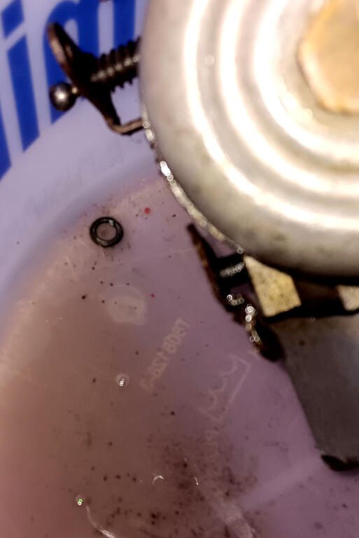

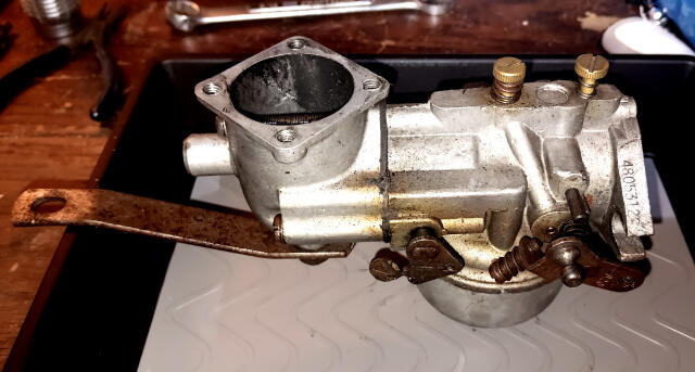

Teddy da Bear62 192 #10 Posted December 18, 2025 (edited) Ok got the carbetrator off. Don't have much time to mess with it before work But this little item flew out of the throttle intake. Is that a gasket from a seat????? Kind of looks like it. Doesn't seem possible. This is a first for da Bear. (The particles you see may have already been in the container.) I will try and get a better photo later. I edited this post earlier.....apparently it didn't stick!....lol Edited December 19, 2025 by Teddy da Bear62 Share this post Link to post Share on other sites
Teddy da Bear62 192 #11 Posted December 21, 2025 Been doing some reading on this o ring/seat. It seems some carbetrators do not use a brass seat. And rely on this o ring/seat to seal off needle. More investigation and learning ahead. The more I think I know, the more I prove I don't! 🤣🤣🤣 Don't jump on me if I make a mistake. But hopefully I will learn from them. More to follow. Share this post Link to post Share on other sites

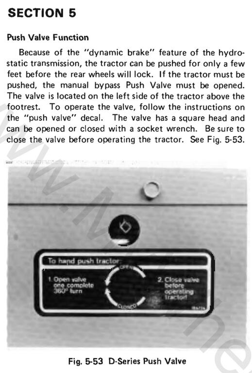

Teddy da Bear62 192 #13 Posted December 21, 2025 I have been reading about the tow valve in the pdf manual. It should be a "square" similar to the one I post in photo below. However, mine is not! Mine appears to be a standard slotted screw. Is this an indication of someone in the past unable to open tow valve and shearing off the "square"?? Share this post Link to post Share on other sites

pfrederi 21,342 #16 Posted December 21, 2025 1 hour ago, Teddy da Bear62 said: I have been reading about the tow valve in the pdf manual. It should be a "square" similar to the one I post in photo below. However, mine is not! Mine appears to be a standard slotted screw. Is this an indication of someone in the past unable to open tow valve and shearing off the "square"?? My 1974 D200 has the slot head tow valve. Share this post Link to post Share on other sites
Teddy da Bear62 192 #17 Posted December 21, 2025 19 hours ago, pfrederi said: My 1974 D200 has the slot head tow valve. Interestesting! 🤔 I would think they would make note of it in the manual if 74 models are different than other production years. Share this post Link to post Share on other sites

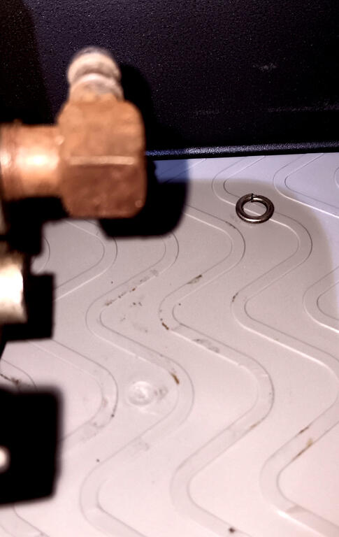

Teddy da Bear62 192 #18 Posted December 26, 2025 (edited) Ok wheel horse fans...... Another small update. I really feel I stepped in the horse sh*t (wheel horse sh*t of course). I got a good look at the piece that fell out of the carbetrator. It's actually a lock washer. And not a seat as earlier suspected. But it's a size that fits no where in the carb. And they didn't use them on carb to begin with. I learned from reading Kohler service manual that this carb was used on k482 & k582. I located part number on carbetrator. #4805312 and looks like a "C" at the end (mounting flange edge). But I also came up with another number on the other side. Just above the bowl there is C 277236. Not sure if it's important or not? I looked down the throat of the carb. It has 2 butterflies. The second one in the middle is nearly ripped off the shaft it's mounted to! And I'm sure only one screw holding it on. 😭 I'm going to begin disassembly and cleaning. I have several photos to include here. I also would like to ask any D-200 owners/experts. I found paper labels on one side of the engine, on a tin. Is that the only place this engine is stamped/labeled?? Because as others, it is painted over. Unreadable if I ever needed serial and spec numbers. I also understand the k482 & k532 are identical except for bore size and stroke. Given this has short gas tank, someone tore off tractor identification tag..... And then painted over an important engine i.d. label???? I've got a wild suspicion that someone has disguised a D-180 as a D-200??? There are more horrors I have found. But that will wait until later. I'm going to take a long walk off of a short pier now. Edited December 26, 2025 by Teddy da Bear62 Share this post Link to post Share on other sites
8ntruck 9,420 #19 Posted December 26, 2025 That first butterfly you see in the carb is the choke - it blocks off some air flow to create a ritch fuel mix for starting the engine. The second butterfly is the throttle plate that controls the engine speed. You are going to get that one corrected before you try to start the engine. 1 Share this post Link to post Share on other sites

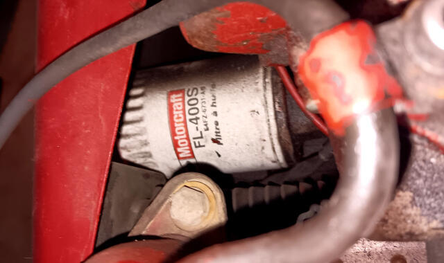

pfrederi 21,342 #20 Posted December 26, 2025 Oil Filters were not included on D-180. If you have turning brakes and rear PTO they were standard on D200 optional on others. WH used same spec number for D200 in all years 53105A Share this post Link to post Share on other sites
Teddy da Bear62 192 #21 Posted December 26, 2025 (edited) 1 hour ago, pfrederi said: Oil Filters were not included on D-180. If you have turning brakes and rear PTO they were standard on D200 optional on others. WH used same spec number for D200 in all years 53105A Thank you pfederi! That calms my imagination. 🤣 I definitely have a FORD engine, because they used a Motorcraft oil filter ! Logical? Not! Unfortunately, no rear PTO output shaft. I won't be able to run my D tiller on it. No turning brakes. One pedal on left side (when sitting on tractor) Not sure if the 1974 had a single brake and the rest of the years included them? I know my previous D-200 had them. Edited December 26, 2025 by Teddy da Bear62 Share this post Link to post Share on other sites
Teddy da Bear62 192 #22 Posted December 26, 2025 9 hours ago, 8ntruck said: That first butterfly you see in the carb is the choke - it blocks off some air flow to create a ritch fuel mix for starting the engine. The second butterfly is the throttle plate that controls the engine speed. You are going to get that one corrected before you try to start the engine. I have to get another #4 brass screw to remount the plate as one screw did not survive my "bear claw" force....lol Share this post Link to post Share on other sites

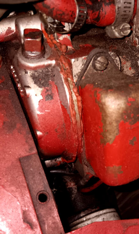

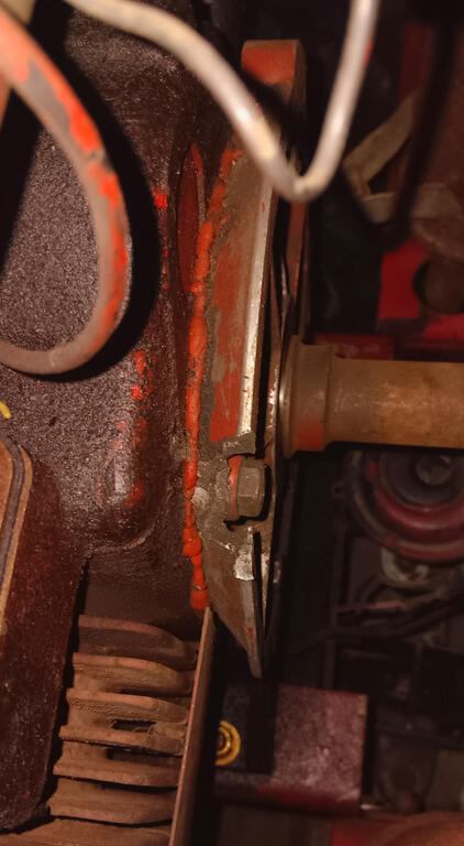

Teddy da Bear62 192 #23 Posted December 26, 2025 Ok, guess I will open the next can of worms before finishing the carb. This is some more of the horors I found. Globs! And I mean Globs of sealant front and back of the engine!! Someone was in the crankcase. Now I don't know if the used old gaskets? Didn't bother with gaskets? But they sure globbed on the sealant!!! 😭 I highly suspect the way some idiot cobbled and stole from this tractor? I'm worried there are globs of sealant INSIDE the crankcase or soon will be. If he did not use gaskets? Big problem! Not only are they used to seal. They are also used as shims to eliminate end play in the shaft. This could destroy engine (if it hasn't already). Second photo also shows how someone broke the bearing plate around mounting hole. Too much f*ckery going on.... 🤬 Share this post Link to post Share on other sites
pfrederi 21,342 #24 Posted December 26, 2025 I hope the RTV mechanic didn't work on the hydro. RTV and hydros do NOT do well together. Share this post Link to post Share on other sites

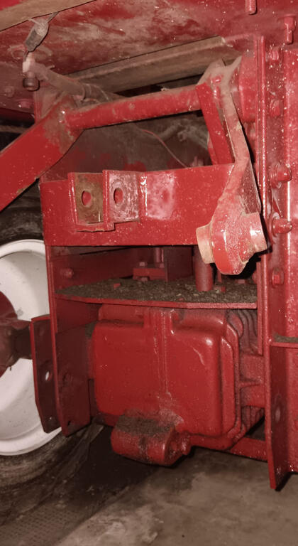

Teddy da Bear62 192 #25 Posted December 26, 2025 (edited) 10 hours ago, pfrederi said: I hope the RTV mechanic didn't work on the hydro. RTV and hydros do NOT do well together. I'm still trying to identify parts on this tractor. If someone added a vacuum fuel pump? Where is the port for the mechanical one? And what is that large cylindrical object on top of engine? I refer to the photo above the points cover is attached to. I even see an N.P.T. pipe plug in it. I HAVE JUST LEARNED IT IS A COMPLEX EXTERNAL GOVERNOR..... I need an illustrated parts diagram. Edited December 27, 2025 by Teddy da Bear62 Share this post Link to post Share on other sites
