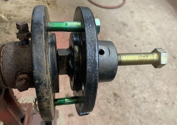

oliver2-44 11,137 #2 Posted November 13, 2025 Removing Wheel Horse rear hubs is one of the more challenging task on these tractors. 1st. Do not use a 3 jaw puller on the outer flanges of the hub You will break them. Remove the square head bolt that locks the hub to the shaft. Starting soaking it with a good penetrant like Kroil for several days. Here's a thread with several hub pullers shown. The key is to use a puller that goes behind the hub and pulls as close to the shaft as possible. 2 2 1 Share this post Link to post Share on other sites

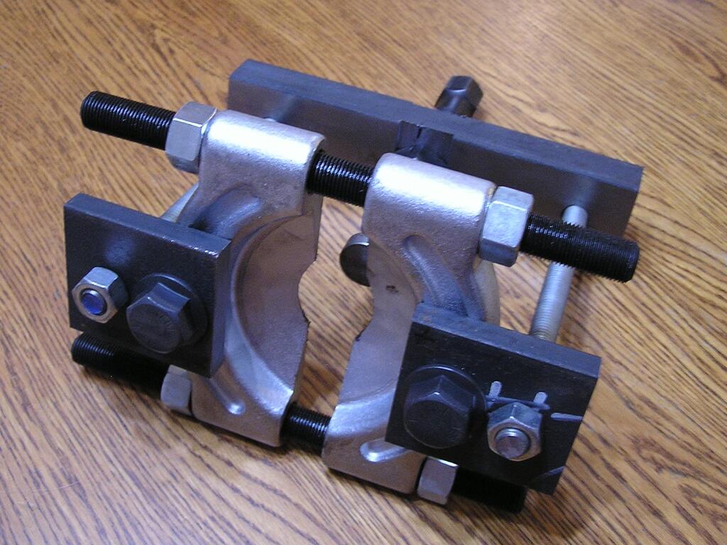

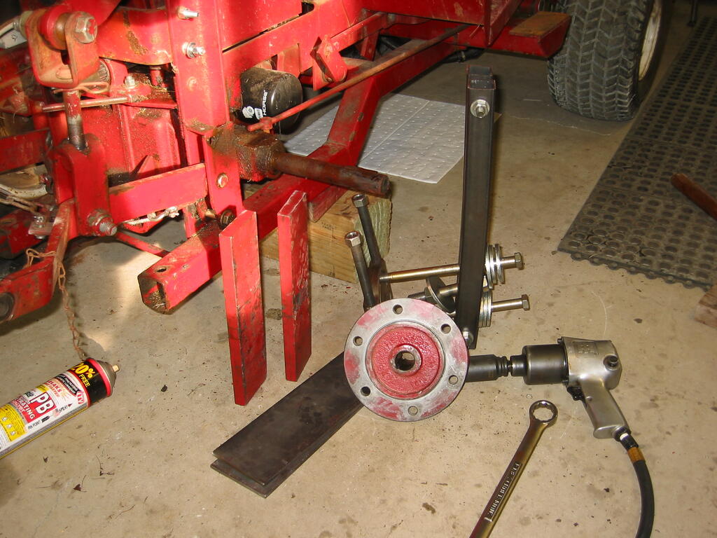

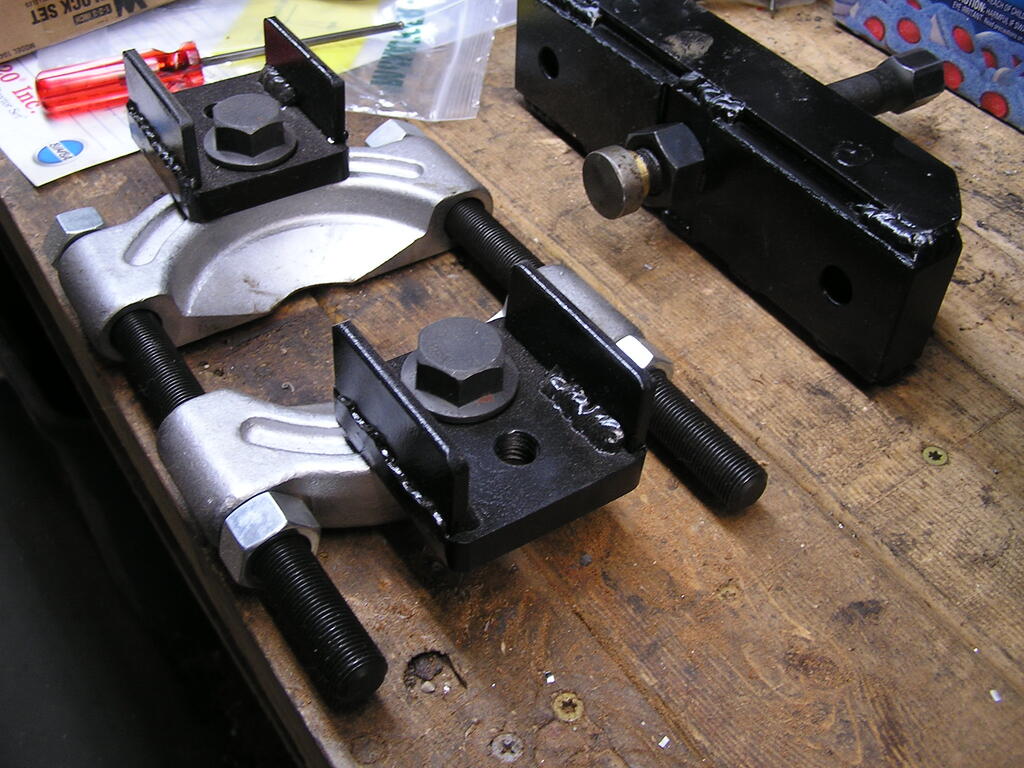

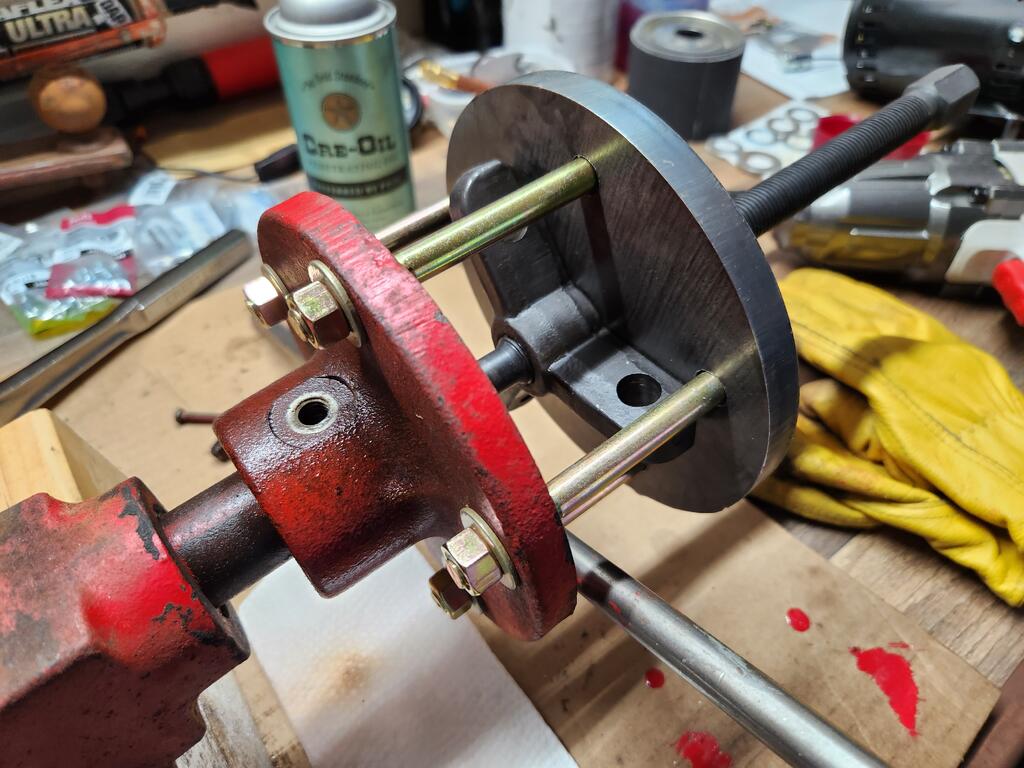

ri702bill 10,954 #5 Posted November 13, 2025 (edited) I made this one for pulling C series hubs. Still did not budge the one I had to split the case on..... Edited November 13, 2025 by ri702bill 4 1 Share this post Link to post Share on other sites

JoeM 9,389 #8 Posted November 13, 2025 I have set a map gas torch on the floor pointed at the hub for ten minutes or so with the puller in place snugging it and giving the head of the puller bolt a love tap. Your changing the seal anyway so the heat is not an issue there. I use an old hub that I drilled out the threat to allow the 7/16 bolts to pass through. 4 1 Share this post Link to post Share on other sites

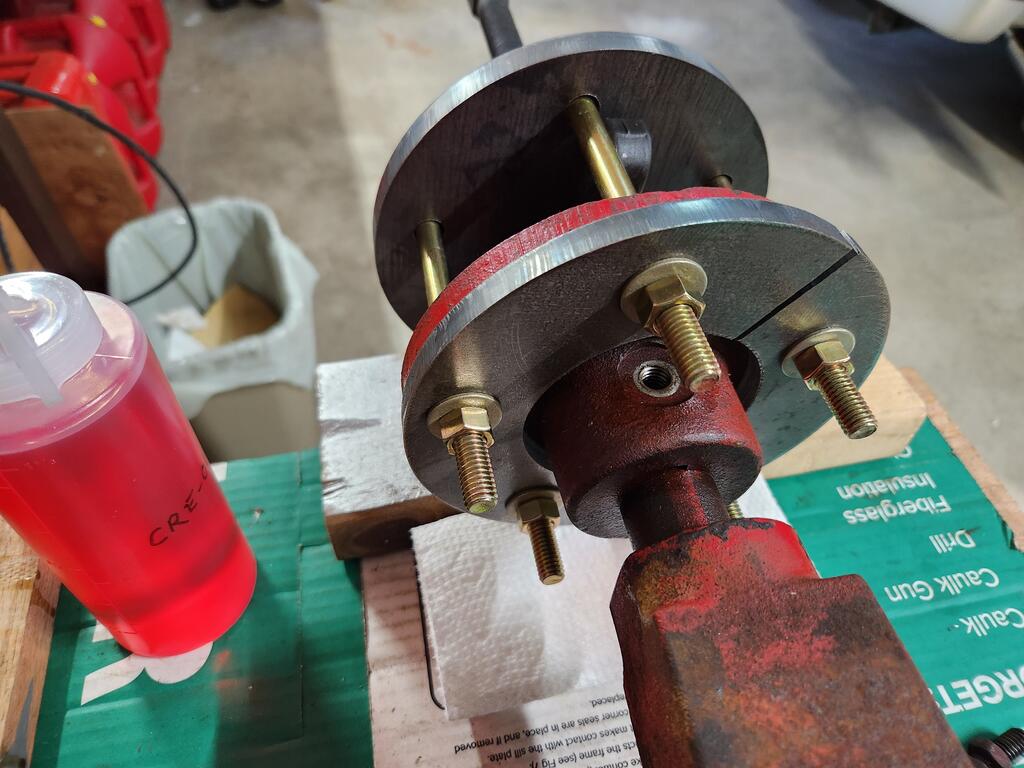

Racinbob 12,503 #17 Posted November 14, 2025 Here's the puller I made up when Dino was fighting me. I should have done this decades ago. Initially I just ran the bolts through the stuck hub. I was putting so much force into it that I got a bit worried about it so I made up a backer plate to disperse the pressure even more. After many days of keeping pressure on it and soaking it finally came off. I've got a third plate to make a backer that will go behind the entire hub which could come in handy but if the hub is too tight to the transmission case it wouldn't work. That would be a better choice on 3 hole hubs and the lighter 5 hole. 1 4 Share this post Link to post Share on other sites
