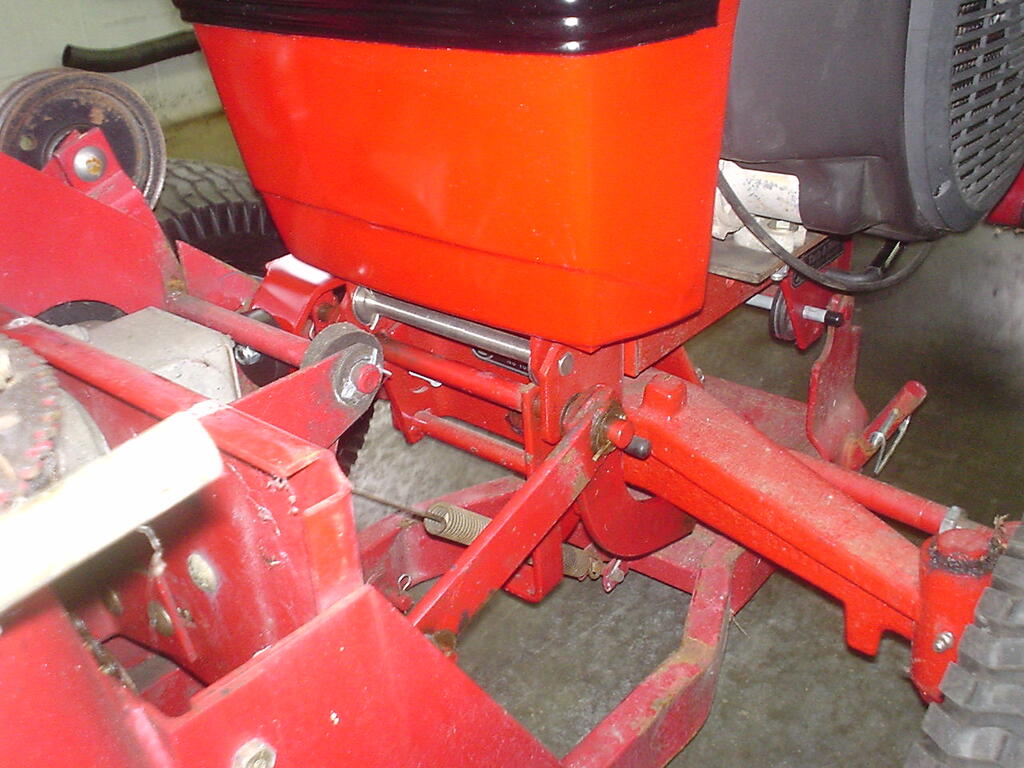

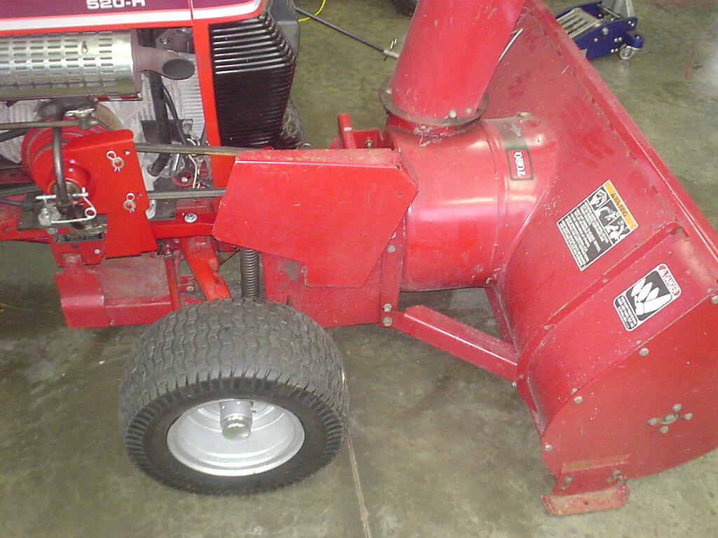

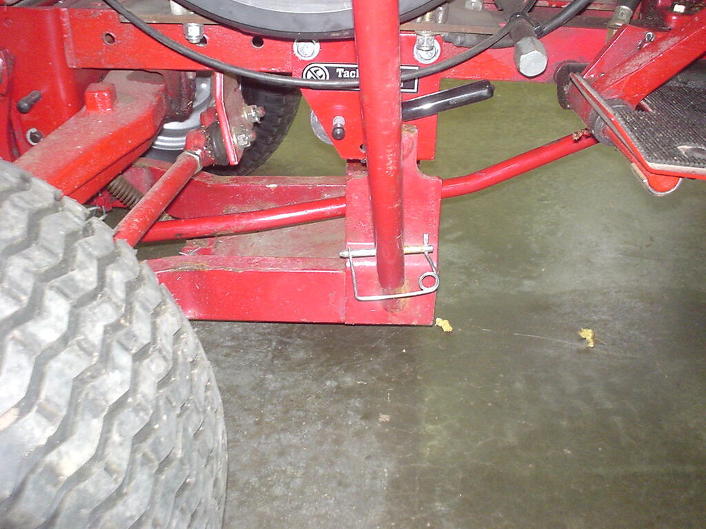

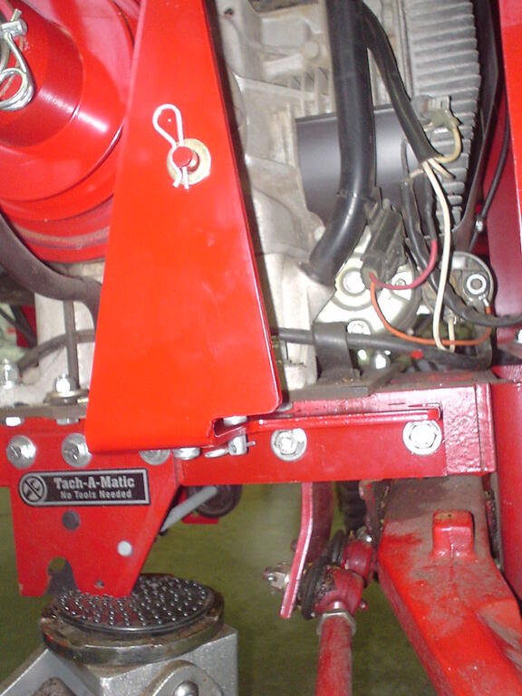

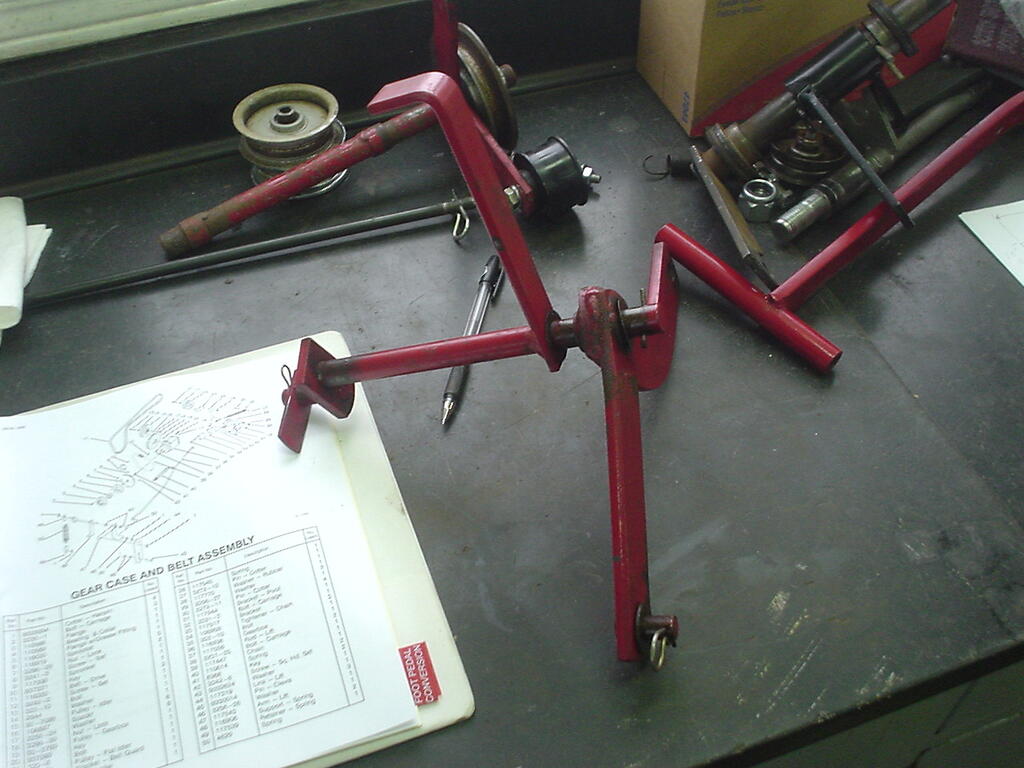

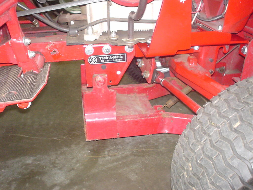

Zlane1412 0 #1 Posted November 13, 2025 Hello guys I’m new to the forms recently got a 2 stage blower for a killer deal only downside is it’s missing the lift system after searching close to me in central Michigan can’t seem to find any anyone close have one or dos anybody have pictures of one so I can make one? Share this post Link to post Share on other sites

gwest_ca-(File Mod) 12,097 #3 Posted November 13, 2025 Welcome to Red Square. The illustrated parts lists or operator manual may help. Any model and serial number? What model of tractor is it going on? 1 Share this post Link to post Share on other sites
Achto 31,428 #4 Posted November 13, 2025 Find the model number for your blower, then find the manual for your blower so that you know what parts you will need. https://www.wheelhorseforum.com/files/category/28-snow-blowers/ This vendor makes some of the lift parts for blowers. https://wheelhorsepartsandmore.com/product-category/snow-blower-plows/ Share this post Link to post Share on other sites

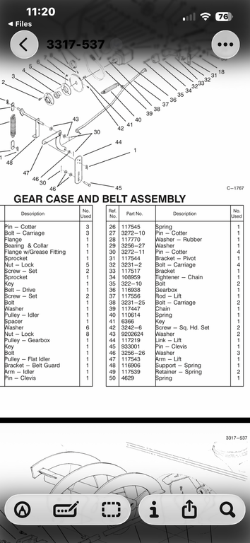

Zlane1412 0 #5 Posted November 13, 2025 I have the owners manual download I believe the lift rod is 47 and the piece that attaches in place of the mule drive is 37 could have them flipped Share this post Link to post Share on other sites

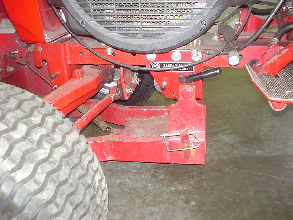

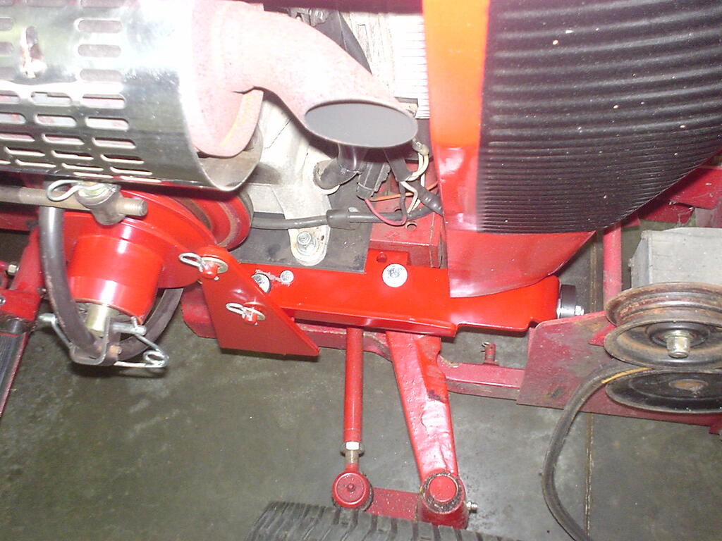

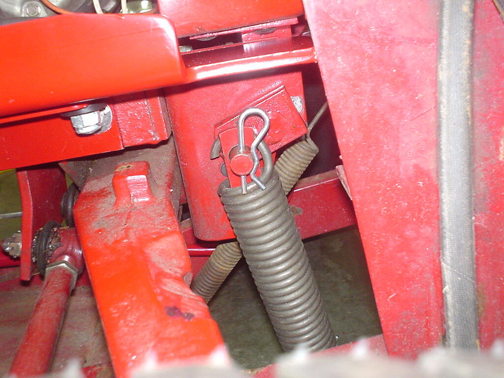

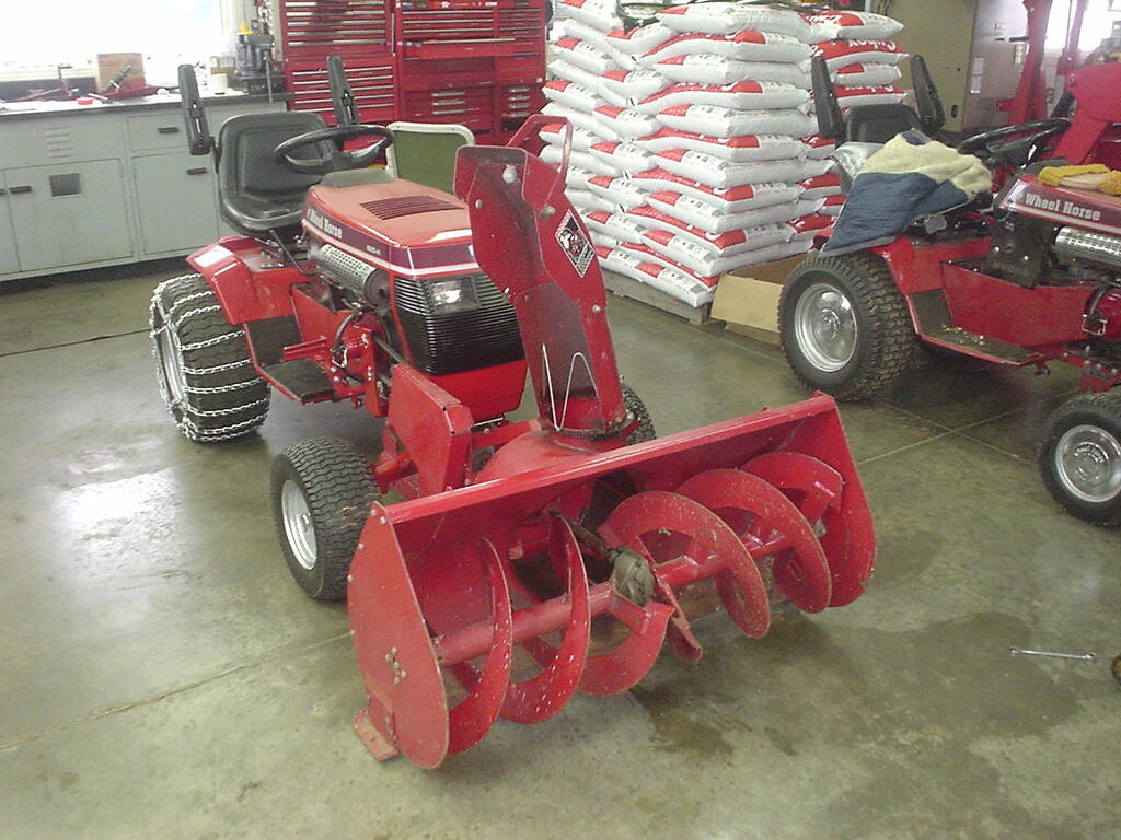

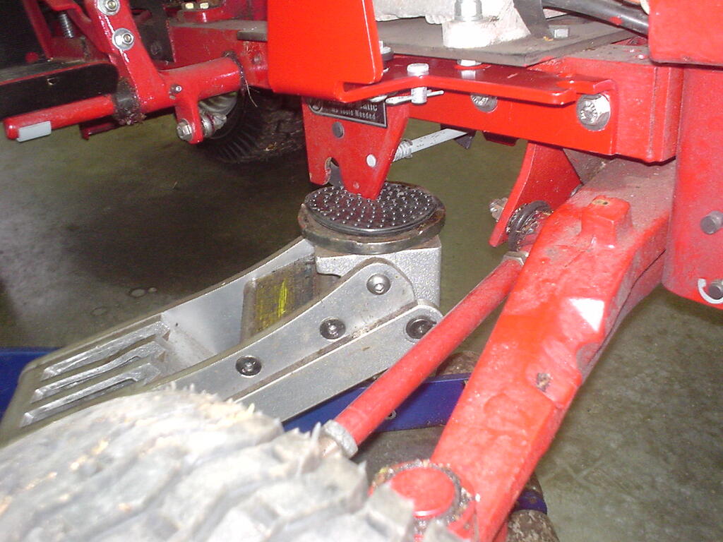

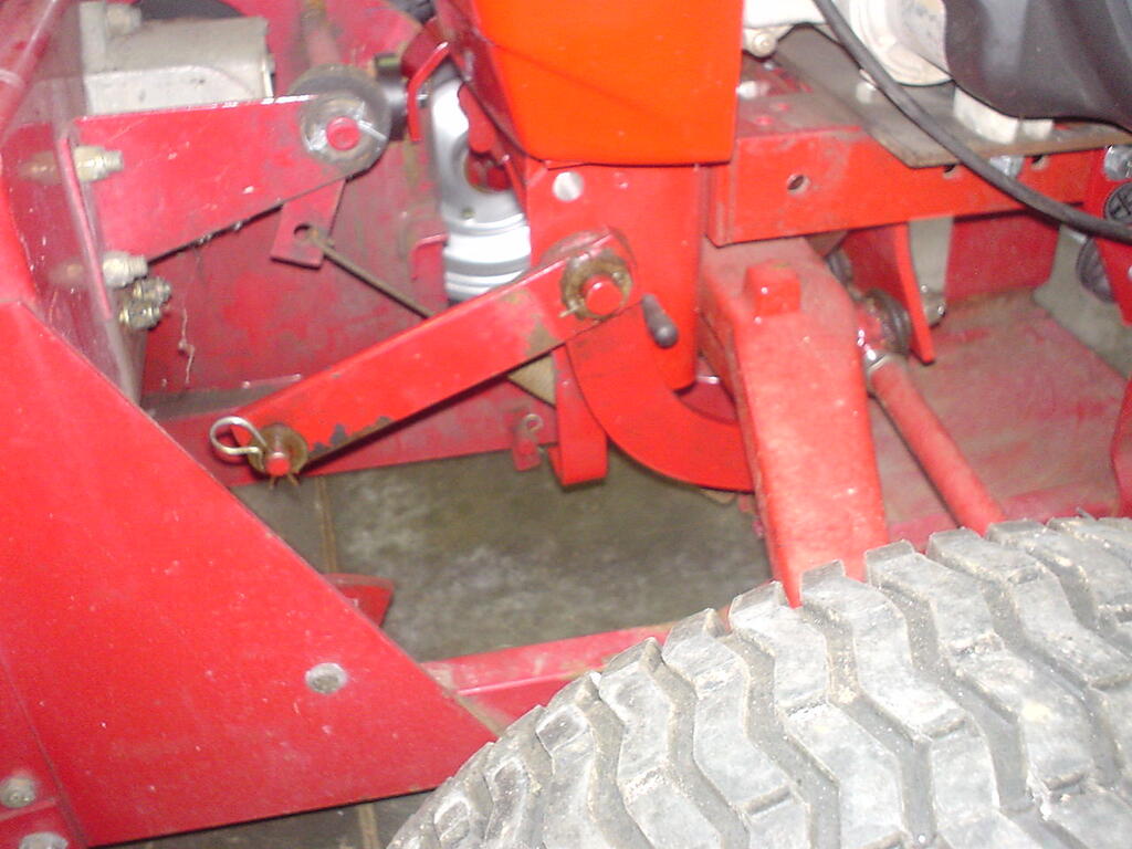

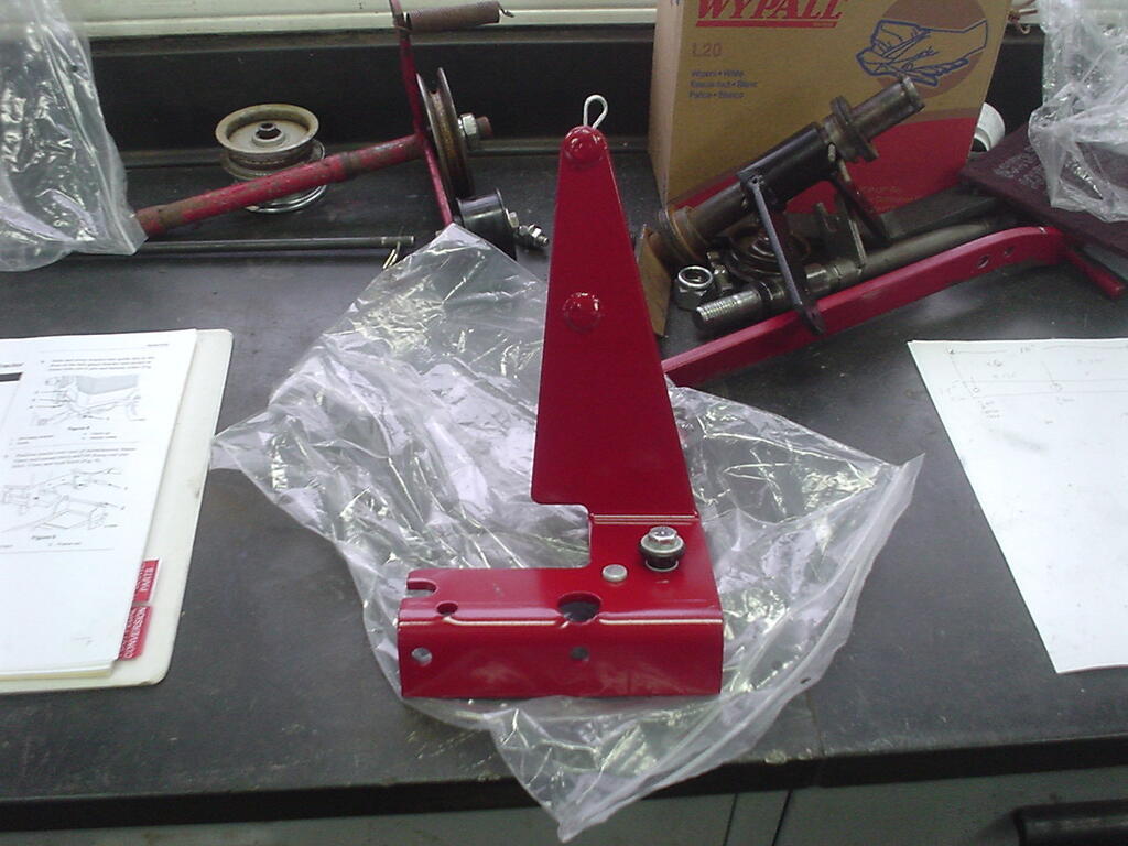

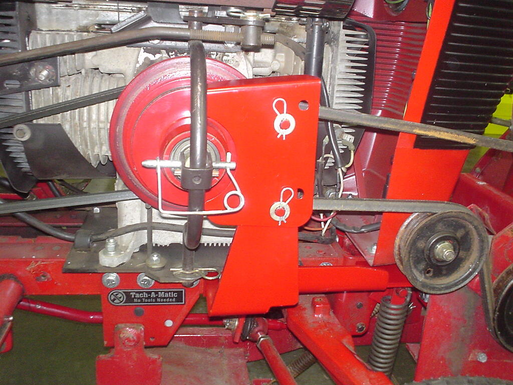

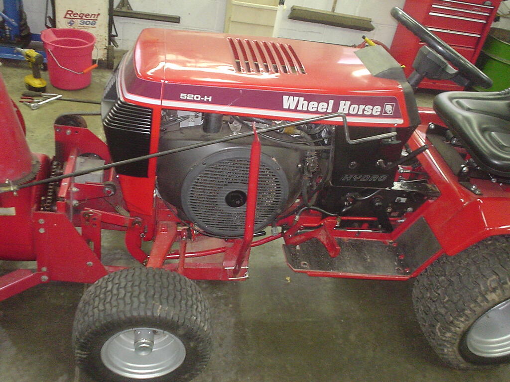

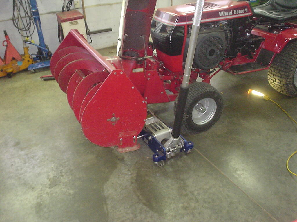

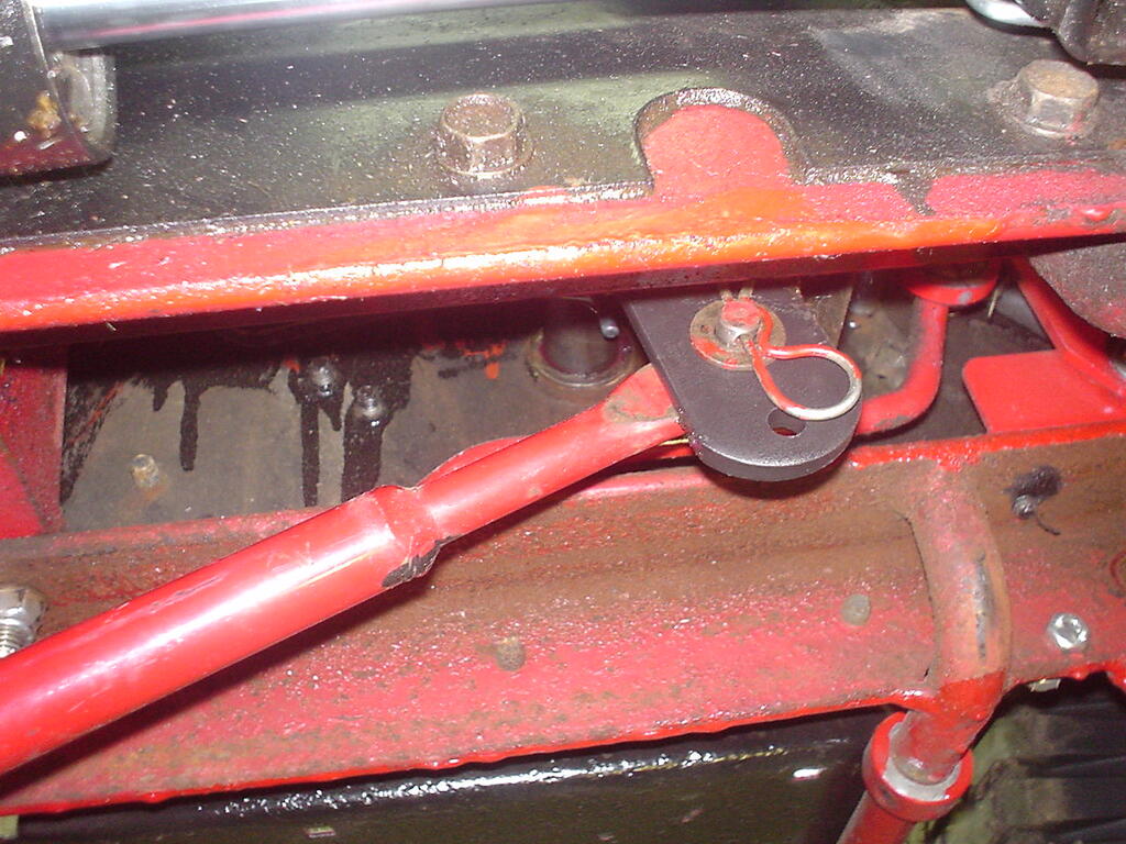

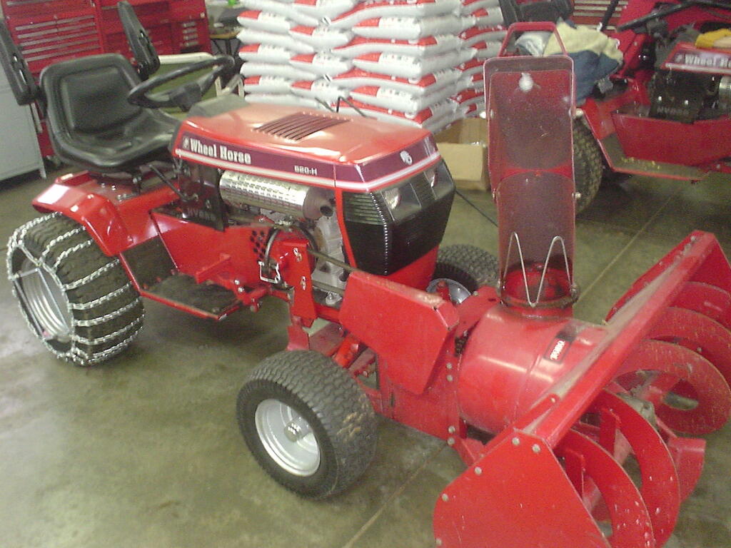

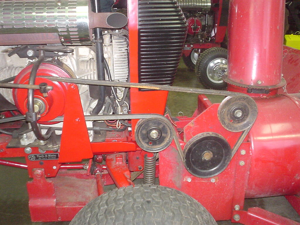

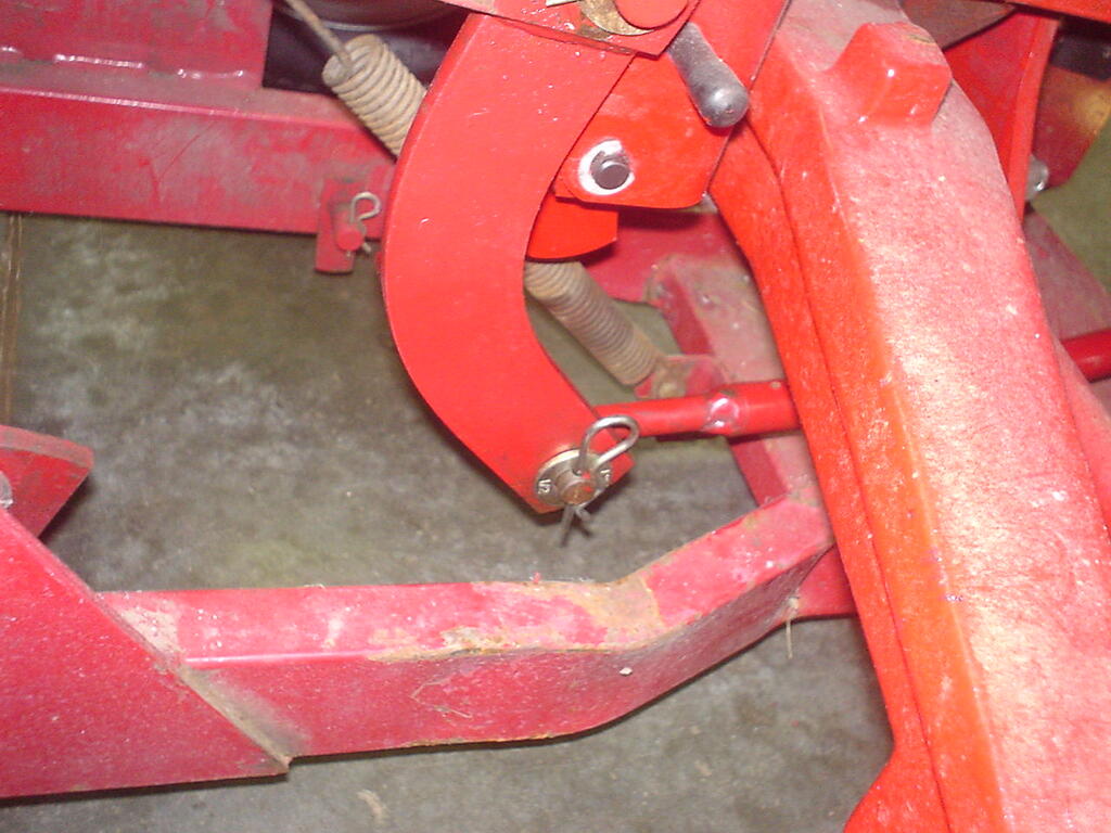

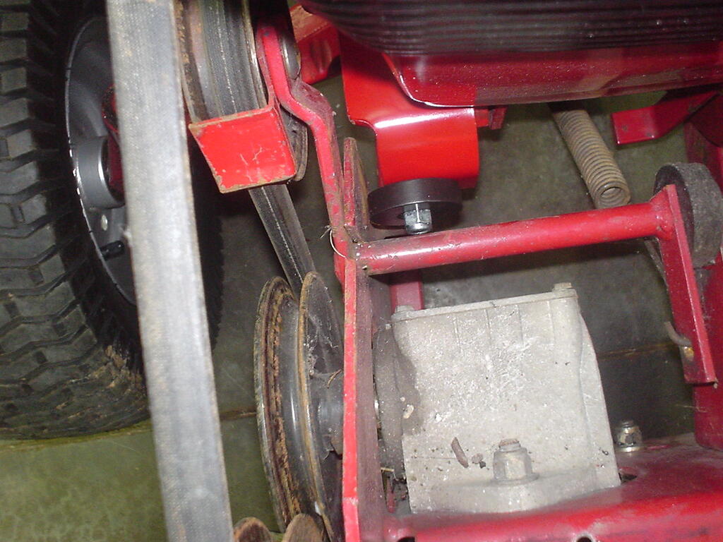

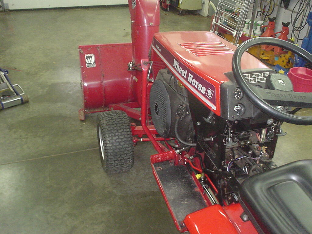

cleat 8,884 #7 Posted November 14, 2025 (edited) Here are some pictures of a two stage being installed on my 520HC I took several years ago. You will see all the lift, drive, and sway control components requires and how they are installed. Edited November 14, 2025 by cleat Share this post Link to post Share on other sites
