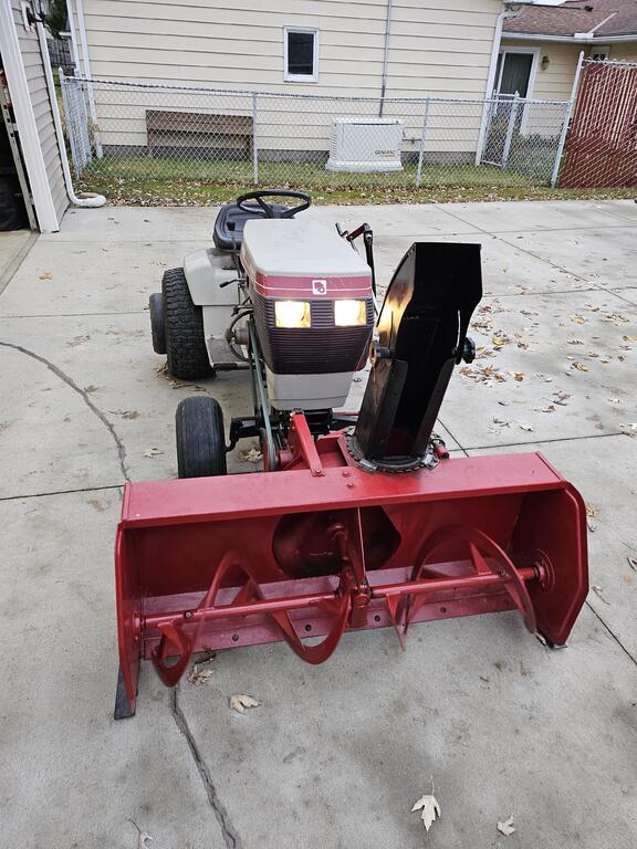

Ed Kennell 45,524 #7 Posted November 12, 2025 A couple pics of the Ber Vac on my 520H. 2 Share this post Link to post Share on other sites
