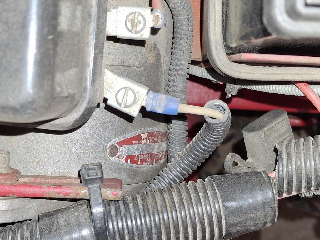

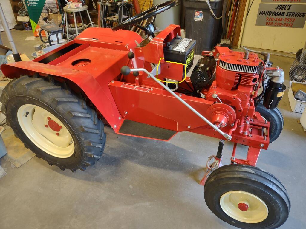

Achto 32,963 #2 Posted November 10, 2025 (edited) I'm not at home to take measurements but here are some pics for you to reference. Could it be that your belt is too long ? Edited November 10, 2025 by Achto 2 1 Share this post Link to post Share on other sites
squonk 48,427 #3 Posted November 10, 2025 (edited) The box side dimension is 5" There is about 3/4" of clearance between the box edge and the regulator with the proper belt on my 953 Edited November 10, 2025 by squonk 2 1 Share this post Link to post Share on other sites
