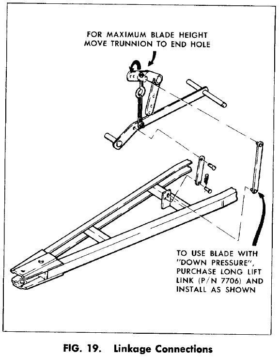

eo1bart 52 #1 Posted November 10, 2025 I'm installing a snow plow on my 312-8 and want to use the long link connector for down pressure. Question, do I use the short link also with this? Share this post Link to post Share on other sites
squonk 47,886 #2 Posted November 10, 2025 No to he short link 1 Share this post Link to post Share on other sites
gwest_ca-(File Mod) 12,450 #3 Posted November 10, 2025 No. Use one or the other. You may find the mower lift bar that the short link goes be removed for added clearance. 1 1 Share this post Link to post Share on other sites
eo1bart 52 #4 Posted November 10, 2025 1 hour ago, gwest_ca said: No. Use one or the other. You may find the mower lift bar that the short link goes be removed for added clearance. Got it Thanks! Share this post Link to post Share on other sites
ri702bill 12,795 #5 Posted November 10, 2025 1 hour ago, gwest_ca said: No. Use one or the other. You may find the mower lift bar that the short link goes be removed for added clearance. Easy ro remove - or zip tie it up out of the way. I go for option #1 myself. 1 Share this post Link to post Share on other sites
