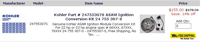

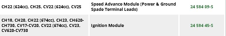

JoeM 10,316 #7 Posted November 10, 2025 Before we throw the baby out with the bath water, the CH engines have had head gasket problems. A good place to start on this is a compression test. A good number for these engines is 150-200 PSI. I have had them run ok in the 130 range. but lacked some power. Question is the plug oil fouled or fuel fouled. Assuming it is fuel fouled is the better of the two. Since you are pulling the motor, check the intake manifold bolts. I have seen those loose. Also a good Idea would be to change the rear seal. Gap on the coils .011-.013 Part numbers If you find out the advance spark system is bad this is a fix. (I have eliminated the advance and just wired in standard coils with success) 1 2 Share this post Link to post Share on other sites
