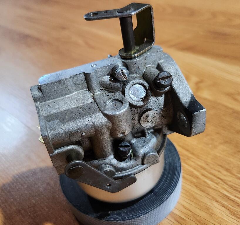

Retired Wrencher 6,448 #5 Posted November 9, 2025 (edited) 4 hours ago, gwest_ca said: I believe there is a page in this manual that addresses settings. This manual is best viewed from a printed version because some of the charts span 2 pages wide. When just viewing it it is hard to tell if you are looking at a left or right page. I have another Carb that has no name on it would that be a Kohler carb. I just never took the time to know who made what. I will take a picture of it tomorrow . Edited November 9, 2025 by Retired Wrencher Share this post Link to post Share on other sites

Retired Wrencher 6,448 #8 Posted November 9, 2025 (edited) 1 hour ago, Racinbob said: They exist Dan. The first (and only) one I delt with was on the M14 314-H. Remember the thread I did about that thing giving me fits. Turned out it wasn't even fuel related. That looks like the carb I have from Badman. This will be going on the 1057 when done. Thanks for the pick @Racinbob. It looks like brand new can send you a picture of it today. Edited November 9, 2025 by Retired Wrencher Share this post Link to post Share on other sites
peter lena 9,763 #9 Posted November 9, 2025 @Racinbob bought a walborough , carb years ago from I SAVE TRACTORS , have never touched it , for any issues , was skeptical before ordering it , did pre fill it with fuel , been very solid / reliable , also have one on my generator , no issues , both have filters before the carb . and at fuel tank , pete Share this post Link to post Share on other sites
