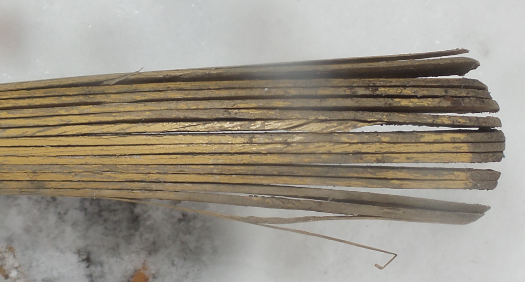

This is the handle of my garden rake made of laminated wood scraps. Least they could have done was use water proof glue.

There really is no water “proof” glue. There is water resistant glue which is what they used. The best glue there is for exterior or marine applications is Resorcinol which is urea formaldehyde. I have used in submerged applications and still holding. It is however expensive and difficult to apply having to be precisely mixed. One has to be a bit of a laboratory chemist to have full success with it. It would not be practical or economical to use it on a rake handle . The cost of the glue would exceed the cost of the rake. On handles like that one has to avoid letting handle in the rain absorbing moisture through end grain. Sometimes I actually make a cap out of copper flashing for the end of a tool handle that is exposed to water frequently.

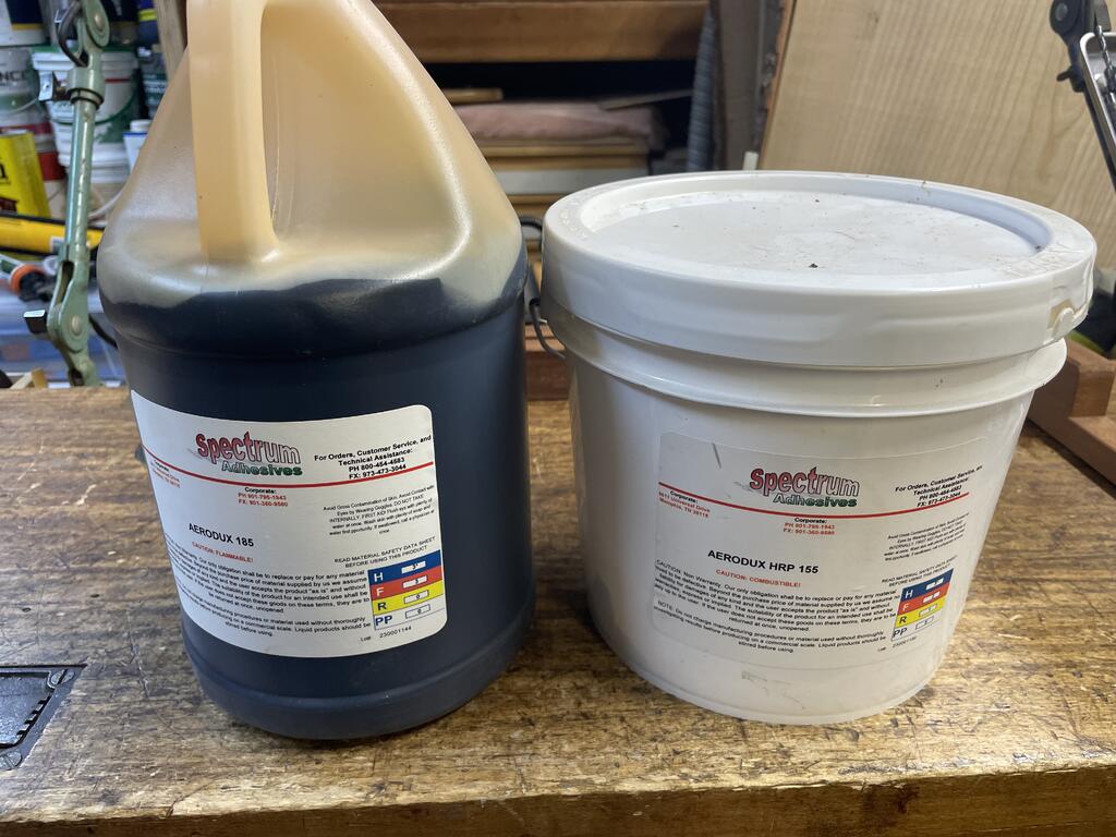

Urea formaldehyde. Two part glue. This is left over from a job . Its shelf life is basically over so it has to be discarded. Close to 80 dollars worth of glue to be discarded.

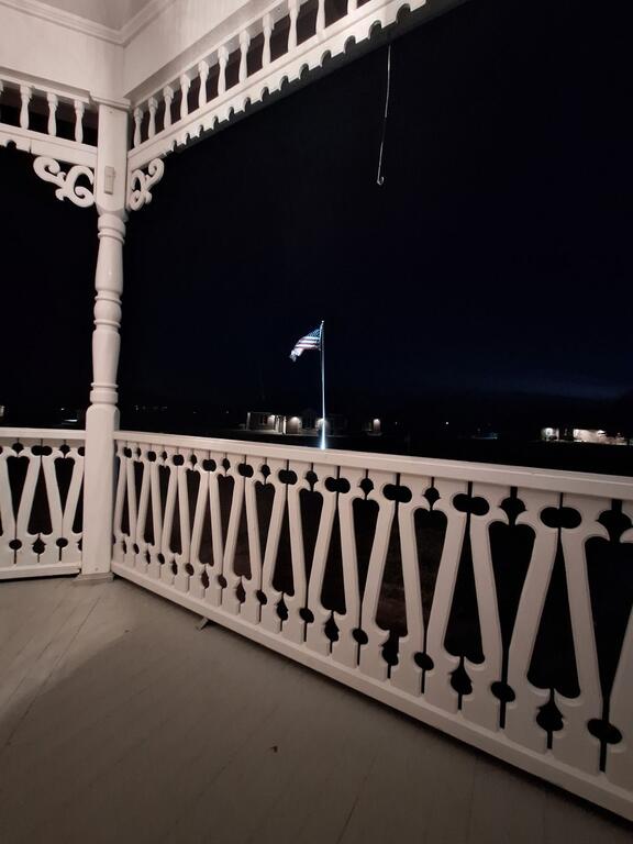

I've had pretty good success with polyurathane (Gorilla Glue) on projects.  I built the balustrade below in 2005 and used Gorilla Glue.  So far it's held up.  The sawn ballisters were made from cedar.  (At that time, #3 cedar was often times used as roof decking so I picked out the better boards for my railing.)  I bored something like 800 holes in the production of the handrail and the spandrels.
Unfortunately, the wooden posts I purchased at the lumber yard didn't last even ten years.  (They had a hole in the center the length of the posts from top to bottom.  I cut a hole in my porch floor and notched the top of the wooden posts hoping that air could circulate and therefore help the posts to dry and last longer but that was of no value. I replaced them with vinyl posts.)  I have one ballister that is getting punky but the rest have held up well.
Good think I have opportunity to join this post tonight. Tomorrow it will be too cold to be barefoot on the front porch taking photos!
