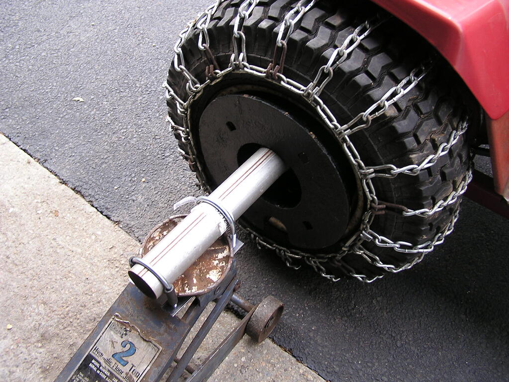

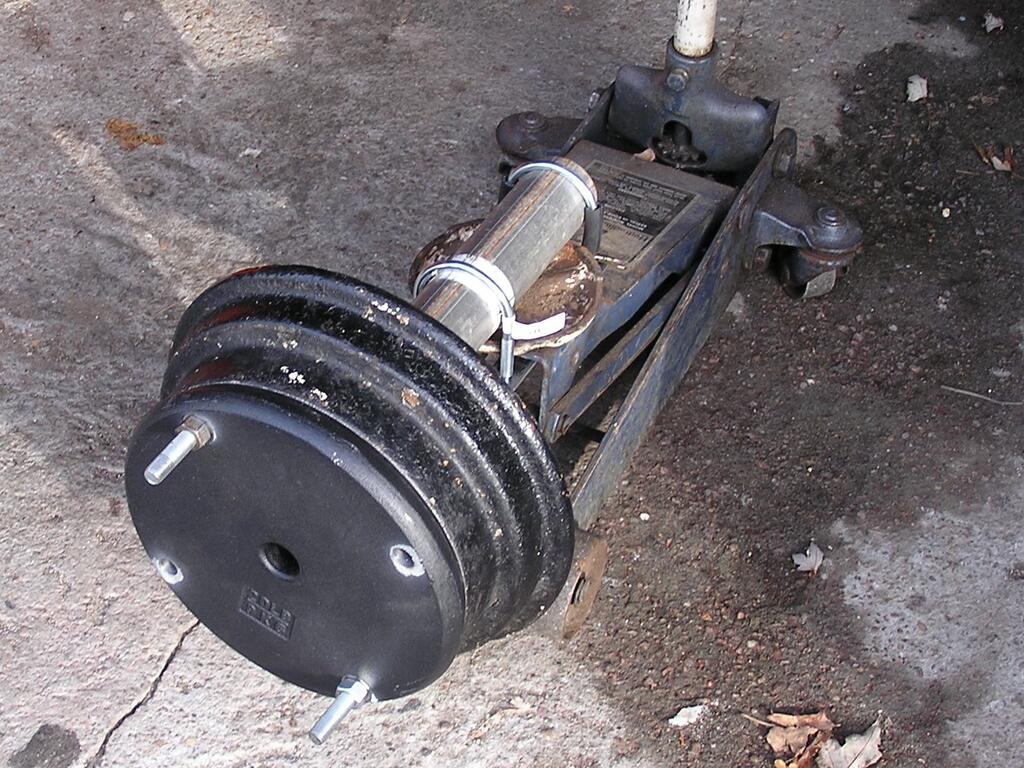

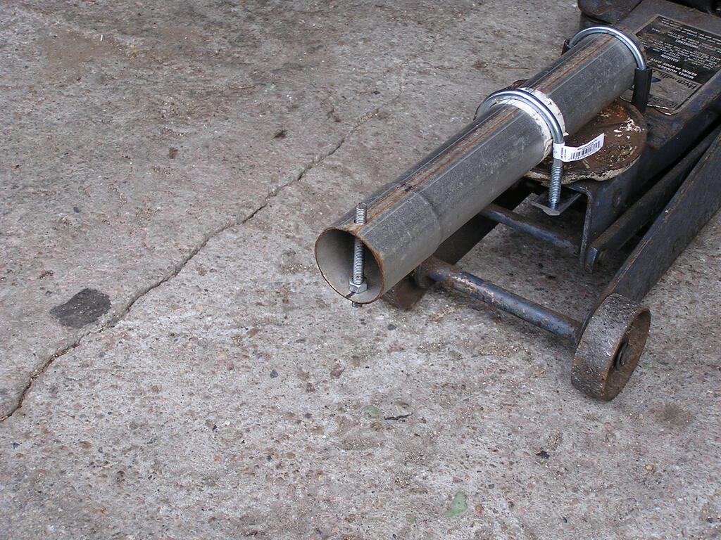

ri702bill 13,067 #1 Posted November 8, 2025 I added an additional 20 lb barbell weight plate to my existing Bolens 75 pounders, as there was enough room for it in the C81 wheel... the problem is they now weigh 95 pounds each and are a bear to install. Solution - adapt the floor jack to lift & center the weights..... works well. 6 15 Share this post Link to post Share on other sites

ri702bill 13,067 #4 Posted November 8, 2025 34 minutes ago, peter lena said: wait a minute , are you suggesting a cure for a problem ? Yup - just like my old Engineering days... Access the problem.. Define the weights and forces required.. Sketch up at least two possible solutions.. Pick the "better" choice & streamline it to be as simple as possible.. Utilize suitable existing resources & materials... Source & purchase what is needed.. (Two muffler clamps & flat stock) Fabricate & evaluate. Note any required changes. I would call this a "2 beer job"! 4 1 4 Share this post Link to post Share on other sites

squonk 48,125 #11 Posted November 9, 2025 When I had the loaded rear wheels I used a Motorcycle jack to cradle the tire. 3 Share this post Link to post Share on other sites
ebinmaine 80,709 #12 Posted November 9, 2025 1 hour ago, squonk said: When I had the loaded rear wheels I used a Motorcycle jack to cradle the tire. We use a floor jack under the tractor and raise or lower the whole machine to match the wheel & studs by height. Wheel & tire stays on the floor. Slide the wheel in/out as needed. 2 1 Share this post Link to post Share on other sites
ri702bill 13,067 #13 Posted November 9, 2025 35 minutes ago, ebinmaine said: We use a floor jack under the tractor and raise or lower the whole machine to match the wheel & studs by height. Wheel & tire stays on the floor. Slide the wheel in/out as needed. I do the same with the loaded chained tire. I am using the OE lug bolts - I substitute 2 modified Chevy lug studs - thread them into the hub, slide the tire inward over them... 1 Share this post Link to post Share on other sites
ebinmaine 80,709 #14 Posted November 9, 2025 1 minute ago, ri702bill said: I do the same with the loaded chained tire. I am using the OE lug bolts - I substitute 2 modified Chevy lug studs - thread them into the hub, slide the tire inward over them... Similar here but with 5 studs. No original bolts. 1 1 Share this post Link to post Share on other sites
