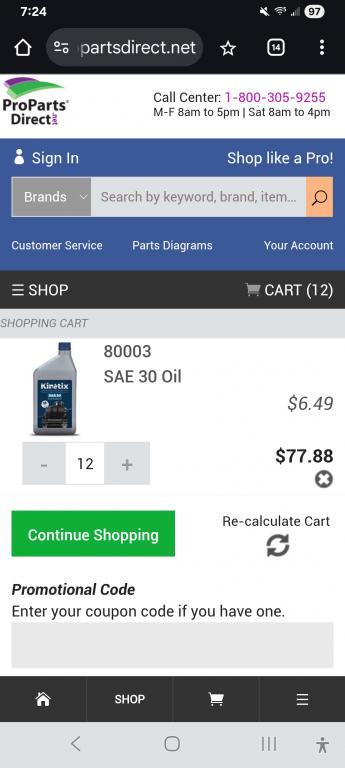

ebinmaine 77,323 #35 Posted November 23, 2025 12 hours ago, dmoore said: Thoughts EB? OK, here's what I've been using for several years and how I've been obtaining the product. Note. I do believe in shopping locally when practically possible but this area is also going away from a reasonable price and ordering process for correct small engine oils. 🛢 I was initially told about Kinetix brand by a local small engine shop where I bought my Echo chain saw. They have since morphed to a heavy equipment place. No retail sales. I was able to get it from my favorite small engine repair place for a bit. He stopped selling it because most of his services are on newer engines that dont need the older oil formulas. 2 strikes. So I went poking around on the interwebs and found: I've now been buying Kinetix for 3 or 4 years from ProPartsDirect. They occasionally have free or reduced shipping promotions. Even without that their price is lower than others. Add $14 (estimated) to the above. Say $92 per case. I'm at $7.66 per quart shipped to my own workshop. 13 minutes ago, Wild Bill 633 said: I love reading "What is the best oil?" posts. Agreed. IMHO there is NO best oil. I personally use and recommend Kinetix oil and ProPartsDirect because the formula is supposedly correct and the price & service is good. 1 Share this post Link to post Share on other sites
lynnmor 8,623 #36 Posted November 23, 2025 3 hours ago, ebinmaine said: OK, here's what I've been using for several years and how I've been obtaining the product. Note. I do believe in shopping locally when practically possible but this area is also going away from a reasonable price and ordering process for correct small engine oils. 🛢 I was initially told about Kinetix brand by a local small engine shop where I bought my Echo chain saw. They have since morphed to a heavy equipment place. No retail sales. I was able to get it from my favorite small engine repair place for a bit. He stopped selling it because most of his services are on newer engines that dont need the older oil formulas. 2 strikes. So I went poking around on the interwebs and found: I've now been buying Kinetix for 3 or 4 years from ProPartsDirect. They occasionally have free or reduced shipping promotions. Even without that their price is lower than others. Add $14 (estimated) to the above. Say $92 per case. I'm at $7.66 per quart shipped to my own workshop. I have been using Kohler oil, price here is $7.40 per quart and it is also available at ProPartsDirect. I have found it for less elsewhere, it is best to do a seach each time you want to order. 1 Share this post Link to post Share on other sites
