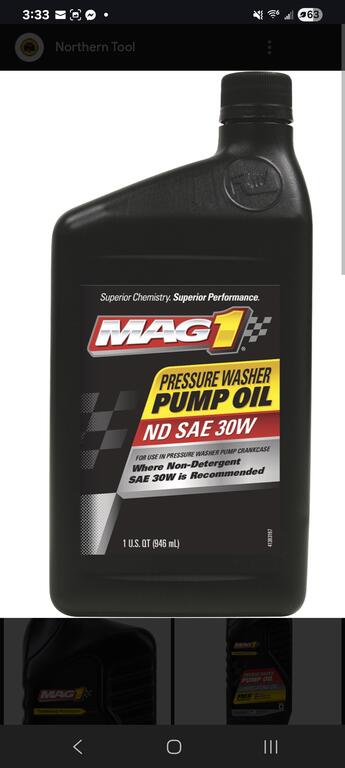

FarmallFarmer09 31 #5 Posted November 7, 2025 Its napa brand sae 30 non detergent oil. We used it in our farmall and had some left over. Share this post Link to post Share on other sites
ebinmaine 80,278 #6 Posted November 7, 2025 9 minutes ago, FarmallFarmer09 said: non detergent OK that's a NO 1 Share this post Link to post Share on other sites

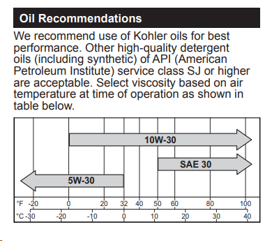

ebinmaine 80,278 #7 Posted November 7, 2025 Kohler manual should state you want HD 30. WITH detergent.... Share this post Link to post Share on other sites

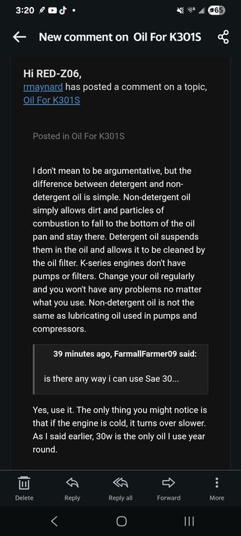

rmaynard 17,527 #12 Posted November 7, 2025 I have used straight 30w in all my Kohlers since 1993. Sometimes I used detergent, sometimes non-detergent. It doesn't seem to make any difference as long as you change it regularly. As far as temperature is concerned, the 30w in mine has worked well in all temperatures. Transmission oil should be checked for water. A transmission that lives in an unheated environment can freeze and leave you disabled until thawed. 2 Share this post Link to post Share on other sites

lynnmor 9,010 #14 Posted November 7, 2025 SAE 30 detergent oil above 32 degrees, 10W-30 below. I use Kohler oil since all automotive oils have been altered to suit the emissions control parts. 1 Share this post Link to post Share on other sites

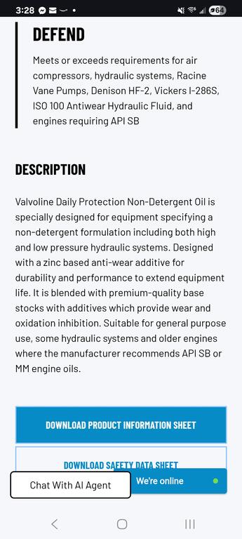

RED-Z06 2,720 #15 Posted November 7, 2025 17 hours ago, FarmallFarmer09 said: Bought it this year. google says sae-30 SHOULD NOT be used. Maybe i need to stop trusting everything on the internet lol. Thank you SAE30HD would be fine, but Non-Detergent oil is meant for Power Washer Pumps, Compressor Pumps...its a quick way to kill a gasoline engine because the lack of detergents causes the oil to break down and sludge up Share this post Link to post Share on other sites

RED-Z06 2,720 #17 Posted November 7, 2025 48 minutes ago, FarmallFarmer09 said: is there any way i can use Sae 30 in under that temp, Or the same for 10w-30, Can i use it above that temp? Ive heard that i can use sae 30 under the recommended temp, But i need to let the engine warm up before driving, Is this true? SAE30 High Detergent is a good summer oil, most people run 10w30 or 10w40 year round, if it's very cold you can run a 5w30. Share this post Link to post Share on other sites
RED-Z06 2,720 #18 Posted November 7, 2025 I cant find Rmaynards post here but, yes Detergents and Surfactants keep particles in suspension and prevent them from settling out because thats where the sludge comes from, you want that stuff to stay in the oil so it can be drained out, once it settles you cant get it out by draining. Manufacturers have recommended Detergent Oils for as far back as i can find literature for. Valvoline specs it for gearboxes, hydraulic systems, some supercharger manufacturers spec it for their gearboxes...because theres no combustion contaminants to deal with. 1 1 Share this post Link to post Share on other sites

lynnmor 9,010 #20 Posted November 7, 2025 Just now, kpinnc said: Or Rotella diesel engine oils. Available in straight 30w or multiweight grades for cold weather. I simply posted the information contained in his Kohler manual. Yes, we can experiment with all kinds of oils but I think it is best to show the manufacturers recommendation and leave the decision to the owner of the engine. I do use 30 in colder temperatures than shown in the charts but my winter tractors are kept at room temperature before use. That still isn't correct since the crankcase likely won't stay up to operating temperature over time in extreme cold. But that is just me and I won't tell others to follow my habits. 2 Share this post Link to post Share on other sites
