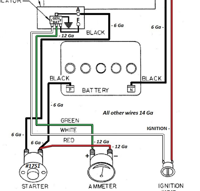

squonk 44,615 #6 Posted yesterday at 04:19 PM Yes regulator is the cause, The only way the gen spins on it's own is to power up the Armature, and since the key is off the only way for this to happen is a back feed from the regulator. The regulator is connected to the battery on the center terminal. 1 1 1 Share this post Link to post Share on other sites
Mike'sHorseBarn 3,351 #7 Posted yesterday at 04:23 PM 2 minutes ago, squonk said: Yes regulator is the cause, NUTS!! Share this post Link to post Share on other sites
Handy Don 14,644 #8 Posted yesterday at 04:32 PM If you have an ammeter on your tractor, it should show the back flow via the black, red, and green connections in @squonk’s posted diagram that is keeping the S/G spinning. Share this post Link to post Share on other sites

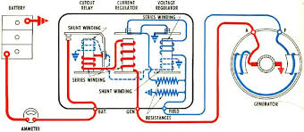

Achto 29,806 #9 Posted yesterday at 04:42 PM (edited) Function breakdown Cutout Relay: This is a one-way switch that closes when the generator is producing more voltage than the battery. This allows the battery to charge. If generator voltage drops below the battery's voltage, the relay automatically opens to prevent the battery from discharging back through the generator. Voltage Regulator: This is an electromagnetic switch that turns on and off at a high rate (50-200 times per second). When voltage is high: The regulator's magnetic field pulls its contacts apart, inserting resistance into the generator's field coil. When voltage is low: The magnetic field weakens, allowing a spring to pull the contacts back together, removing the resistance and allowing the voltage to rise again. This cycle constantly adjusts the field current to maintain a steady voltage, typically around 13.5−14.2513.5 minus 14.25 13.5−14.25 volts, regardless of engine speed. Current Limiter: This function operates when the electrical system's load is high and the battery is low. The current regulator engages to limit the current flowing through the generator's field, which protects the generator from being overloaded. My guess is that your Cutout Relay is stuck / burned together. Edited yesterday at 04:44 PM by Achto 1 2 1 Share this post Link to post Share on other sites
Handy Don 14,644 #10 Posted yesterday at 05:04 PM 20 minutes ago, Achto said: Current Limiter: This function operates when the electrical system's load is high and the battery is low. The current regulator engages to limit the current flowing through the generator's field, which protects the generator from being overloaded. The limiter also functions, as I understand it, to prevent “cooking” a battery while the generator output is strong and the battery is already fully charged. The example I recall is a farm tractor running non-stop for many hours after startup. Note that the WH regulators I’ve seen do NOT have the current limiting relay. Share this post Link to post Share on other sites
Achto 29,806 #11 Posted yesterday at 05:17 PM (edited) 16 minutes ago, Handy Don said: Note that the WH regulators I’ve seen do NOT have the current limiting relay. If remember right. My regulators have the 3 coil set up inside, this would include the current limiter coil. If a regulator does not have a current limiter there will only be 2 coils. Edited yesterday at 05:21 PM by Achto 1 1 Share this post Link to post Share on other sites
