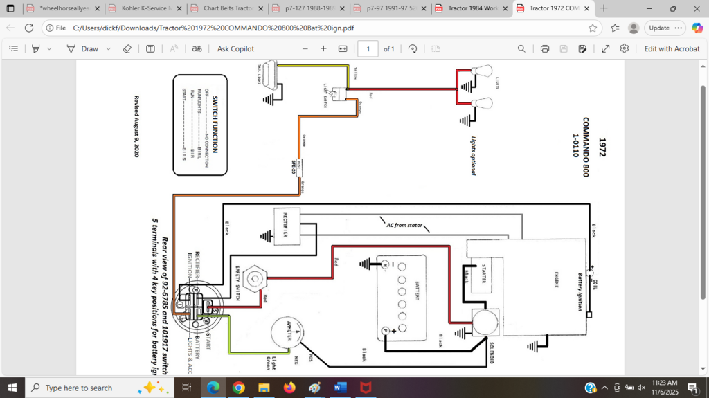

Before making assumptions on the Commando's wiring needs there are a couple of things we need to know.
Is the engine the 8 HP Kohler the tractor left the factory with (or one like it)?
Is the engine ignition system a magneto or battery powered system?
Is there a number on the present ignition switch?
Is the clutch safety switch presently in place and being used?
We have some rather generic wiring on this site that could be customized to fit your needs once we know what we are working with.
Below is the factory wiring drawing.
  • Like 1
rmaynard
A picture of the tractor and engine would be nice. Otherwise we are spitting into the wind.
The Commando 800 was produced in 1972 and 1973. Both years it had a K181S-30461D engine. That engine has a regular starter with a Bendix gear engaging the flywheel. It should have a separate solenoid. The tractor had a battery ignition meaning that there is stator under the flywheel with two usually white wires coming out that terminated at the rectifier/regulator.
At this point I will stop until we have some more data, PICTURES...please.
  • Like 1
