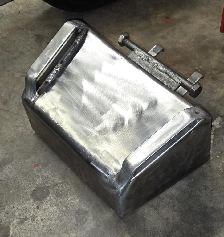

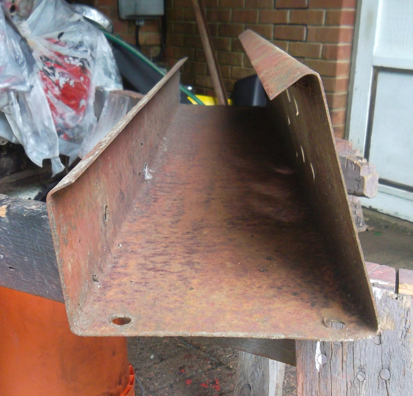

Lee1977 7,544 #1 Posted November 5, 2025 I have had this metal building steel around 40 years decided to make a front weight out of it. Got it cut out and tacked together. Turn into a joint project with Kevin as he welded it up. Had enough steel left so I cut another one for Kevin. It has around 2" of sheet lead inside. Best guess it weights 50 #. 5 7 Share this post Link to post Share on other sites
ebinmaine 77,082 #2 Posted November 5, 2025 Niiiiice! Got a bar on the back to mount in the front hitch? 1 Share this post Link to post Share on other sites

kpinnc 17,030 #4 Posted November 6, 2025 4 hours ago, Lee1977 said: Had enough steel left so I cut another one for Kevin. I'll try to get mine welded up by the weekend Don. Thank you very much! A very cool idea! I think I'm gonna use it as my hood stop on the newest tractor. I gotta pick up some lead too. 3 hours ago, ebinmaine said: Got a bar on the back to mount in the front hitch? Yes they do. Don made up a bracket that uses a 5/8 bolt and a standoff to fit in the front hitch. 1 Share this post Link to post Share on other sites

Lee1977 7,544 #6 Posted November 6, 2025 (edited) One reason I used a 5/8" bolt in the hitch is you can tighten it once it's in the hitch. Stops any movement. The wheels came off a trailer that why the don't have weight holes. Edited November 6, 2025 by Lee1977 3 Share this post Link to post Share on other sites

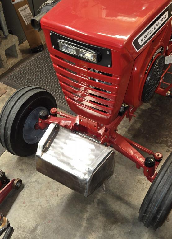

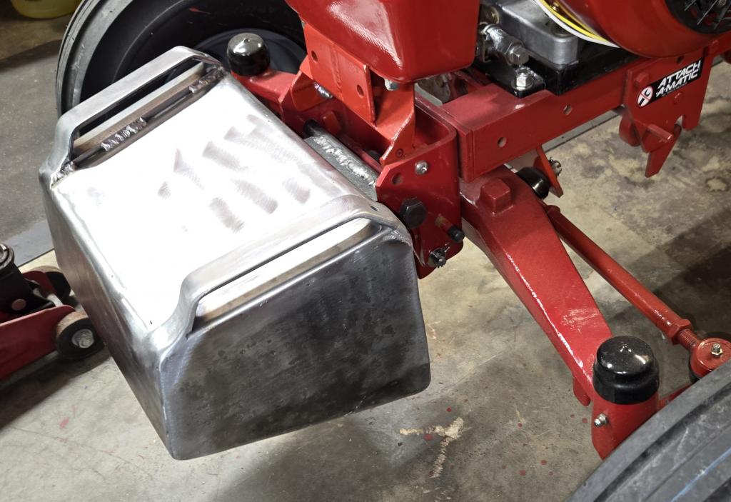

kpinnc 17,030 #10 Posted November 8, 2025 (edited) On 11/5/2025 at 5:28 PM, Lee1977 said: Turn into a joint project with Kevin as he welded it up. Got mine started tonight. Sides are on, just gotta set up the attachment hardware on the back and fill her up. Edited November 8, 2025 by kpinnc 1 1 Share this post Link to post Share on other sites

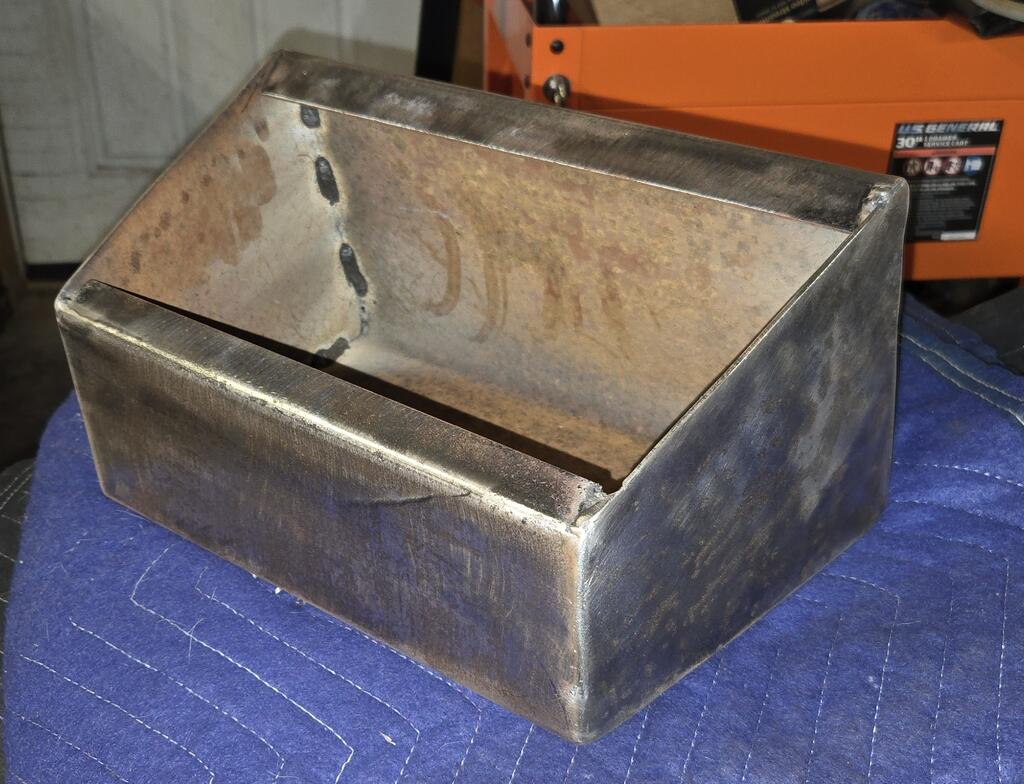

kpinnc 17,030 #11 Posted November 17, 2025 (edited) Got a bucket full of lead wheel weights from a buddy of mine. When I melted them down, I found out only about half were actually lead. I had no idea. So I covered everything in a little concrete just to keep it from rattling around. I'll weld on a cover when it dries. So far it's 80lbs. Prolly go up a little when I finish it up. Edited November 17, 2025 by kpinnc 4 Share this post Link to post Share on other sites

kpinnc 17,030 #15 Posted November 24, 2025 Got a few minutes to finish mine up today so far as welding. Made a test fit just for giggles. This thing is hard to get situated. I thought I had something crooked until I saw the right side of the nose hitch is bent. Handles or not, the floor jack is a must. It weighs just over 80lbs. Now to figure out how to paint this thing! 10 Share this post Link to post Share on other sites

Lee1977 7,544 #18 Posted November 24, 2025 I turned my weight box up side down and painted the bottom a hitch let it dry then painted the rest. I have three tractors that the back side of the sheet metal is painted black with the red on the exposed side. Share this post Link to post Share on other sites

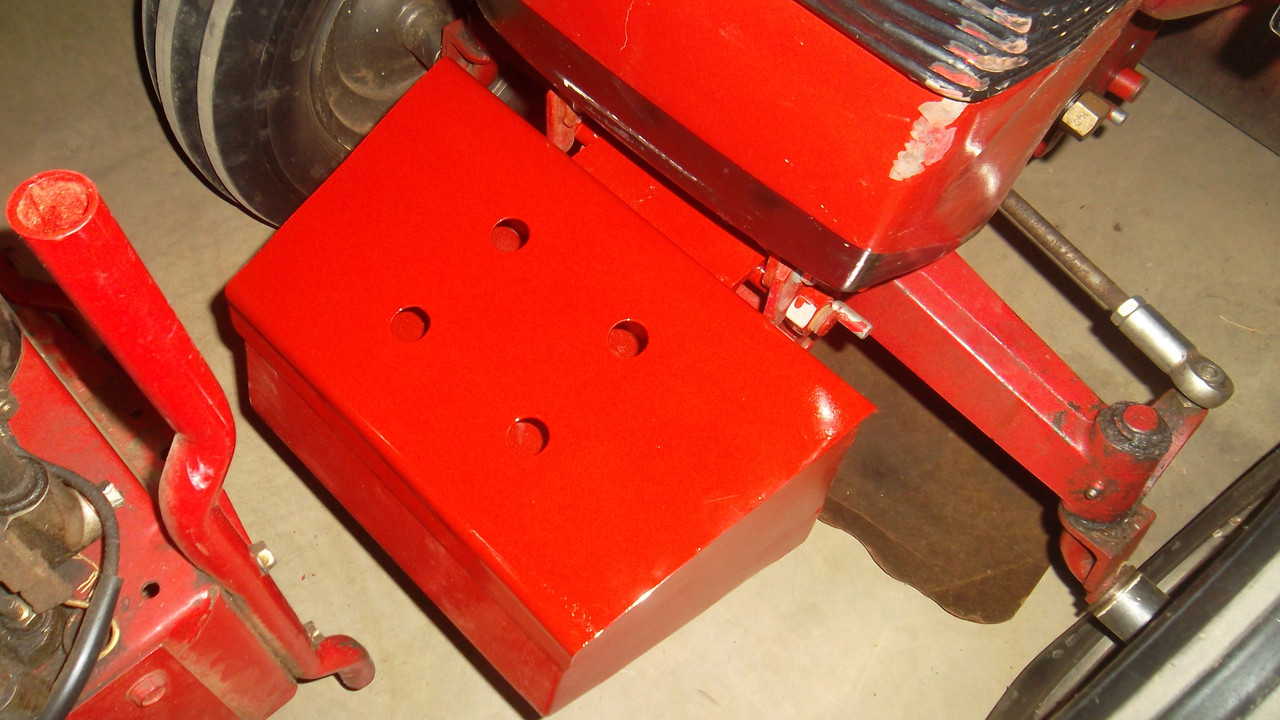

Lee1977 7,544 #19 Posted December 15, 2025 I've got about as slow as EB, but I did get the top for the weight box cut out and painted. Now i just have to attach it. 3 3 Share this post Link to post Share on other sites

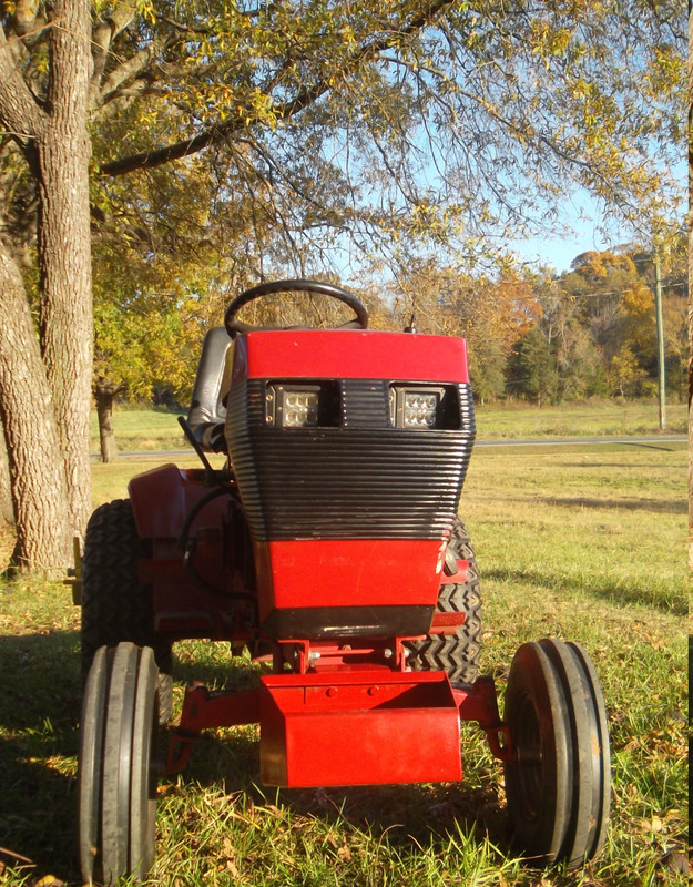

kpinnc 17,030 #21 Posted December 27, 2025 Finally painted mine over the last few days. Hopefully next week sees time for other projects... 7 Share this post Link to post Share on other sites
