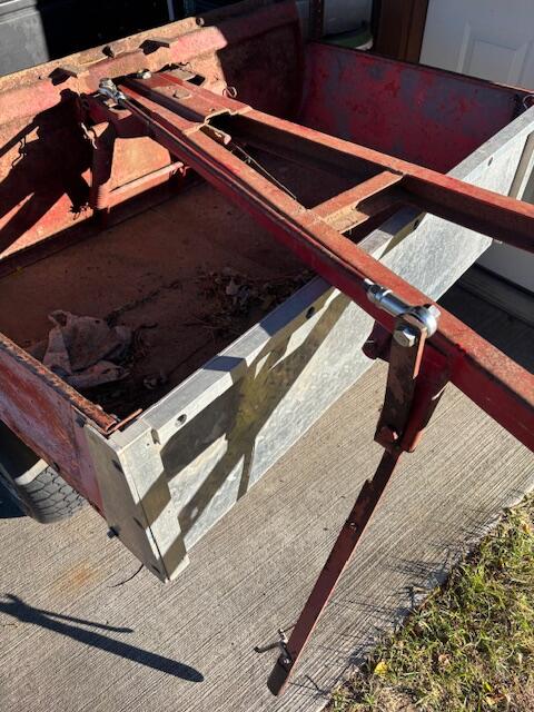

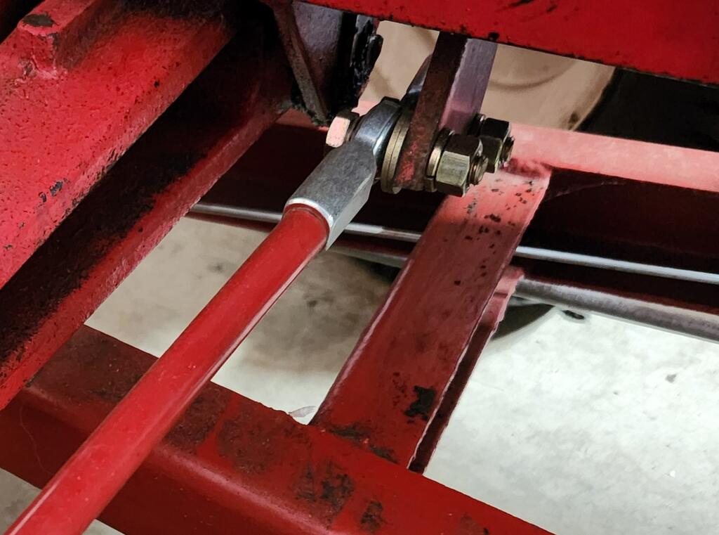

56servi 67 #1 Posted November 4, 2025 Got this modification from ri702bill, on putting hemi joints on the ends of the angle rod on your snowplow/dirt plow. This makes for much smoother action between the handle and blade when angling the blade. It also makes removing the blade from the frame for storage. You cut the right angle from one end of the rod then thread it to screw into a hemi joint (1/2-20 thread on most hemi joints) I cut the length of the thread to be the same length as the depth of the thread in the joint plus enough thread to add a jam nut. Mine was about 2 inches. Mount the joint to the blade hole where the rod bend was before Add washers to bring the hemi down enough so the rod clears the bottom of the quadrant. I put a flat washer on both sides on the hemi and on the nut side of the bolt. Use a Nyloc nut to secure it. Screw a Nyloc nut on the rod with the Nyloc side going on 1st, then screw the rod into the hemi joint about 1/2 way. Tighten the nut against the hemi to keep the rod from turning. Mount the other Hemi on the handle the same way. With the handle in the straight up & down position mark the end of the rod to be about 1/2 way into the threads. Cut the rod at the mark & thread. Thread this end into the hemi and secure like the other end. 2 5 Share this post Link to post Share on other sites

sqrlgtr 2,395 #4 Posted November 4, 2025 Great looking upgrade. I just put a 5 angle 48" blade on the 1257 and it is hard to turn blade to the right even after greasing everything up. I think the push/pull rod has been kinked on the very end on mine and gets in a bind in certain positions. This would eliminate that. @56servi may I ask where you got your heim joints? 1 Share this post Link to post Share on other sites
peter lena 9,812 #5 Posted November 4, 2025 @sqrlgtr that push pull lever , needs a SHOULDER BOLT , at lower squeeze lever area , the exact size to size , lets everything swing with ease , what I do is to flat washer up a perfect hold / movement spot , use a regular nut , to dial it in , then , swap nut for elastic lock nut , lubricate as you set up , another vital spot is the , slide pin in the swing quadrant , build mine up on milk crates , so you can roller stool around it , and dial in function . got my heims on line , also have one on my pto lever end . eliminate the sloppy trundle , pictures of other change outs , glad you are trying this , years in use , pete 1 Share this post Link to post Share on other sites

peter lena 9,812 #14 Posted November 5, 2025 @56servi been adding / using heim joints for years , any time you have a restrictive movement in your intended function , the heim swivel eliminates it , also like SUPER LUBE , hydraulic oil , on that swivel , check out related temp range . regularly look at INTENDED TROUBLE AREA , you are looking at what is not easily moving . regularly refer to a roller stool look over ? being able to comfortably sit and look at a problem , lets you plan / think ? of a fix. you can also easily paint anything red / black , so it disappears , having my stuff over 40 years , you can bet , problem elimination , was a regular thing . simple ex , that sloppy pto lever set up , and related bearing , regrease , makes for a very smooth , easy , quiet , engagement , never burned out a pto clutch , only suggestions , been road testing them for years , no issues . ever spring assist a cable ? what could you possibly do ? pete Share this post Link to post Share on other sites
