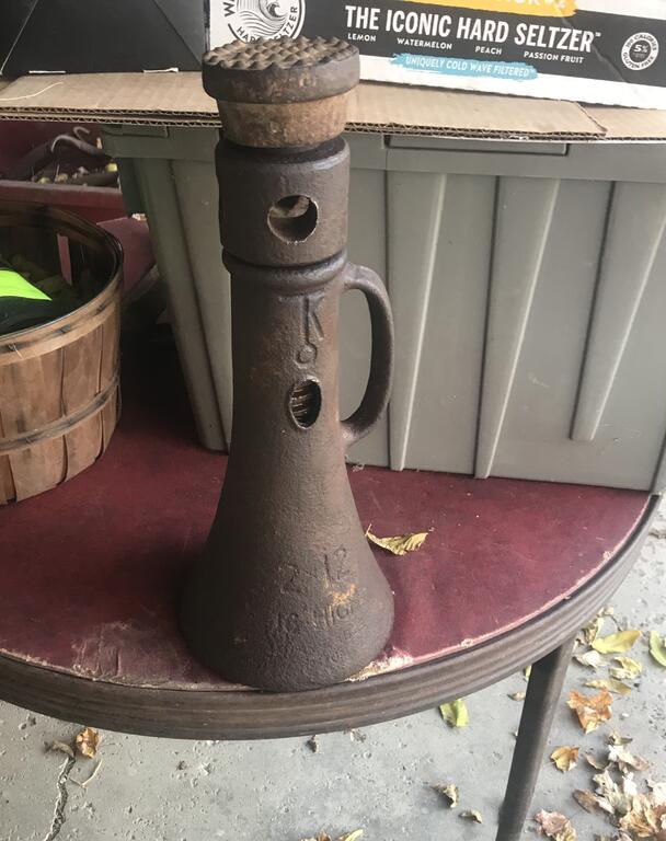

I’ve tried PB Blaster for a day now with light heat from propane torch and can’t get it to move any.
Any ideas or advice welcome. Thanks in advance

Longer soak. ATF and acetone. Flip it over to hold the liquid.

@rustyedge1   2 things ,  KROIL  PENETRANT , have something  immovable  you can  secure that to ?  like a chain winch ?  18" pipe wrench  inside a long  thick walled pipe , solid mount , creeping lubricant and , leverage  , will probably move it  , you can really load up  a  frozen anything  , with  leverage . worked with a pipefitter  for years  , solid mounting , and  long leverage pipe wrench , thats  what  i  think ,  pete

Smother in anti-seize and heat with the propane torch again. The stuff will melt and run down in the threads. I used to use it on EGR fittings a lot. Be careful to not over-heat it or you will bake it and then make things worse.

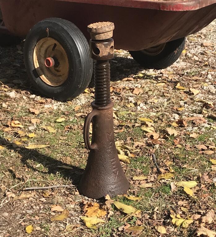

Got it ~ Thanks all for the info..
Little more heat and Blaster and light taps bigger wrench.

Actually go a bit easy on the lubrication ..too slick and it will slowly slide down under load.  had to put a bar through one of mine and brace it against something to keep it up.   I had really lubed it up.
