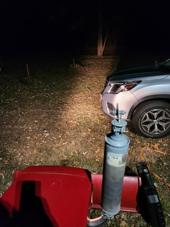

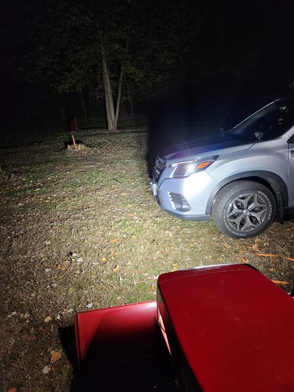

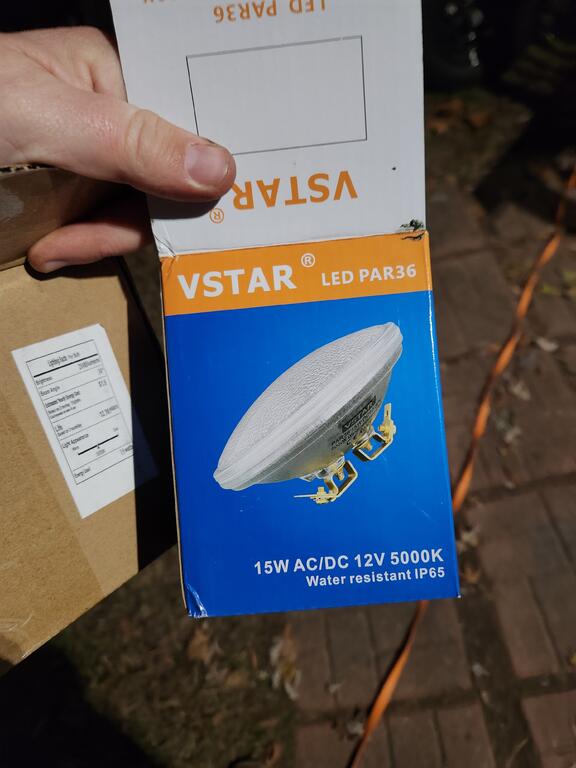

1987_WHEEHORSE312 82 #1 Posted October 30, 2025 I sourced these lights off Amazon gor $25 for the pair. They are direct boltup, plug and play, no modification required. You can see the huge improvement they make over stock. I have included photos of the part number and the box they came in. 8 1 Share this post Link to post Share on other sites

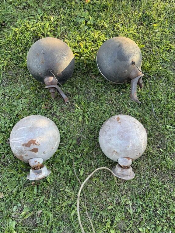

Bar Nuthin 2,246 #6 Posted October 30, 2025 The comparison between the LED and the sealed beams is quite significant, I just scored a couple more pair of vintage tractor lights earlier this week. I like the ones with the cupped base and internal wire, but they're harder to locate. 3 Share this post Link to post Share on other sites

Bar Nuthin 2,246 #11 Posted November 13, 2025 On 10/30/2025 at 8:32 AM, Bar Nuthin said: I just scored a couple more pair of vintage tractor lights earlier this week. I thought I was getting 4" tractor lights - turns out they are 7" lights (big tractor or possible vehicle). They're in great shape overall so, I guess I'll clean them up a little and try and find someone that can use them. 1 Share this post Link to post Share on other sites

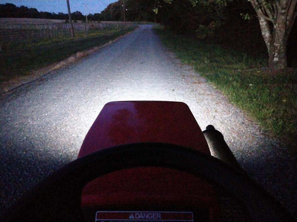

peter lena 9,797 #19 Posted November 14, 2025 @1987_WHEEHORSE312 also agree on the LED DIFFERENCE , DO A LOT OF ROAD EDGE PLOWING , often at night , minimal traffic , etc , the back of the tractor is just glowing red , also have a reflector back there . at walmart , they have a wall full of same size bolt on lights , looks like a perfect fit . also wear a reflective vest . pete 3 Share this post Link to post Share on other sites

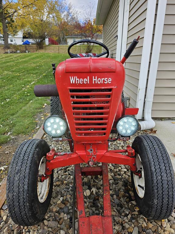

ML3 2,182 #22 Posted November 15, 2025 (edited) Installed these leds on my 654. Also put them on the 702 & may try to fit a pair on the Workhorse. Harbor Freight led floodlight $11.99ea. They are really bright, affordable, & if needs replaced easy to obtain. They held up thru last winter & still work fine now. They dont look too bad but they are installed on working tractors so Im not concerned about authenticity. VID-20250103-WA0017~3.mp4 Edited November 15, 2025 by ML3 1 Share this post Link to post Share on other sites
