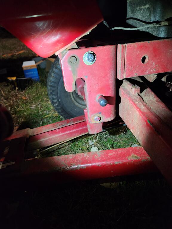

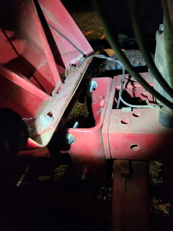

On the 300-500 series tractors, if your Hood Stop bar is missing, 2 1/4" bolts with washers, lock washer and nuts bolted into the holes where the rod went through is the perfect solution. You can see them in the attached photos. This setup cost 39 cents.
