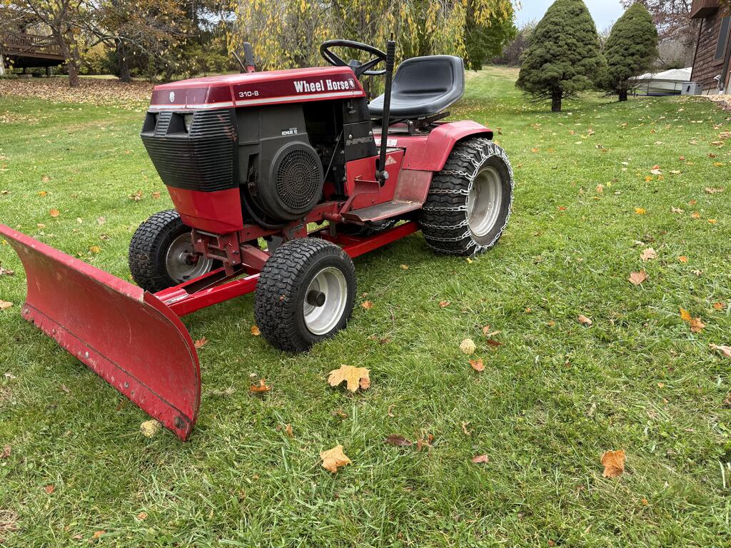

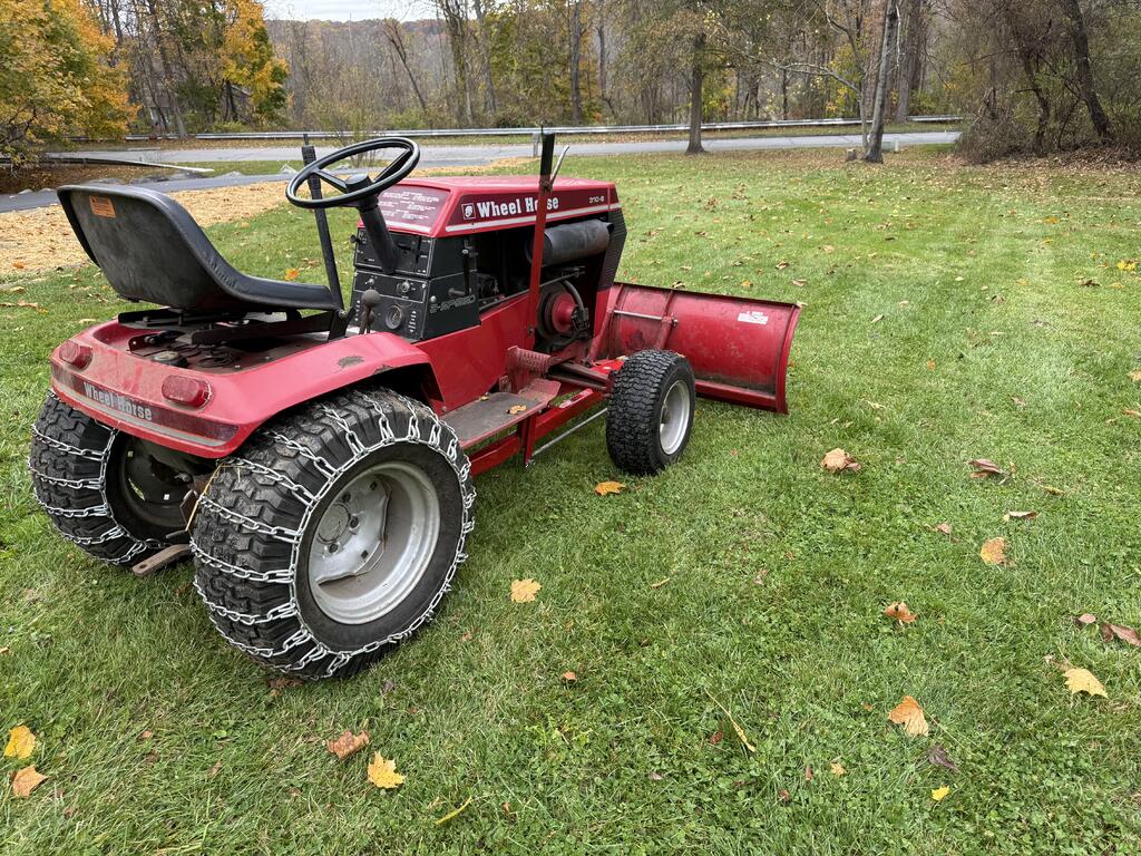

nylyon-(Admin) 8,840 #1 Posted October 29, 2025 Megan didn’t buy her house this year, so I guess I am stuck with the 310-8 I got for her. A short time ago, I picked up a beautiful plow (barely used) so I decided to put it on the 310-8. Debating whether I want to put on my craftsman wheel weights or not? If I had a spare set of WH weights I would do it, but Craftsman?? The HD spindles and thrust bearings make steering like there is nothing up front. 5 13 Share this post Link to post Share on other sites
Bill D 2,649 #2 Posted October 29, 2025 Beautiful setup. Do you have any pictures of the thrust bearing setup? Thinking about doing this on my 416H's. 2 Share this post Link to post Share on other sites
nylyon-(Admin) 8,840 #3 Posted October 29, 2025 12 minutes ago, Bill D said: Do you have any pictures of the thrust bearing setup? Thinking about doing this on my 416H's. I don’t, with the HD Spindles the top shaft is slightly longer allowing the thrust bearings, 2 bearing washers and a top washer to fit without any modification to the spindle. From what I understand, with standard spindles if you want to use thrust bearings you need to shave the axle a little bit to get everything to fit properly. 2 1 Share this post Link to post Share on other sites
953 nut 64,441 #4 Posted October 29, 2025 The leaves are still coming down so the 418 has the leaf blower on it for now. Thanks to Wheel Horse's attachment system even an old codger like me can swap it over to a snow plow in a few minutes. 5 2 Share this post Link to post Share on other sites
Handy Don 16,048 #5 Posted October 29, 2025 1 hour ago, nylyon said: Craftsman?? Weight is weight, right? Get Terry to do you a set of the WH decals to cover the “other” brand name! 1 hour ago, nylyon said: From what I understand, with standard spindles if you want to use thrust bearings you need to shave the axle a little bit to get everything to fit properly. Yes, correct. Also, as others have discovered as well, the bottom bearing surface of the axle casting is not always perpendicular to the spindle bore and nor are the stock spindle washers always welded perpendicular to the shaft! It helped a lot to make these correct when I added thrust bearings to our 312-H. (with a "tip ‘o the hat” to @ri702bill). And yes, along with making sure the toe-in is correct, these upgrades greatly reduce steering effort. 5 Share this post Link to post Share on other sites
ri702bill 11,447 #6 Posted October 29, 2025 19 minutes ago, Handy Don said: Yes, correct. Also, as others have discovered as well, the bottom bearing surface of the axle casting is not always perpendicular to the spindle bore and nor are the stock spindle washers always welded perpendicular to the shaft! Don is right - the high spot on the spindle washer tends to wear a radial groove into the softer cast axle boss. Fly Cutting the underside of the boss for either a thrust type linear bronze bearing or the thrust / washer stack removes that worn spot and trues the boss to be perpendicular to the bore. 3 Share this post Link to post Share on other sites

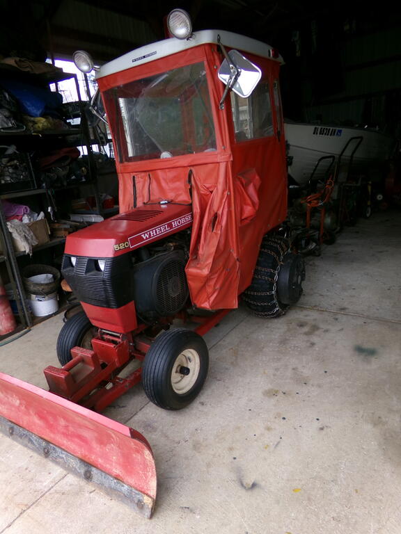

peter lena 9,789 #7 Posted October 29, 2025 @ NYLON lucas X TRA HD , GREEN CHASSIS GREASE , polyurea rated , 550 flash point , all my bearings have the swap , effortless engagement , that blade , swing quadrat area / related , slide pin is the KEY of swing , even thou , plow is new , the squeeze lever point , should show you the way, for effortless use, also like lubrication on the blade face , for easy slide off , my plowing horse is also ready , just add 200 lb vacuum pump rotor , pictures 3 / 4 , slides right oh a 6 " piece of channel steel . pete 2 Share this post Link to post Share on other sites

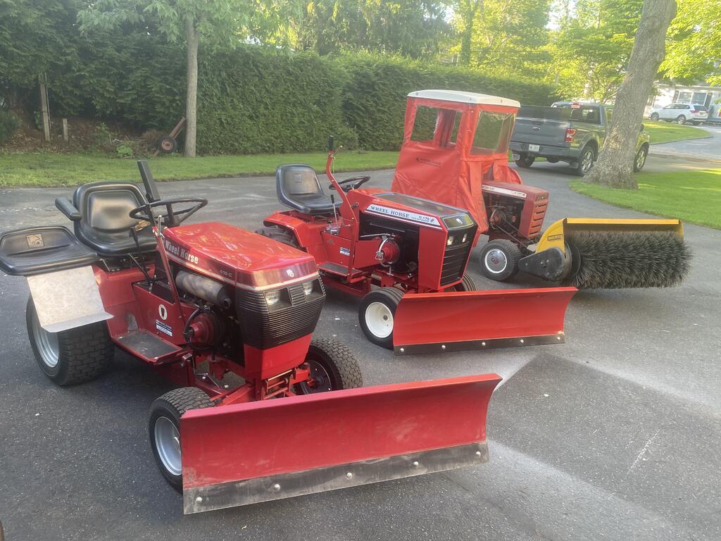

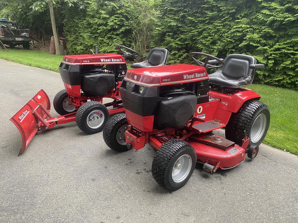

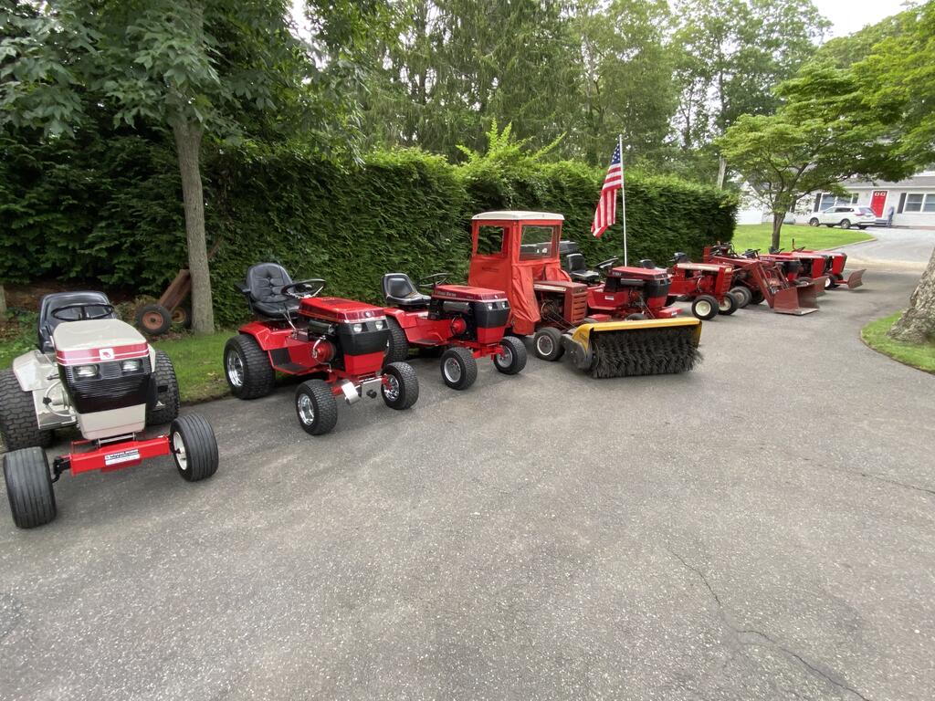

c-series don 11,573 #23 Posted October 30, 2025 I’ve always plowed with a hydro with hydraulic lift, until I got my 418-8 with electric lift. I figured I’d give it a shot just to see how I liked it. Well after one storm I switched back to hydraulic lift and automatic transmission. I believe 8-speeds have their place, like rototilling. But I think the automatic is better for plowing snow. As always just my opinion…… Threw in a few extra pictures for the heck of it, I know you guys like pictures as much as me!! 2 7 1 Share this post Link to post Share on other sites

c-series don 11,573 #25 Posted October 30, 2025 @wallfish Yes I have used it in the snow and it works great. In all honesty though I have only used it in a light snowfall just to see how well it worked. I was very happy with the results, as it swept the asphalt clean. I’ve never tried it in more than an inch or two of snow because I have the plow or two stage blower if it really gets deep. 2 6 1 Share this post Link to post Share on other sites
