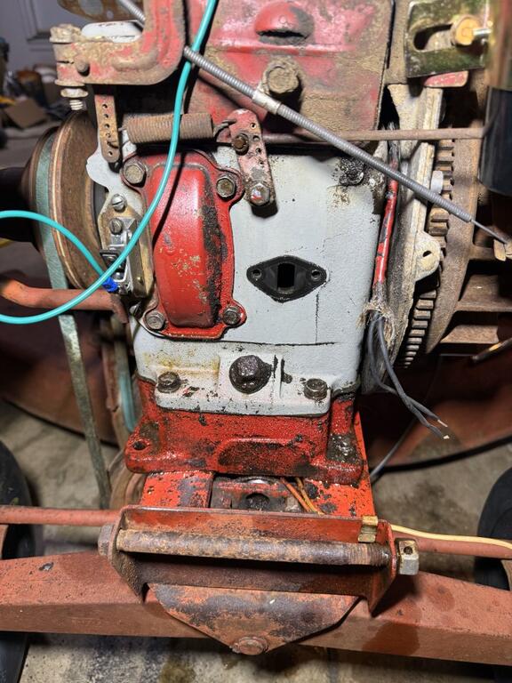

thekevin 51 #1 Posted October 28, 2025 68 Raider 12. The shield says K301 S 47147C which I think is the right one but do they hang off the side of the frame this much from the factory. Share this post Link to post Share on other sites
oliver2-44 11,694 #2 Posted October 28, 2025 (edited) Yes, the overhang is the factory ensign. If look under the frame angle you will see 2 bolts going into the bottom of the oil pan. Your grey block is probable a factory short block, or red parts are from the original engine. Edited October 28, 2025 by oliver2-44 4 Share this post Link to post Share on other sites
thekevin 51 #3 Posted October 28, 2025 Awesome. Makes sense why it seems to run so good and doesn't smoke any or make any noises. I am not sure how long it was sitting before I got it running tonight but it was a long time. Share this post Link to post Share on other sites
gwest_ca-(File Mod) 12,451 #4 Posted October 28, 2025 K301S-47147C was used in the 1969 and 1970 Raiders Share this post Link to post Share on other sites
ri702bill 12,808 #5 Posted October 28, 2025 (edited) 5 hours ago, oliver2-44 said: Your grey block is probable a factory shift block d red parts are from the original engine. Which most likely means it has a STD bore... Edited October 28, 2025 by ri702bill Share this post Link to post Share on other sites

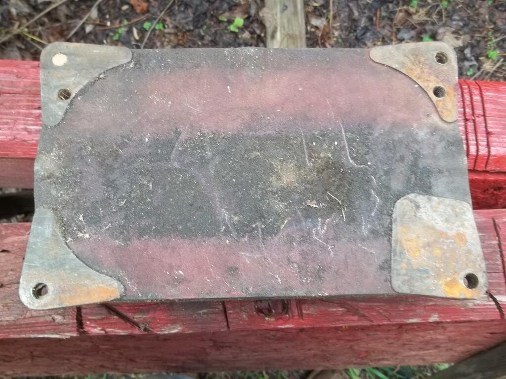

953 nut 68,500 #6 Posted October 28, 2025 Here is the pan from below. 3 Share this post Link to post Share on other sites
WHX?? 57,797 #7 Posted October 28, 2025 9 hours ago, oliver2-44 said: factory shift block Never heard it coined like that Jim but yes a service block or short block. Most often used if the original was ventilated or bore scored beyond 30 over. Share this post Link to post Share on other sites
oliver2-44 11,694 #8 Posted October 28, 2025 (edited) 10 hours ago, ri702bill said: Which most likely means it has a STD bore. 6 hours ago, WHX?? said: Never heard it coined like that Jim but yes a service block or short block. Most often used if the original was ventilated or bore scored beyond 30 over. Durn auto correct. “Short block” Edited October 28, 2025 by oliver2-44 2 Share this post Link to post Share on other sites

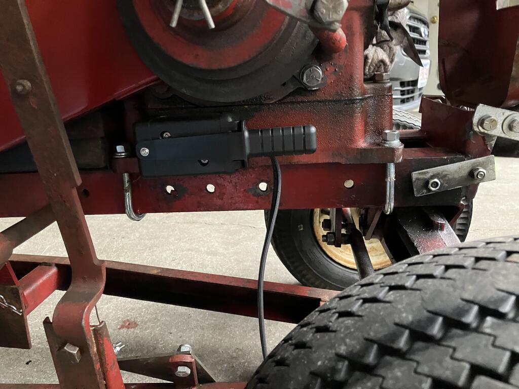

Retired Wrencher 6,920 #9 Posted October 29, 2025 @thekevin That oil pan Is said above is from the early 60s. 63 to 65. I believe. I have a 64 engine that I put into a 66 tractor and it has that pan. I use some heavy duty J bolts to hold it down here’s a picture. Because of the two bolts under the pan.Hope this helps. Share this post Link to post Share on other sites
