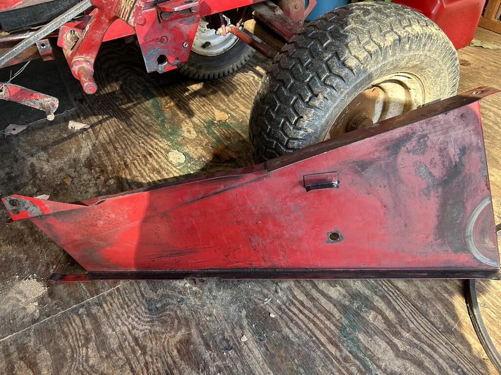

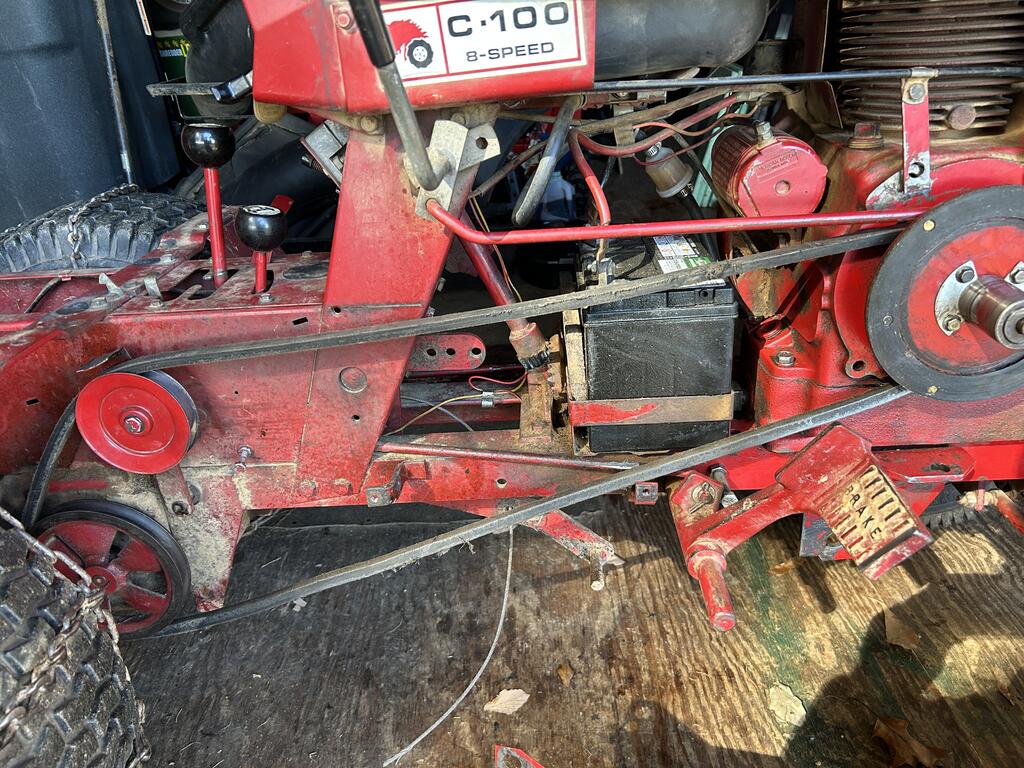

Farmer Forbes 8 #7 Posted October 28, 2025 Ok, frustration has finally set in after many attempts to route this drive belt in the proper manner. I purchased this WH C-100 in 2012 and the same belt, 93-9808 has been on it ever since. I decided I wanted to replace the belt, so I purchased another 93-9808, which DOES NOT fit, even though it is the same number. The new belt is way to tight and the gears grind. Below are two photos. The first is the old/original belt which appears to be the correct size; however, if I attempt to feed it into picture #2 and have the correct tension, it consistently jumps off the inside track or falls onto the bolt holder coming off the frame and then proceeds to chew up the belt. I have searched form a diagram to give me details on how correctly attach the belt. Any feedback would be greatly appreciated since I am at my wits end. BTW, up until recently this tractor drove like a charm pulling a single bottom plow and 36" tiller Thanks in advance Share this post Link to post Share on other sites

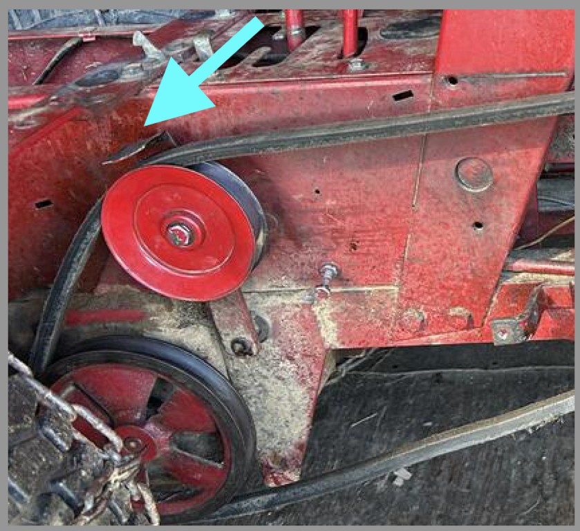

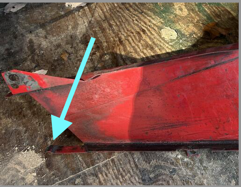

Handy Don 17,186 #9 Posted October 28, 2025 (edited) The blue arrows below point to the drive belt "rubbing thingees” on your tractor at the clutch pulley and on the belt cover. Both seem to be ok. The worn paint and rubber residue on the belt cover tab indicate it’s been doing its job so far. This belt seems worn because the clutch pulley arm is nearly perpendicular to the lower belt path but the belt isn’t taut. The belt is also riding kind of deep in the clutch pulley--is should ride about 1/16” proud of the pulley edges. (You do know, right, that belts do not “stretch” -- the sides of the “V” wear down allowing the belt to ride deeper in the pulleys so it’s path around them is shorter--it only seems like the belt lengthened?) Part numbers on belts are a bit of a crapshoot. Manufacturers all interpret things a little differently. Measuring is the only sure way. Understand that even ½” in belt length can be critical. Lot’s of guys (me included!) will bracket the likely size buying one bigger and one smaller and return the ones that don’t fit. Tractor Supply takes unused returns, for example. So does the jungle site. The pulleys on your machine look fine as far as they are visible in the image--no obvious rust or broken/bent parts. Good. A too-small drive belt will pull the clutch pulley down and to the right and may cause the “stopper” flange to rub continuously. If the bearing in the clutch pulley is also a bit worn, the pulley can be pulled out of alignment with the extra force and voila, dropped belt. Good luck! Edited October 28, 2025 by Handy Don 2 Share this post Link to post Share on other sites
Farmer Forbes 8 #10 Posted October 28, 2025 Thanks Handy Don. This is exactly the feedback I needed and will be heading to TSC to purchase a belt(s). Have a great day 1 Share this post Link to post Share on other sites
Handy Don 17,186 #11 Posted October 28, 2025 2 minutes ago, Farmer Forbes said: Thanks Handy Don. This is exactly the feedback I needed and will be heading to TSC to purchase a belt(s). Have a great day Also, should have mentioned that you should keep in mind that the belt rotates counter clockwise--the bottom span is the “pulling” part. That’s why the stopper tab is on the lower edge of the belt cover. Share this post Link to post Share on other sites

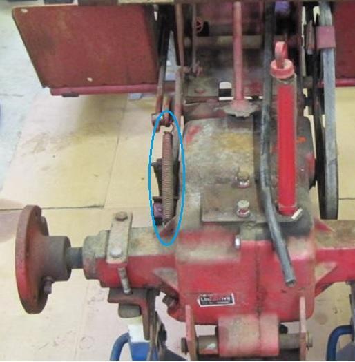

953 nut 68,136 #13 Posted October 28, 2025 You may want to look at the other side of the Wheel Horse to see if the clutch spring needs to be replaced. Share this post Link to post Share on other sites

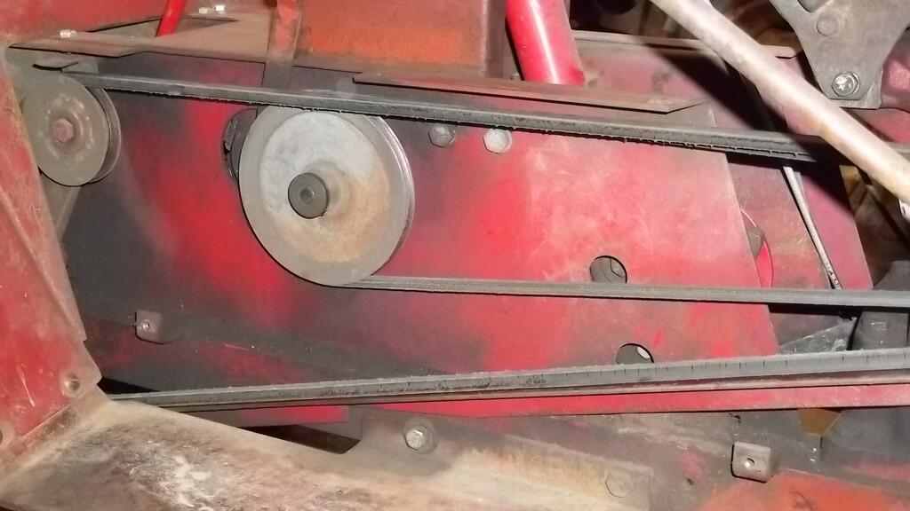

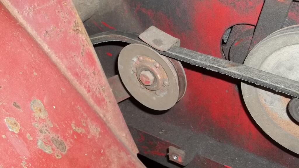

953 nut 68,136 #15 Posted October 29, 2025 Clutch pedal up Clutch pedal down 2 Share this post Link to post Share on other sites

Handy Don 17,186 #17 Posted October 30, 2025 4 hours ago, Farmer Forbes said: Thanks to everyone who provided feedback and pictures; they were most helpful. Tractor is running again after purchasing an after-market v-belt, which by the way was 84 x 5/8 inches. It appears the inside diameter of the belt was more important than the outside circumference. Gears shift fine and I was able to finish my fall plowing. YW 17 hours ago, 953 nut said: Clutch pedal up Clutch pedal down Looks just right from here. Nice! Share this post Link to post Share on other sites
