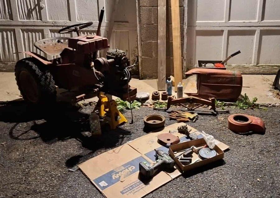

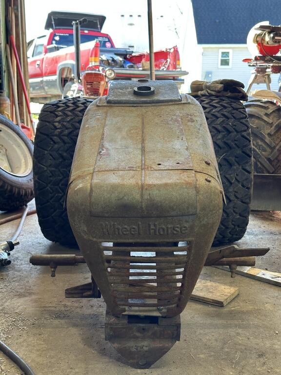

fiftyfordfloored 68 #1 Posted October 21, 2025 My name is John. I have been researching and lurking, finally signed up and thought I would post a hello. Picked up a 633 Round-nose from a nice guy the next state over. Currently working on/restoring. 9 5 Share this post Link to post Share on other sites

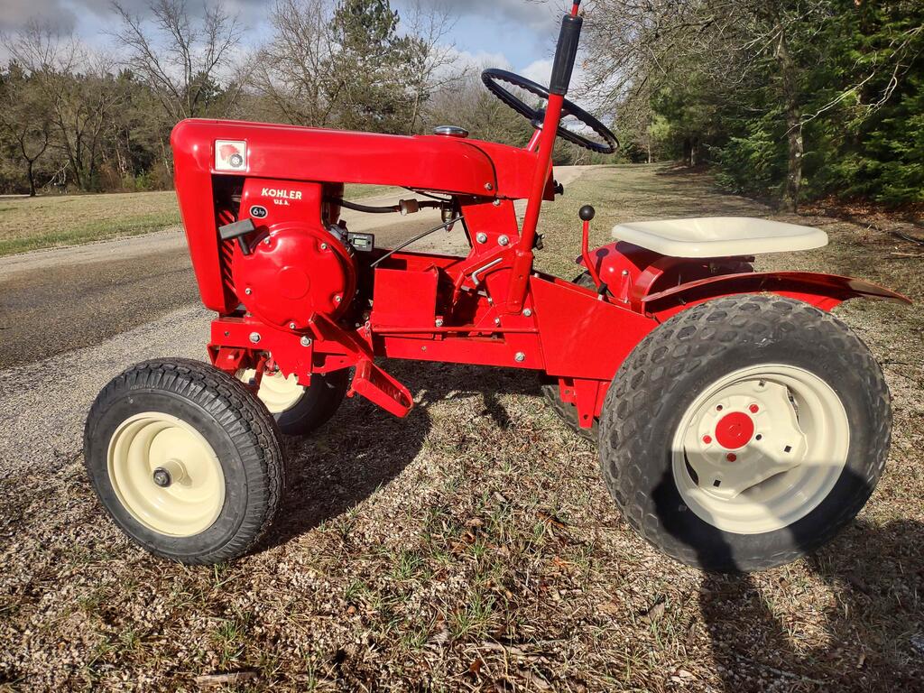

Achto 32,963 #7 Posted October 21, 2025 Nice project. The 633 was one of the only 6hp 's with a Kohler engine. Most of the other 6hp models came with a Tecumseh. I restored my 633 last winter / this spring. Happy to share more pictures or answer any questions you may have. 5 5 Share this post Link to post Share on other sites

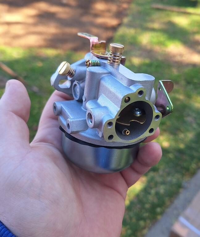

Achto 32,963 #8 Posted October 21, 2025 1 hour ago, fiftyfordfloored said: I noticed that yours still has the up draft carb on it. Great for originality but they can be a bear to deal with. No harm if you wish to switch to a Carter carb. That's what mine has on it. 3 Share this post Link to post Share on other sites

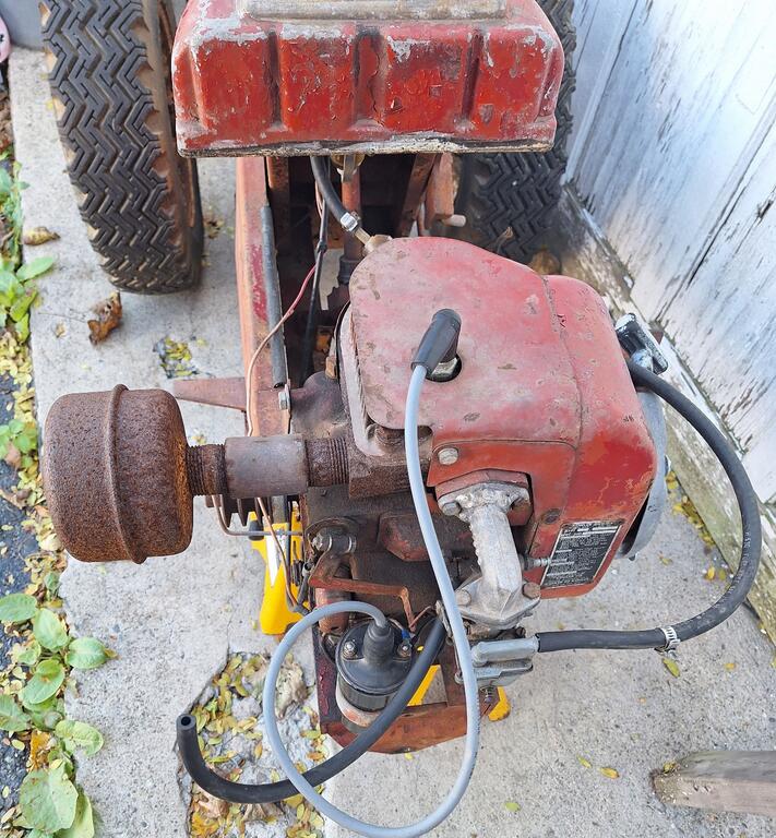

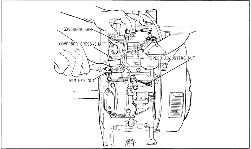

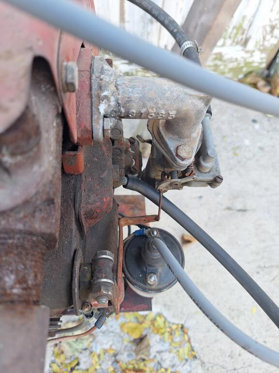

fiftyfordfloored 68 #9 Posted October 21, 2025 25 minutes ago, Achto said: I noticed that yours still has the up draft carb on it. Great for originality but they can be a bear to deal with. No harm if you wish to switch to a Carter carb. That's what mine has on it. Ah haaa.... That is the next step after getting the ignition sorted. The "original carb" needs gaskets and leaks like a sieve ($33+ for a rebuild kit), and someone tried to repair the intake. Looks like the governor arm is all bent... ... ...but it looks like all I need to do is straighten it out, and make up a throttle rod. 2 1 1 Share this post Link to post Share on other sites

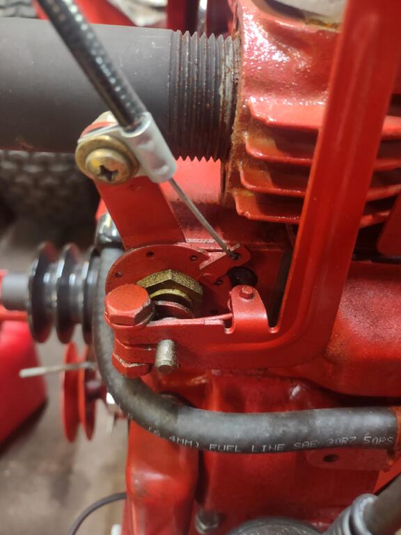

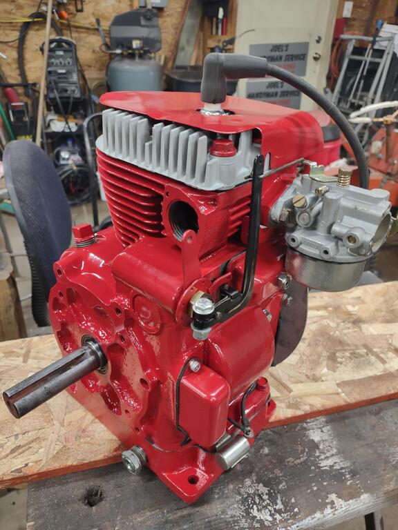

Achto 32,963 #10 Posted October 21, 2025 (edited) 22 minutes ago, fiftyfordfloored said: That pic is for a big block Kohler, but yes you should be able to straiten the governor arm. A pic of mine for reference. Cable connection. Edited October 21, 2025 by Achto 3 2 Share this post Link to post Share on other sites
fiftyfordfloored 68 #11 Posted October 21, 2025 28 minutes ago, Achto said: That pic is for a big block Kohler, but yes you should be able to straiten the governor arm. A pic of mine for reference. Cable connection. Awesome photos for reference, thank you... that engine looks great! 2 2 Share this post Link to post Share on other sites

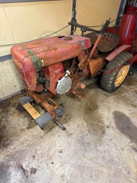

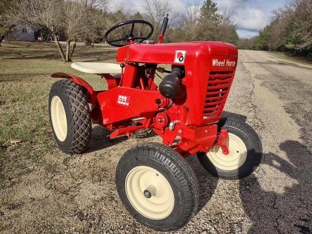

fiftyfordfloored 68 #15 Posted October 22, 2025 One question I did have, it appears this year tractor should have the more square seat from the literature I've seen. Was this farm tractor style seat an option, or was this likely swapped from an older model? Wasn't planning on changing it since it's comfortable and looks cool, just curious. Share this post Link to post Share on other sites
953 nut 70,653 #16 Posted October 22, 2025 21 hours ago, fiftyfordfloored said: first truck was a 50 Ford F-2. Looks like you are well on your way to having your round-hood romping around the yard and a few shows. I had a 1948 F-1 which I street rodded and drove over 100,000 miles. 1 3 Share this post Link to post Share on other sites
Achto 32,963 #17 Posted October 22, 2025 (edited) 32 minutes ago, fiftyfordfloored said: Was this farm tractor style seat an option, or was this likely swapped from an older model? You are correct, the seat has been changed. The correct seat is a square pan like the one on my 633. I like to stay as close to original as I can, but I don't blame anybody that changes out a square pan seat. They are not the most comfortable, I think that's because no body's butt is square. Edited October 22, 2025 by Achto 1 Share this post Link to post Share on other sites
