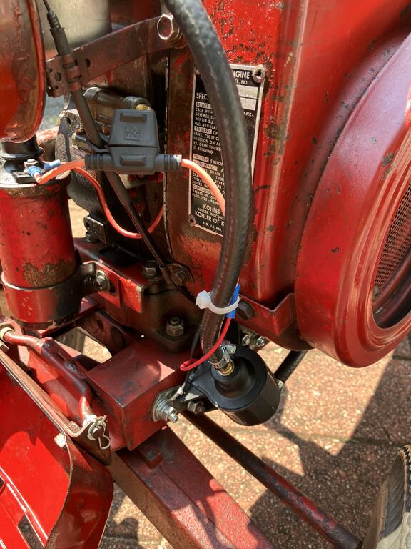

Retired Wrencher 7,043 #6 Posted October 20, 2025 (edited) I have been using this for a few years now. I figured if it’s good enough for lightweight aircraft it’s good enuf to power a Kohler engine. They are a little bit expensive as you can see, but I’ve had good luck with them starts right up. It is one to two psi. Edited October 20, 2025 by Retired Wrencher 3 Share this post Link to post Share on other sites

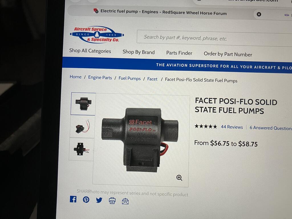

Joefrommi65 26 #7 Posted October 20, 2025 Thanks do you have a part number on that pump as I didn't see it in the picture 1 Share this post Link to post Share on other sites
ebinmaine 81,281 #8 Posted October 20, 2025 4 hours ago, Joefrommi65 said: Thanks do you have a part number on that pump as I didn't see it in the picture 1 Share this post Link to post Share on other sites
ebinmaine 81,281 #9 Posted October 20, 2025 4 hours ago, Joefrommi65 said: Thanks do you have a part number on that pump as I didn't see it in the picture Either of the two Facet pumps I listed above will work fine. 1 Share this post Link to post Share on other sites
sqrlgtr 4,225 #10 Posted October 20, 2025 Facet Cube 12v Fuel Pump, 1/8 NPT, 1.5-2.5 psi Part# FAC-40163 (1.5 to 2.5psi) is one I ordered to use on my 857 but decided to rebuild original fuel pump instead. I ordered this pump before I found the great rebuild kits from Then and Now automotive. I assume this pump I ordered would work fine but like the looks of the pumps that those above have listed better. 1 Share this post Link to post Share on other sites
Retired Wrencher 7,043 #12 Posted October 21, 2025 22 hours ago, Joefrommi65 said: Thanks do you have a part number on that pump as I didn't see it in the picture #60304 when you get on the site you will find a list of all pumps that they make. Depending on your horsepower as I only use it for an 8 hp I chose the 1-to 2 psi 1 Share this post Link to post Share on other sites
