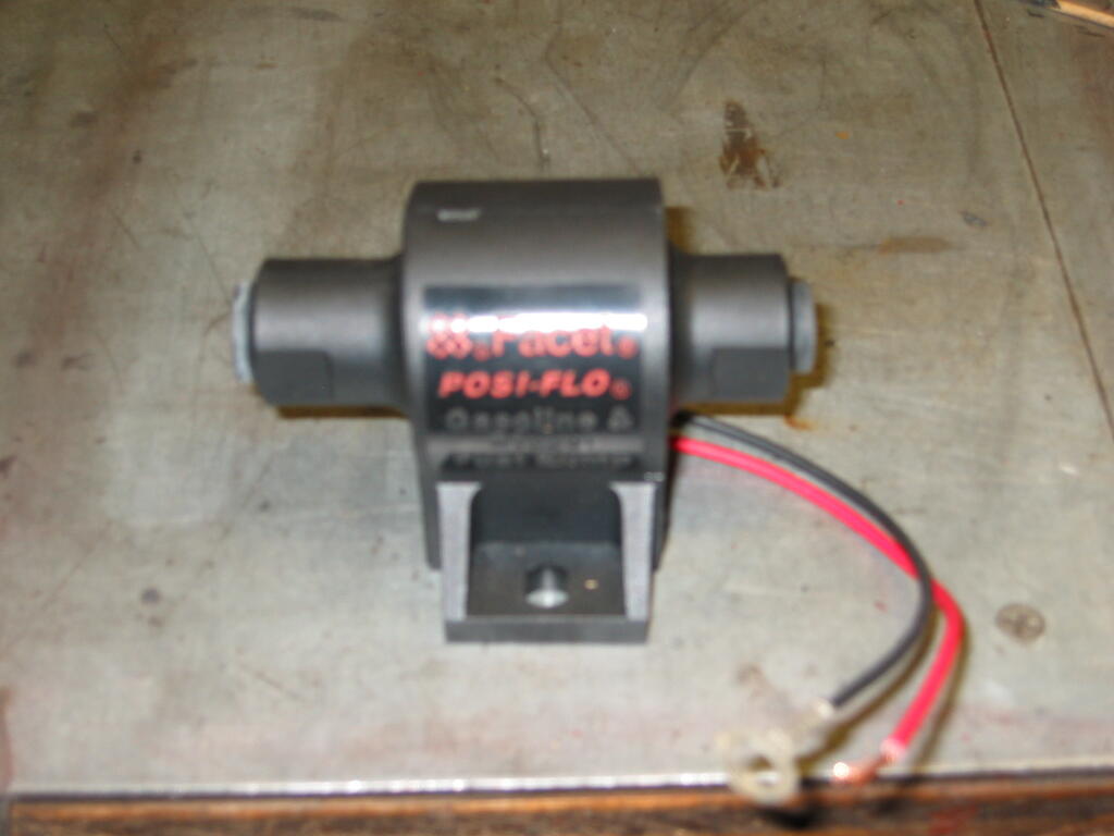

ri702bill 12,106 #3 Posted October 17, 2025 (edited) Paul's picture is worth the thousand words. Short version - low pressure electric fuel pump. My 2 cents. Pull the dipstick, check it for raw gas mixed in wirh the oil. If it is, do not attempt to start it. Drain the oil, fix / replace the fuel pump. Refill with fresh oil. Edited October 17, 2025 by ri702bill 2 Share this post Link to post Share on other sites
kpinnc 18,245 #4 Posted October 17, 2025 I agree with the electric low pressure fuel pump modification. I've added this to every build I've done for several years and they are awesome. One thing to consider: as @ri702bill said, verify whether or not your oil is or is not contaminated. If you don't find gas in the oil, it may have simply drained back into the tank. This is a common issue on tractors that have the fuel tank under the seat. The smallest air leak in the fuel system will allow the fuel to drip back to the tank in just a day or two. If yours is doing the same, and you don't want to install the electric pump, you can add an inline primer bulb. This is also an exceptionally effective modification. Quick starts, which saves your starter, battery, and mental health. 3 1 Share this post Link to post Share on other sites

953 nut 66,091 #6 Posted October 17, 2025 All of my workers and customs have electric fuel pumps, the only way to go in my opinion. Mount the pump lower than the tank and use the power going to your hour meter since it is fuse protected and turns off with the key. 1 Share this post Link to post Share on other sites

mclaugh417 4 #10 Posted October 18, 2025 1 hour ago, 953 nut said: All of my workers and customs have electric fuel pumps, the only way to go in my opinion. Mount the pump lower than the tank and use the power going to your hour meter since it is fuse protected and turns off with the key. That was my biggest worry with going to electric was figuring out where to wire it. Thanks for letting me know about the hour meter detail!! Do most of those electric pumps just have 2 wires? positive and ground? If so, it doesnt sound so difficult after all other than mounting it I guess. Do you have a certain place you like to mount it? I know lower than the tank, but didnt know if through trial and error you have found something that works best? 1 Share this post Link to post Share on other sites

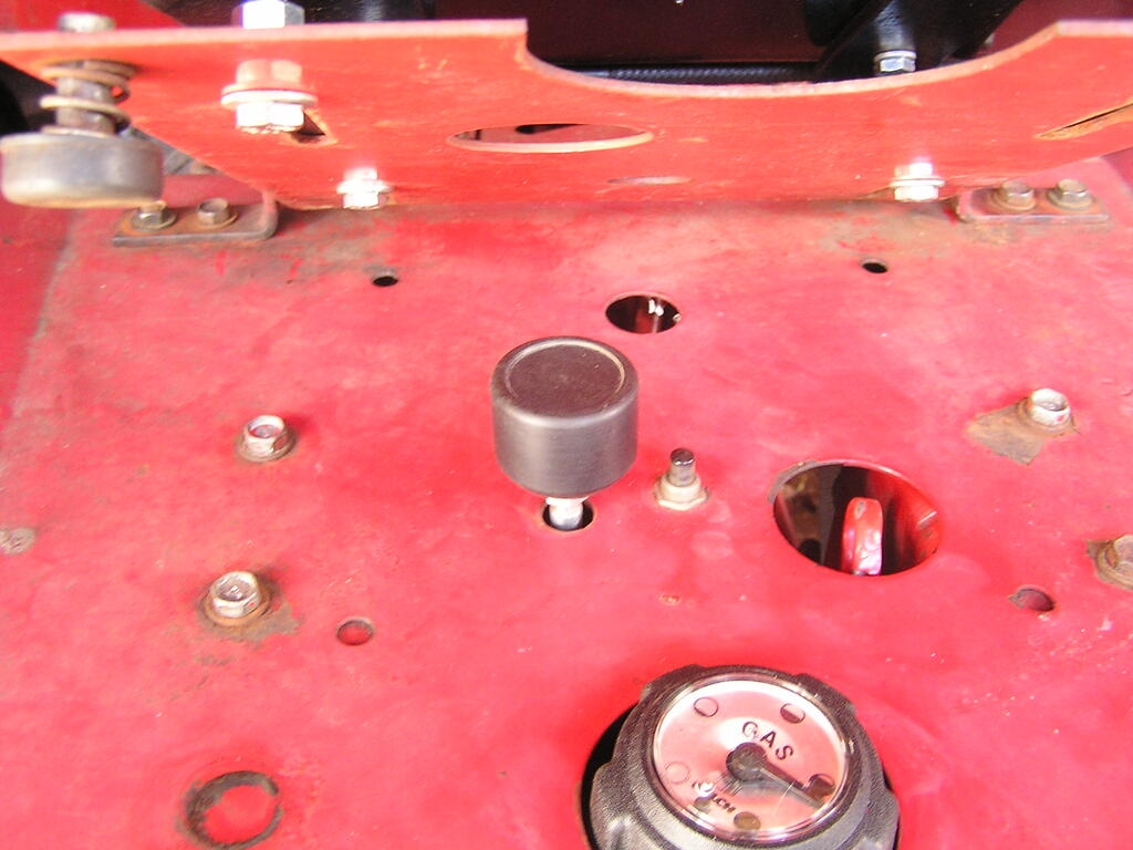

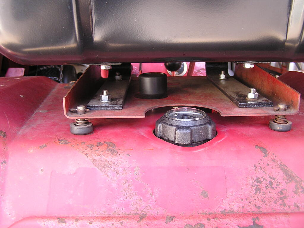

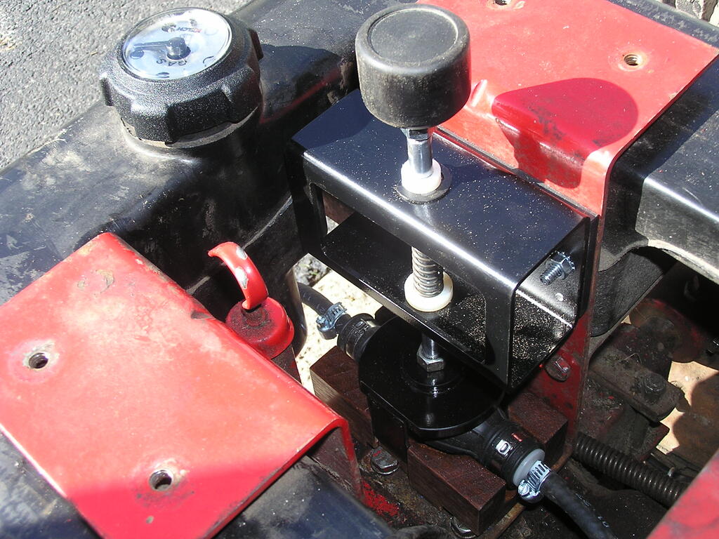

ri702bill 12,106 #16 Posted October 18, 2025 (edited) On 10/17/2025 at 8:56 PM, kpinnc said: Yes, bulb mounted a few inches below the pump. Just out of the way of the left pedal travel. I added a primer bulb to my C81 to aid in starting when the tractor was inactive for a few weeks. I got a tad creative to mount in below the tank, as I have seen too many sketchy applications where it was hanging out near the left pedal just waiting to get snagged on something. Made a cradle & spring return pusher activated under the seat - flip up the seat, a couple of pushes, seat back down, start it up.... Edited October 19, 2025 by ri702bill 1 3 Share this post Link to post Share on other sites
Ed Kennell 46,076 #17 Posted October 18, 2025 3 hours ago, ri702bill said: I got a tad creative Next generation...extend the plunger up to the seat so it squeezes the bulb when you hop on. 2 Share this post Link to post Share on other sites

gwest_ca-(File Mod) 12,234 #20 Posted October 18, 2025 If you get fuel pump power from the hourmeter make sure you connect to the + side of the gauge. Some models ground the hourmeter through a pressure switch. Not running = no oil pressure = no hours added the the gauge. You can connect to the + side of any gauge. You may be required to stop at the RUN position for a few seconds to build fuel pressure on a START. Most times the gauges are not powered on START. 1 1 Share this post Link to post Share on other sites
ri702bill 12,106 #21 Posted October 18, 2025 4 hours ago, Ed Kennell said: Next generation...extend the plunger up to the seat so it squeezes the bulb when you hop on. I actually considered frame mounting it under the left footrest, with the pusher activated from above via a non-connected actuator to allow easier foot rest removal. I was concerned it would be too low (and a lot more work!). Share this post Link to post Share on other sites
