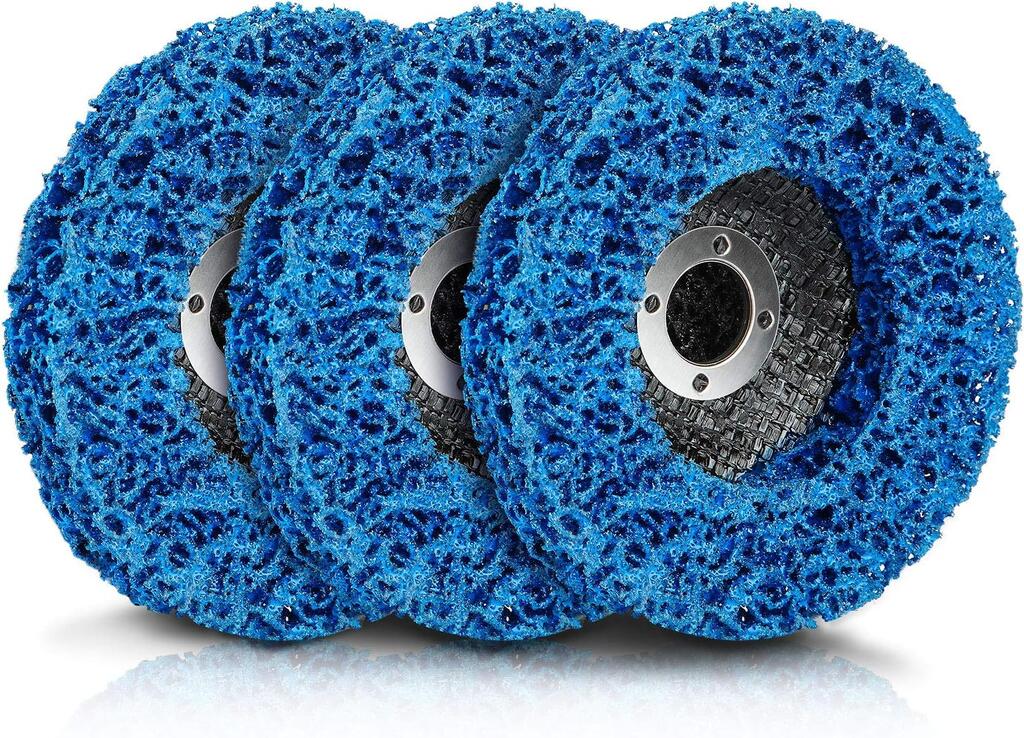

Maz91 296 #20 Posted October 17, 2025 If you go the mechanical route, these are the best at stripping paint in my experience and little to no metal damage 2 Share this post Link to post Share on other sites
Chaz54 99 #21 Posted October 17, 2025 14 minutes ago, Maz91 said: If you go the mechanical route, these are the best at stripping paint in my experience and little to no metal damage What brand, description, etc. are these? 1 Share this post Link to post Share on other sites
ebinmaine 77,973 #22 Posted October 17, 2025 21 minutes ago, Maz91 said: If you go the mechanical route, these are the best at stripping paint in my experience and little to no metal damage 6 minutes ago, Chaz54 said: What brand, description, etc. are these? Agreed. These work excellent for paint or sometimes even rust. 1 Share this post Link to post Share on other sites

Maz91 296 #25 Posted October 18, 2025 10 hours ago, Chaz54 said: What brand, description, etc. are these? That picture was generic from the internet to show the style of disc, but here is the actual one that I have used. I tried every sanding disc and wire wheel I could find and these were the winner. As Eric said they actually remove rust well too. https://www.homedepot.com/p/Avanti-Pro-4-1-2-in-x-5-8-in-11-in-Non-Woven-Quick-Strip-Disc-PNW045STRB01G/202830907 Harbor Freight has something similar but I felt like the avanti ones worked better. I have limited use with the HF discs though. 2 Share this post Link to post Share on other sites
