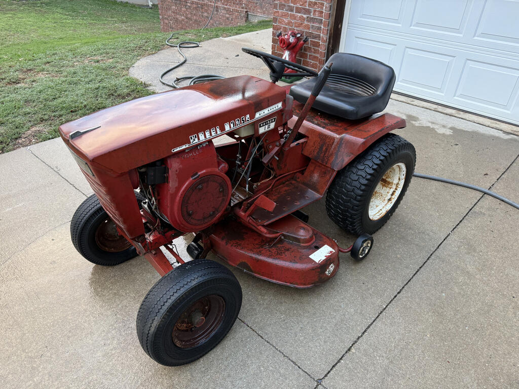

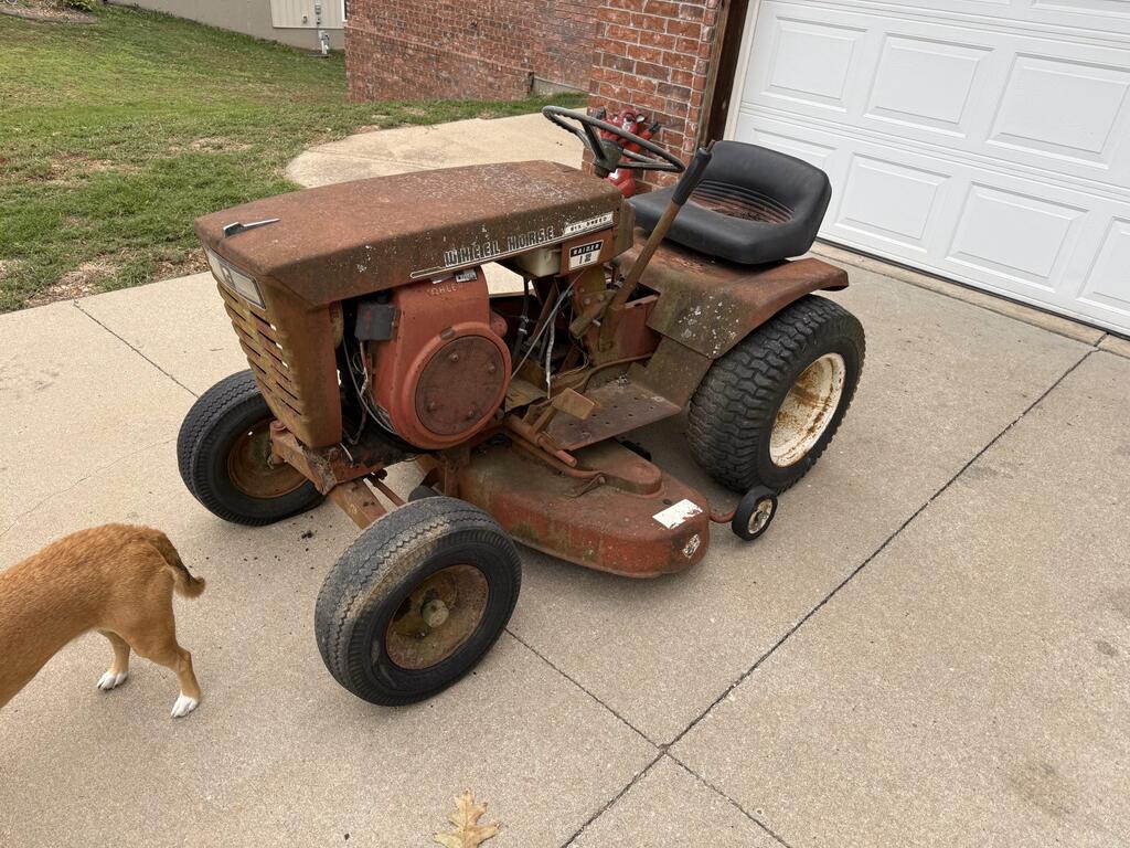

thekevin 51 #1 Posted October 16, 2025 (edited) I just picked this up and I after I power washed it I can't decide if I should paint it or clear coat it the way it is. I have a few days waiting on electrical and fuel parts for it so I need to decide. Edited October 16, 2025 by thekevin 6 6 Share this post Link to post Share on other sites

kpinnc 16,802 #4 Posted October 16, 2025 Yes you did. I'm the worst for always painting my tractors- with varying degrees of success. But if I was gonna go with the patina look, I'd probably just paint the wheels and leave the rest as is. So long as you can protect from rusting more... 5 1 Share this post Link to post Share on other sites
Racinbob 12,566 #5 Posted October 16, 2025 Looks great. What did you use? 1 Share this post Link to post Share on other sites
ebinmaine 76,891 #6 Posted October 16, 2025 In short... don't paint.. yet. If you really can't decide, wait a year. Several points to consider: It's only original ONCE. It isn't like these are super valuable vehicles or pieces of great art but they ARE a part of our history. Here in our Herd we have both fully restored and original "work clothes" tractors. For a looooonng time I've been a "fresh paint" person. So has my S/O Trina. Over the years we've done half a dozen full frame off restorations and several mechanical only builds where we painted only what was necessary. We've both come around to appreciate both types. TIME is going to be a HUGE consideration for you. In order to properly paint a whole tractor you'll need to partially disassemble. Even a "quick repaint" takes many hours to accomplish properly. "Patina" is rust. Period. Rust needs to be stopped. You're already headed the right direction there. We were pleasantly surprised to see how much positive difference wet sanding alone makes. DO wet sand it now. That'll be another positive step because it needs to be done either way. The top coat is your option. At the recommendation of the folks here on Redsquare we've tried Flood Penetrol. Excellent results. IMHO..... wait a year. Let your mind wrap around what you're desires are for the tractor and the amount of work it takes. Maybe you'll get totally enamored with the "work clothes" look. Maybe you'll be completely sick of it by then... 3 2 Share this post Link to post Share on other sites
953 nut 63,782 #8 Posted October 16, 2025 We all like fresh RED paint, but we LOVE an honest patina original paint . In my opinion a clear-coat demises the beauty of patina, just use some WD-40 and fine steel wool to remove oxidation and knock down the rust a bit while celebrating the experiences your Raider has had. 2 1 Share this post Link to post Share on other sites
peter lena 9,667 #9 Posted October 16, 2025 @thekevin personally like the original patina look on the older units, always bring back what's there , like penetrating oil first , for a days long soak in , then a mineral oil rub down , clean oiled cloth . have a multi stage recovery used on all my stuff , most important is , don't rush it , you can easily try a spot / area for effect . regularly maintain my paint , with lubrication . pete 2 Share this post Link to post Share on other sites
Lee1977 7,535 #10 Posted October 16, 2025 Rust don't take a day off around here. Can't remember the last measurable rain, maybe three week ago. Got a fine mist some time last Sunday, noticed a little moisture on the north side windows. Just checked the Humidity meter 56% and climbing. If it less the 1/2" thick and you want to keep it around we paint it. Can't say it helps much but I paint it. The only tractor I haven't painted was my 520-H 95% of the original paint was still there. I did treat the rusted spots and patch paint thoes. I even sanded and painted the inside of the wheel covers. 2 1 Share this post Link to post Share on other sites
thekevin 51 #11 Posted October 16, 2025 6 hours ago, Racinbob said: Looks great. What did you use? scotchbrite pad and some purple power. It’s wet in the second pic. 1 Share this post Link to post Share on other sites
Ed Kennell 44,366 #12 Posted October 16, 2025 Looks great as is. Don't cover that beauty with paint. Maybe a massage with light oil. 1 Share this post Link to post Share on other sites
Handy Don 15,692 #13 Posted October 16, 2025 2 hours ago, thekevin said: scotchbrite pad and some purple power. It’s wet in the second pic. Even I, a “paint first and ask questions later” guy, think that one looks good in its work clothes. 2 Share this post Link to post Share on other sites
1968Commando 171 #14 Posted October 16, 2025 13 hours ago, thekevin said: I just picked this up and I after I power washed it I can't decide if I should paint it or clear coat it the way it is. I have a few days waiting on electrical and fuel parts for it so I need to decide. I’d honestly just keep it EXACTLY how it is I think it looks cool 1 Share this post Link to post Share on other sites
JoeM 9,475 #15 Posted October 16, 2025 I say leave it and wiper her down some kind of shine juice. 2 Share this post Link to post Share on other sites
ACman 7,685 #16 Posted October 16, 2025 I’d just do a Comet/Ajax wash or use 0000 SOS pads then just whatever shine juice you want to protect the that beautiful patina . There’s also satin protectants offered by different companies that are made if you don’t want the shiny look . Here’s a good video of such company and he explains how everything works together . WWW.SWEETPATINA.COM CODE: COTTENCANDY for a discount . 2 Share this post Link to post Share on other sites

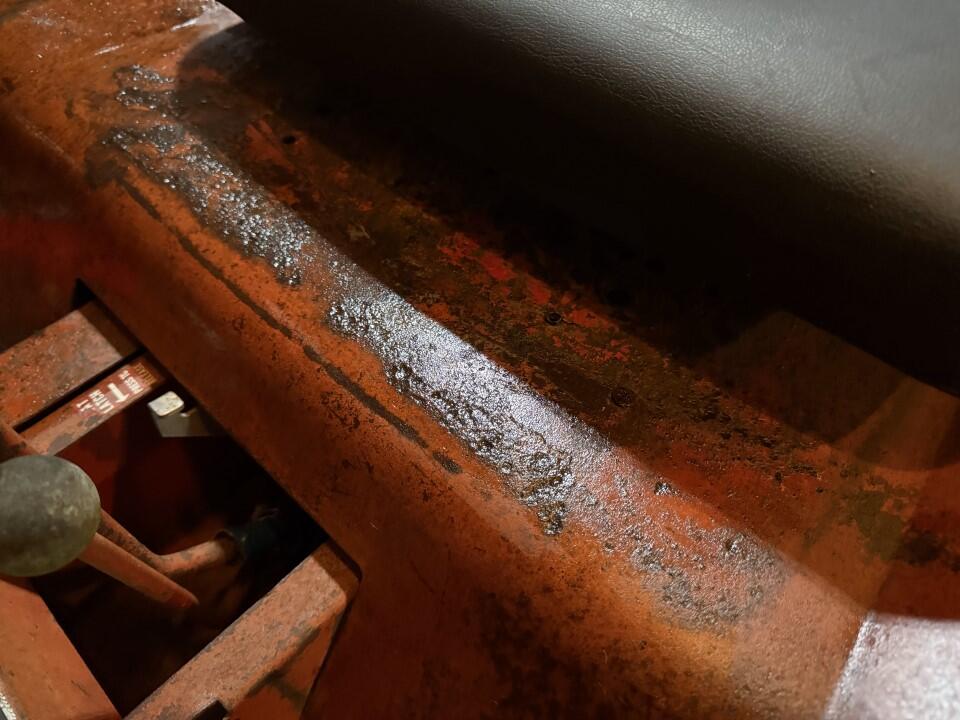

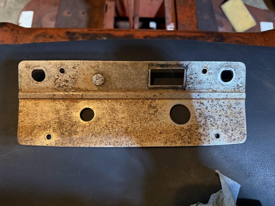

thekevin 51 #17 Posted October 18, 2025 I did a quick wet sand with some 400 grit today and pressure washed it again. I wiped it down with Flood Penetrol and like the way it came out. I didn't do the floor boards because I think I am going to tape them off and spray them with bed liner paint. Under the seat there is quite a bit of rust and hand sanding it didnt really do anything. I may have to hit it with the orbital and paint it. If I do I may just tape off a square and paint it black under the seat. I pulled the dash out and it was pretty rough too. You can't see any of the original lettering really so I will probably just sand it down really good and paint it too. Was it black from the factory? 3 Share this post Link to post Share on other sites
ebinmaine 76,891 #18 Posted October 18, 2025 4 minutes ago, thekevin said: the dash 5 minutes ago, thekevin said: Was it black from the factory Not sure on original color. I've done them in the wheel color. We use Rust-Oleum 2X Cottage white. Or, @Vinylguy Terry sells a decal to cover that metal plate. Used them too. Share this post Link to post Share on other sites

Wheelhorse#1 1,895 #20 Posted October 19, 2025 Personally I’d clean it up and paint the wheels and maybe a fresh set of decals . Nothing like a nicely painted horse but sure is a lot of time and work to do it right. Personally I like the look of a well used horse, shows age,toughness of these ole machines. 1 Share this post Link to post Share on other sites

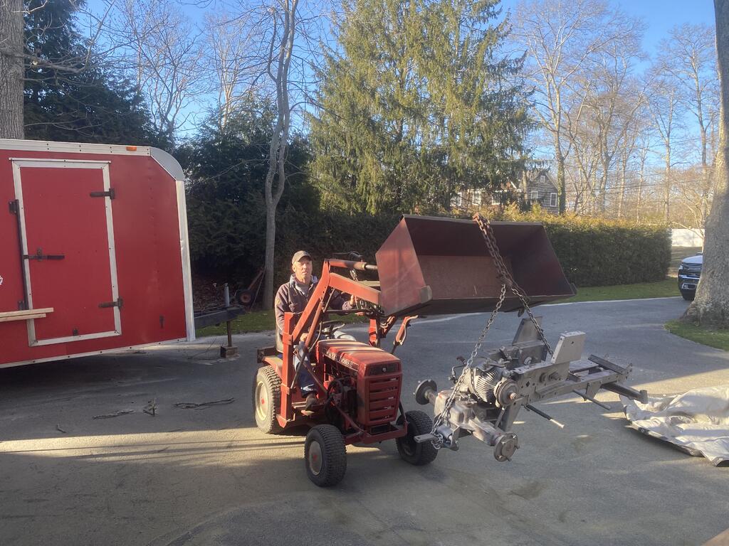

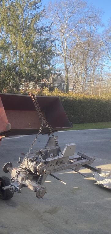

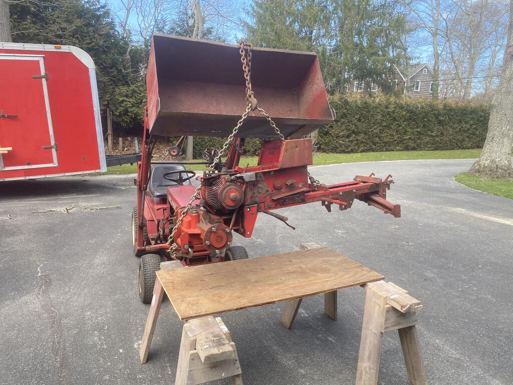

c-series don 11,066 #25 Posted October 20, 2025 Last time I thought I was going to do a freshen up I ended up stripping down to this, then it became a full blown restoration! 1 2 Share this post Link to post Share on other sites
