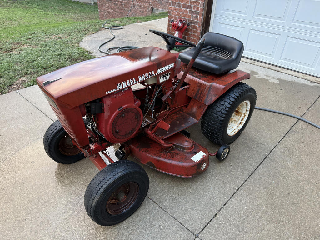

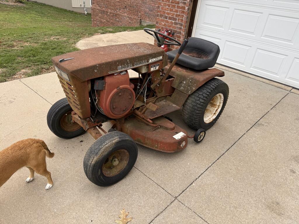

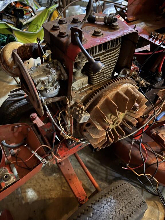

thekevin 51 #1 Posted October 15, 2025 (edited) I drug this thing home yesterday. Not sure how long it had been sitting, but it's been a while. The key ignition was removed and several wires had been removed. I put a new solenoid it and all new wiring for the starter. I ran a jumper wire to the coil for testing but no spark. I pulled the trigger out and cleaned it and put it back in. The motor is a K301 S 47147C. Here are the questions. Does it require the stator to run? the wires coming out of the stator are pretty much destroyed and not hooked in to anything. Should I have to get 12v power to anything other than the coil for it to spark. What should be my next course of action. I am thinking I need to pull the flywheel off and see how bad the stator is. I am not opposed to upgrading or converting the ignition on this to something better if that's what I need to do. I don't want to waste any money trying to fix what's there if I am going to do that though. Edited October 15, 2025 by thekevin fixed pics Share this post Link to post Share on other sites

953 nut 69,333 #3 Posted October 15, 2025 8 hours ago, thekevin said: I ran a jumper wire to the coil for testing but no spark. The ignition system that your Wheel Horse had when it left the factory was a Breaker-less Triggered system as pictured below. Is that what you have? Presuming you have this type ignition, did you run a wire from the battery to the coil? If you did the likelihood is that it is no longer functional. There is a thread on this site covering the conversion of this system to a battery powered ignition system. Share this post Link to post Share on other sites

pfrederi 21,151 #6 Posted October 15, 2025 (edited) I have fixed a couple breakerless systems but the one on my GT-14 refused to work so I converted to Battery points. I couldn't see any of your pictures. There are tests in the Kohler manual to see if it is the coil or the trigger that has failed. I have a good coil that you can have if that is what failed. Triggers are really hard to come by,. Edited October 15, 2025 by pfrederi 1 Share this post Link to post Share on other sites

thekevin 51 #8 Posted October 15, 2025 Ok, I fixed the pics. It is the breakerless system. I just jumped 12v to the wire running back to the coil and verified that it does have 12v at the plug on the coil. I will test the coil with a meter today and see if it tests good or not. Last night I was watching some videos about converting it to points and that seems like the right move. I poured a little bit of marvel in the cylinder to let it sit while I was running the new wires for the starter and solenoid and after 30 minutes did a compression test and it was only 50psi. My goal when I bought this was to use it as a mower but I am little worried about the compression. So far nothing on it has been seized up except the screws that held the fan screen on. The transaxle was completely full of water but everything on it seems to move really smooth. I am going to run a bore scope down in it this evening to make sure but I think its fine. Share this post Link to post Share on other sites
pfrederi 21,151 #9 Posted October 15, 2025 (edited) If you did jump 12v from battery to coil you may have cooked the ignition system..sorry. The breakerless system is like a magneto ignition it generates its own electricity for spark does not need a battery to run, The test for the coil is easy...the trigger test requires a D cell battery and flashlight bulb Edited October 15, 2025 by pfrederi Share this post Link to post Share on other sites

953 nut 69,333 #12 Posted October 15, 2025 5 hours ago, thekevin said: I poured a little bit of marvel in the cylinder to let it sit while I was running the new wires for the starter and solenoid and after 30 minutes did a compression test and it was only 50psi. Your engine has a compression release cam shaft which bumps the exhaust valve open momentarily at cranking speed to allow for easier cranking. Once the engine goes above 50 to 100 RPMs the system allows the valve to remain closed. %) PSI is a fairly good reading. 1 hour ago, thekevin said: new stator and regulator for it so that I can have 100% new wiring and electronics in this thing but I am not sure which one to order. Any help on that. Does it make a difference that I am changing over to a points setup for that? The charging system won't know the difference. You will want to change the ignition switch to a 103990 and the generic diagram below could be helpful. 1 Share this post Link to post Share on other sites
