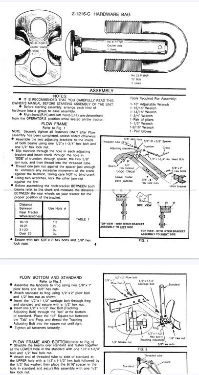

AlexR 3,112 #6 Posted October 13, 2025 Note the rear wheel distance apart and appropriate hole to use. Typically you will probably want to use a middle hole in the 2L position. Also for most plowing you will want to remove a coulter wheel it's only really useful if you are plowing up mowed grass, if the weeds are to long it just gets caught up in it. If it's already a maintained field like a plow day it's just unnecessary. 3 Share this post Link to post Share on other sites
