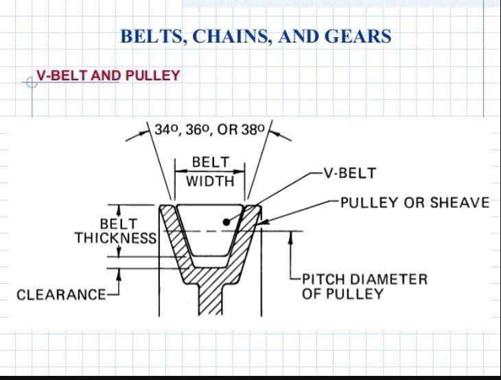

daveoman1966 3,884 #5 Posted October 13, 2025 IMHO--- Your bronco 14 (like mine) is 50+ years old. Get the OEM belt 7478. A few bucks more, but money well spent. While after-market belts may match the width/length, they are not usually geometrically the same and won't last for decades like the OEM belts. Keep in mind---it's only money. gears-and-pulleys.webp Share this post Link to post Share on other sites
