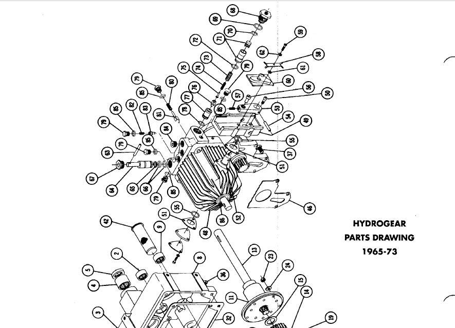

pfrederi 19,278 #4 Posted October 12 You will need a 12pt 1/4" socket. PM me you address i will give you the 2 O rings you will need. Your 1973 Hydrogear Sunstrand is slightly different from the one on Squonks post and uses two O rings. #52 and #55 in the picture. 3 1 Share this post Link to post Share on other sites

Wheelhorse#1 1,890 #7 Posted October 12 11 hours ago, pfrederi said: You will need a 12pt 1/4" socket. PM me you address i will give you the 2 O rings you will need. Your 1973 Hydrogear Sunstrand is slightly different from the one on Squonks post and uses two O rings. #52 and #55 in the picture. Thank you ,very helpful.The leak has gotten pretty bad and since this is my plow tractor I need to get it right . Pm sent Share this post Link to post Share on other sites
