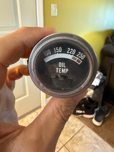

bo dawg 640 #8 Posted October 10, 2025 36 minutes ago, pfrederi said: Is it just your gauge or is it the sending unit that is bad??? Or the wiring?? The electric gauges work by varying the resistance based on heat. Some may see high resistance as being hot some companies gauges may see low resistance as hot.. I assume the gauge is bad and the needle is broke off too. Share this post Link to post Share on other sites

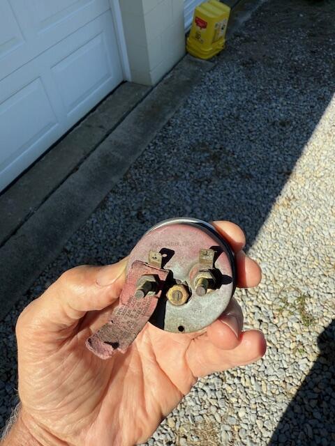

bo dawg 640 #14 Posted October 10, 2025 19 minutes ago, squonk said: I think they used SW gauges from the factory. A lot of equipment manufacturers did. How many prongs does your old one have? I would get the gauge that most closely matches yours. You can probably just buy a new gauge kit complete with the sending unit. you might need to buy a brass adapter to get the correct threads. Share this post Link to post Share on other sites
bo dawg 640 #15 Posted October 10, 2025 19 minutes ago, gwest_ca said: The 3-terminal gauge has the I and S insulated but see no insulation under the 3rd so likely a ground. Would work on a panel not grounded. A 2-terminal gauge would likely work if mounted to a grounded panel. Thanks G! Share this post Link to post Share on other sites

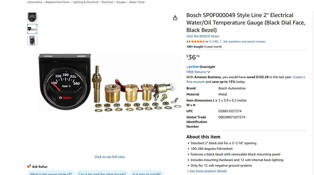

pfrederi 20,819 #19 Posted October 11, 2025 They are 10 - $40 on Amazon. This Bosch one comes with multiple adapters. Some cheap ones don't. Like Richard said why waste time on trying maybe to match your maybe working sending unit. 2 Share this post Link to post Share on other sites
bo dawg 640 #20 Posted October 11, 2025 Thank you guys for the help. Makes sense to replace sender too. Share this post Link to post Share on other sites
