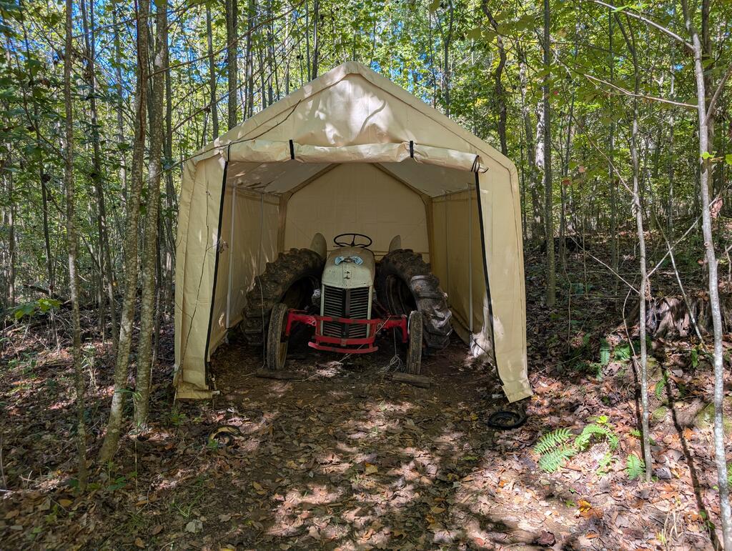

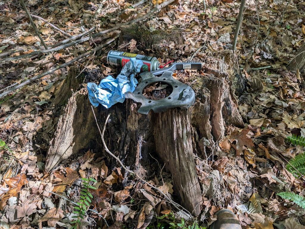

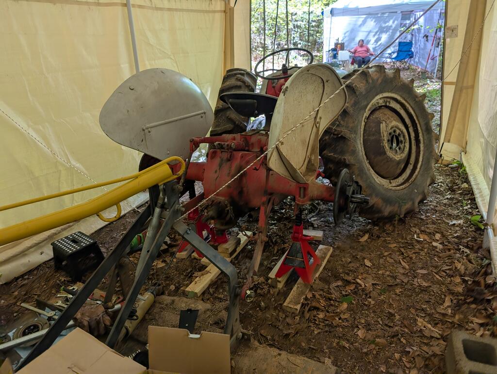

8ntruck 9,420 #1 Posted October 8, 2025 (edited) We are in our Ky. location for a few days. Major goal is repairing the brakes on EJ the 8n. So, Welcome to Deep Woods Tractor Repair: I was expecting to find maybe worn splines on the hubs and bad axle seals. The splines don't seem to be too bad, and the axle seals appear to be in fine shape and to be relatively new. The source of the puddles of gear lube in the brake drums appears to be that the last guy who assembled this thing failed to put the cork gaskets behind the axle seal retaining plates! This let the 90 weight drip out between the axle flange and the seal retaining plate. The brake shoes look to be relatively new as well - ought to, they have been well coated with oil. The brake drums didn't want to come off until I backed off the adjusters A LOT. Both drums have a shoe track worn in them about .040 to .060" deep. Might as well replace the drums while I'm at it. Got to source some, though. One big oopsie, though - the box of brake parts didn't get packed into the truck for this trip. Worst case, I'll replace the missing axle seal retaining plate gaskets with some Form A Gasket, and clean the gear lube off of everything as good as I can get it, then put it all back together. That ought to get me some brakes - for a little while, anyhow. Edited October 8, 2025 by 8ntruck 7 Share this post Link to post Share on other sites

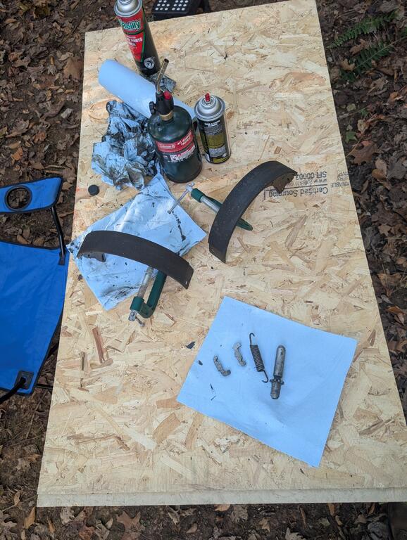

8ntruck 9,420 #11 Posted October 9, 2025 (edited) Brake shoe cleaning day at Deep Woods Tractor Repair: No local source for drums, I found one cork gasket at the Ford New Holland dealer, need 2. So on to Plan C. Clean everything as good as I can, then use Permatex Right Stuff to replace the missing cork gasket. Ought to get the brakes good enough for what I need to do with the tractor. I just need to hold it still on a hill. Edited October 10, 2025 by 8ntruck 2 Share this post Link to post Share on other sites
