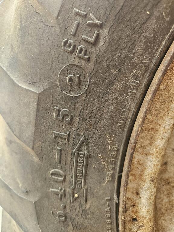

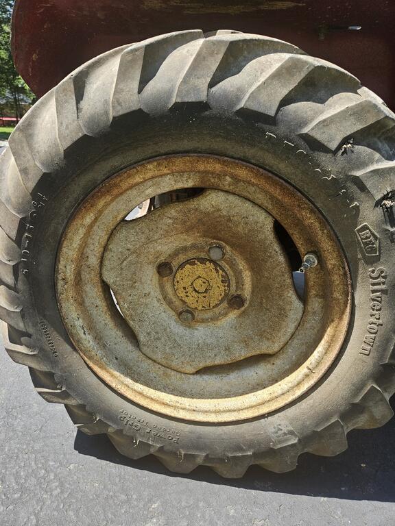

1054 Project 94 #1 Posted October 8, 2025 Looking for suggestions for replacing rear lug tires on a 1054 restoration. Originals are 6.40-15. 1 Share this post Link to post Share on other sites
Pullstart 71,255 #2 Posted October 8, 2025 Are these ones holding air? Decent shape? Miller Tire Paint seems to be a pretty popular product to breathe life into an old tire. 4 2 Share this post Link to post Share on other sites

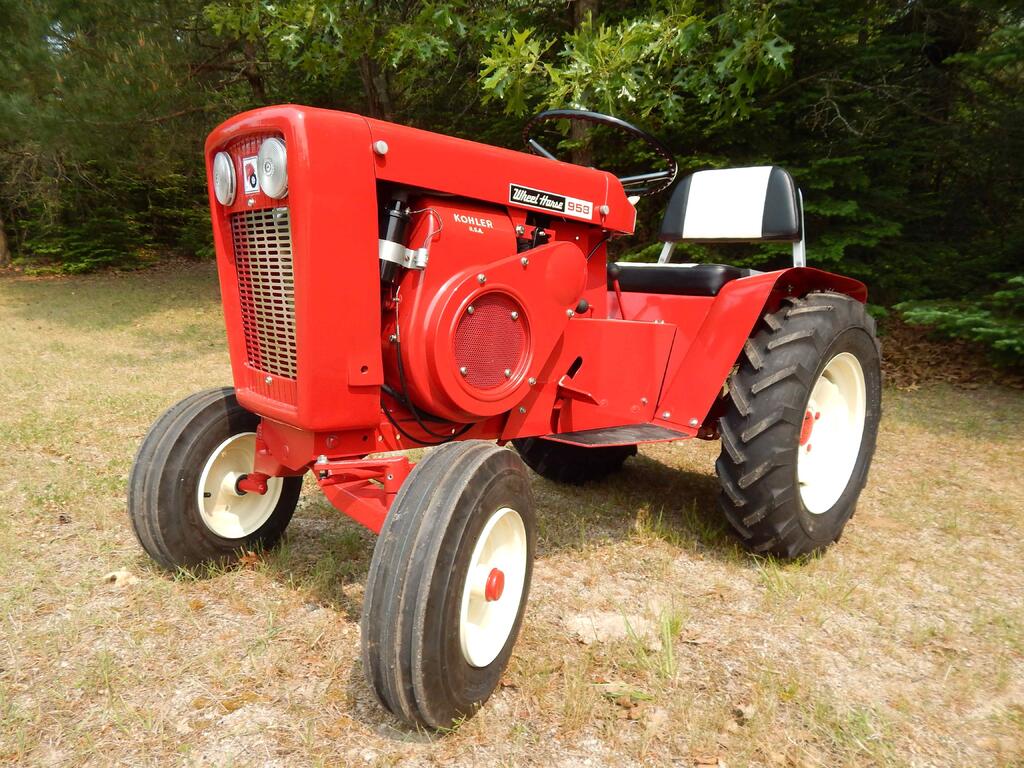

Achto 32,714 #3 Posted October 8, 2025 I have these on my 953. https://www.millertire.com/6-70-15-goodyear-sure-grip-traction-4-ply/ 2 8 Share this post Link to post Share on other sites
1054 Project 94 #4 Posted October 9, 2025 14 hours ago, Achto said: I have these on my 953. https://www.millertire.com/6-70-15-goodyear-sure-grip-traction-4-ply/ These rear tires look great. Are they tubeless? Also kudos for finding those headlight lens! Share this post Link to post Share on other sites
Achto 32,714 #5 Posted October 9, 2025 15 minutes ago, 1054 Project said: Are they tubeless? From the web site. This tire is Tube-type and requires a tube. 17 minutes ago, 1054 Project said: Also kudos for finding those headlight lens! https://wheelhorsepartsandmore.com/product/4126-headlight-lens-4189-o-ring-gasket-headlight-for-1054-wheel-horse/ 2 Share this post Link to post Share on other sites
stevebo-(Moderator) 8,742 #6 Posted October 9, 2025 Clean them up, tube them and run with those. Millers tire paint is great 2 1 Share this post Link to post Share on other sites
Lee1977 7,772 #7 Posted October 9, 2025 (edited) Google 7.60 x 15 R-1 I found three different brands of them. Edited October 9, 2025 by Lee1977 1 Share this post Link to post Share on other sites
