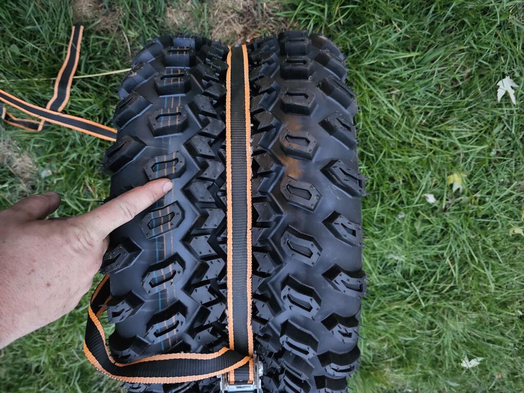

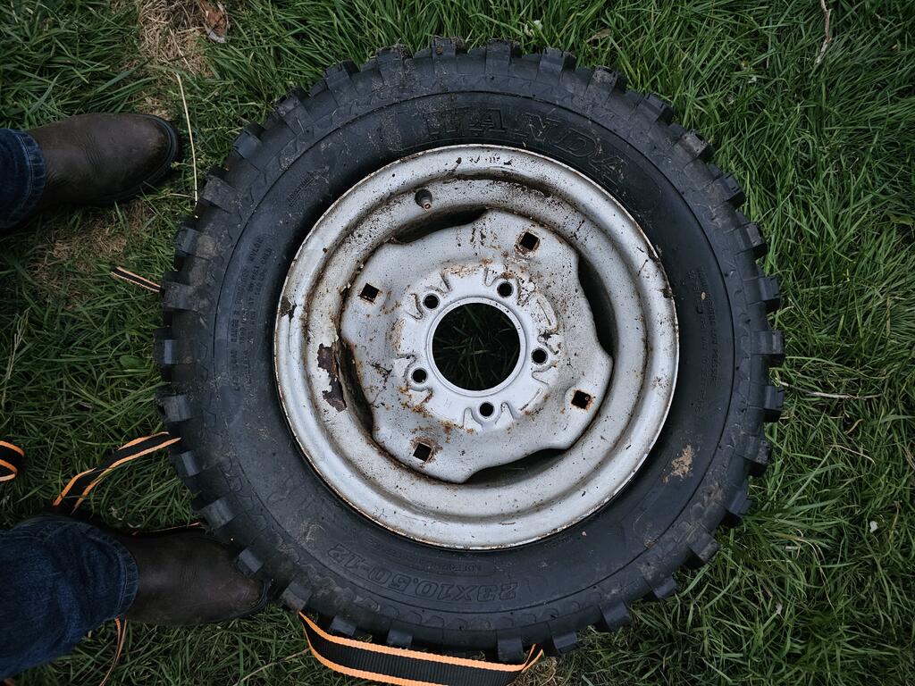

iR8Leprechaun 47 #30 Posted October 19, 2025 Got new tires mounted, not seated, but mounted. Tried everything I have available to get it, going to have to take it to a tire shop and have them blast them. Aside from that, got a pulley on order for it. I also ordered a new oil filter, seeing as the one that was on it decided it was over life. On a completely unrelated note, the engine makes fine oil pressure. Hopefully not so much that it explodes an oil filter. Again, totally unrelated. Getting close to fully operational, just hope I don't run into any more issues with it until AFTER the snow. Share this post Link to post Share on other sites

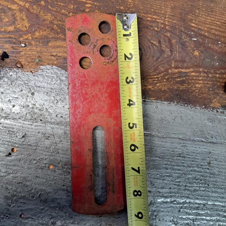

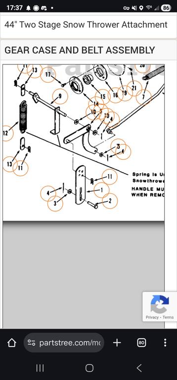

iR8Leprechaun 47 #32 Posted October 23, 2025 On 10/7/2025 at 7:07 PM, JCM said: Nice to see someone saving another 520 instead or parting it out. Good luck with it. Great tractor when properly maintained. I see you have what appears to be the same blower I have. I am missing the lift link that has a slotted hole and 4 holes in the top. Is there any way you could get me some specs on it so I can make one? The part is number 1 in the diagram. 1 Share this post Link to post Share on other sites
WHX?? 58,143 #33 Posted October 23, 2025 On 10/19/2025 at 5:20 PM, iR8Leprechaun said: not seated, but mounted. Tried everything I have available The tie down trick did not work? Always works for me unless the tire is really bad from shipping. I may have that link for sale or can at lease get you the dims. Share this post Link to post Share on other sites
iR8Leprechaun 47 #34 Posted October 23, 2025 45 minutes ago, WHX?? said: The tie down trick did not work? Always works for me unless the tire is really bad from shipping. I may have that link for sale or can at lease get you the dims. Tie down AND starter fluid trick combined didn't even work. Tire shop got it though. I am pretty sure that is the only part that is missing. Should have seen my face after dragging that heavy pig out of the bushes and getting it all hooked up, only to find out I couldn't lift it. I was a bit perturbed. Besides maybe a few pins and a spring, I think that is the only thing I need to get it going. I appreciate you. Share this post Link to post Share on other sites

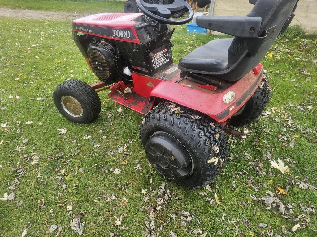

iR8Leprechaun 47 #35 Posted October 23, 2025 A picture with the new tires, because I know how we all feel about pictures. For anyone wondering, I almost pushed over a 4-5" sumac tree testing out the hydro system. The tires almost didn't give up the traction. They should do great in the snow. 3 Share this post Link to post Share on other sites

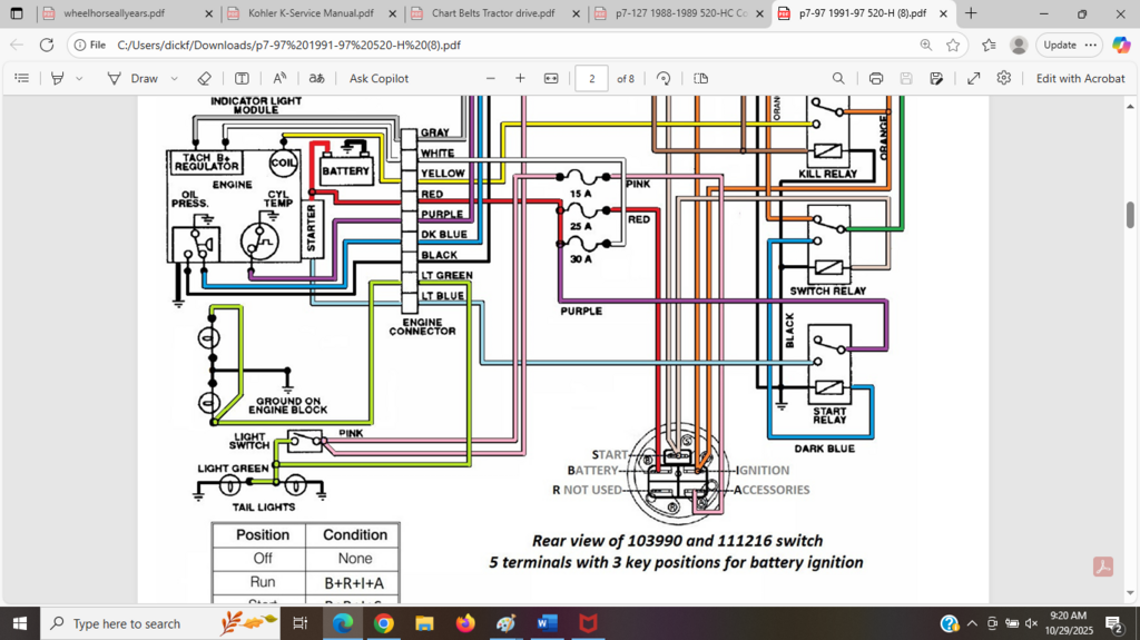

iR8Leprechaun 47 #36 Posted October 28, 2025 Intermittent electrical issues are enough to make you lose your mind. Keep popping the 25 amp fuse. I have gotten into everything except the relays. I just can't figure out what would be grounding out. This is probably going to be a job for the spring. I didn't see any frayed wires for the seat switch, and it only seems to pop when I'm moving quick, or making direction changes. Put a new fuse in and it is immediately fine, don't even touch anything. I just feel like it is a really easy fix, but I've looked at it so long now that it doesn't make sense anymore. Share this post Link to post Share on other sites
953 nut 69,339 #37 Posted October 29, 2025 18 hours ago, iR8Leprechaun said: Keep popping the 25 amp fuse. I have gotten into everything except the relays. I just can't figure out what would be grounding out. Back away from the relays, they are not the problem. The 25 amp fuse is between the 9 pin connector and your ignition switch. Closely examine that RED wire to and from the fuse, the fuse holder, the connection at the ignition switch and the 9 pin connection itself. It doesn't take a whole lot of corrosion to upset your electrical system. 2 1 Share this post Link to post Share on other sites
Handy Don 17,474 #38 Posted October 29, 2025 I suspect you’ll ultimately find insulation on a connector or wire that is permitting a short to ground. It only takes a moment of contact to toast a fuse! If the red wire check comes up dry, start on the runs from the Ignition switch from the Ignition terminal. Yes, a damaged relay could have a short internally, but that’s a low probability IMHO. 2 Share this post Link to post Share on other sites

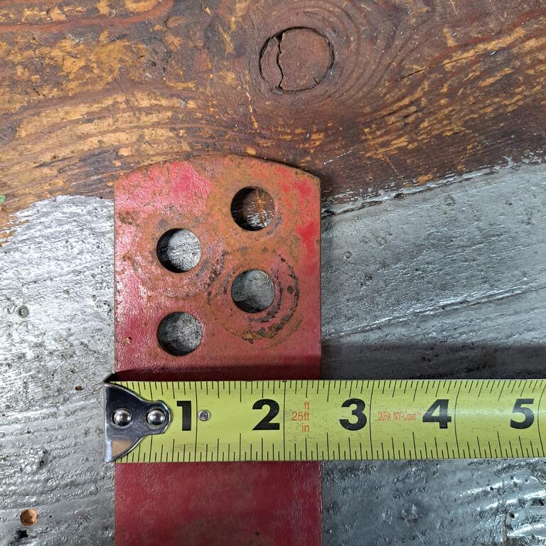

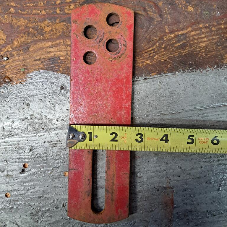

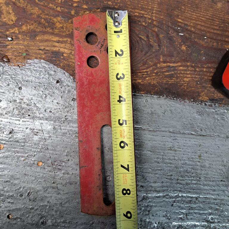

WHX?? 58,143 #39 Posted October 29, 2025 (edited) Here's the lift link dims. The holes & slot are are about 9/16. 1/4 plate steel should do it. I wouldn't be afraid to drill a few more of the round holes for more adjustability. Mine doesn't lift very high and when it does it's crooked. Problem is to get it to lift higher it won't lower proper. Lemme know if you need more. This one is off a parts deuce that I don't know if I want to part out or not. Seems to be in pretty good shape so might try and sell at the BS as all there. Edited October 29, 2025 by WHX?? 3 Share this post Link to post Share on other sites
iR8Leprechaun 47 #40 Posted October 30, 2025 11 hours ago, 953 nut said: Back away from the relays, they are not the problem. The 25 amp fuse is between the 9 pin connector and your ignition switch. Closely examine that RED wire to and from the fuse, the fuse holder, the connection at the ignition switch and the 9 pin connection itself. It doesn't take a whole lot of corrosion to upset your electrical system. I took the plugs apart and hit them with a wire brush and dielectric grease. I know the fuse blocks are notorious for being trash, so I'll probably end up throwing a homemade version up. 8 hours ago, Handy Don said: I suspect you’ll ultimately find insulation on a connector or wire that is permitting a short to ground. It only takes a moment of contact to toast a fuse! If the red wire check comes up dry, start on the runs from the Ignition switch from the Ignition terminal. Yes, a damaged relay could have a short internally, but that’s a low probability IMHO. I agree, relays are seldom the problem. I was thinking ignition side, but I'll wait and see of the terminal cleaning I did helps. 2 hours ago, WHX?? said: Here's the lift link dims. The holes & slot are are about 9/16. 1/4 plate steel should do it. I wouldn't be afraid to drill a few more of the round holes for more adjustability. Mine doesn't lift very high and when it does it's crooked. Problem is to get it to lift higher it won't lower proper. Lemme know if you need more. This one is off a parts deuce that I don't know if I want to part out or not. Seems to be in pretty good shape so might try and sell at the BS as all there. You. Are. Awesome! Thank you so much. I was starting to think this part was a red herring. 1 Share this post Link to post Share on other sites

Handy Don 17,474 #43 Posted October 30, 2025 (edited) 19 hours ago, WHX?? said: Here's the lift link dims. This seemingly simple piece of bar with some holes illustrates some very clever and efficient engineering! Edited October 30, 2025 by Handy Don 1 Share this post Link to post Share on other sites

iR8Leprechaun 47 #46 Posted November 2, 2025 This electrical stuff is killing me. I replaced the fuse block and fixed the connector. Fired it up. Put in gear and it popped the same fuse. So that pointed me to the drive interlock switch. I unplugged it and turned the key, it popped as soon as I did it. The light blue wire from the drive neutral position switch grounds out regardless of key position. Share this post Link to post Share on other sites
iR8Leprechaun 47 #47 Posted November 3, 2025 While I was searching for the problem, I found the battery wire to the ignition switch was also broken. The terminal in the plug to the switch was broken, so it looked fine and had continuity, but it was initially missed. I only noticed that because the headlights were flickering when I was moving the wire bundle. So I fixed all of that, rechecked all of the terminals, and figured that was the problem. Nope! Popped it again. I had the seat flipped up because I lost a socket under it. When I replaced the fuse, and turned the key again, I saw the faintest flash come from under the seat pan. I removed the seat and pan and started looking. None of the wires showed any signbof damage exept the fuel sending init wire. So I put another fuse in (I'm using 15 amp fuses for troubleshooting) and started moving stuff. Of all of the things, it was the taillights. The wires were on the bell crank and whenever they would touch the tail light wire and it would arc through the insulation, no visible damage or anything. It was strange. I cut out the factory splices and did my own. I also installed new tail lights i got at. Just a simple oval red marker light. Put it all back together and drove the snot out of it. Put an hour on it and it seems to be fixed. To look at the wiring diagram, I don't see how the 25 amp fuse was blowing from the tail light, but it was. 1 Share this post Link to post Share on other sites
