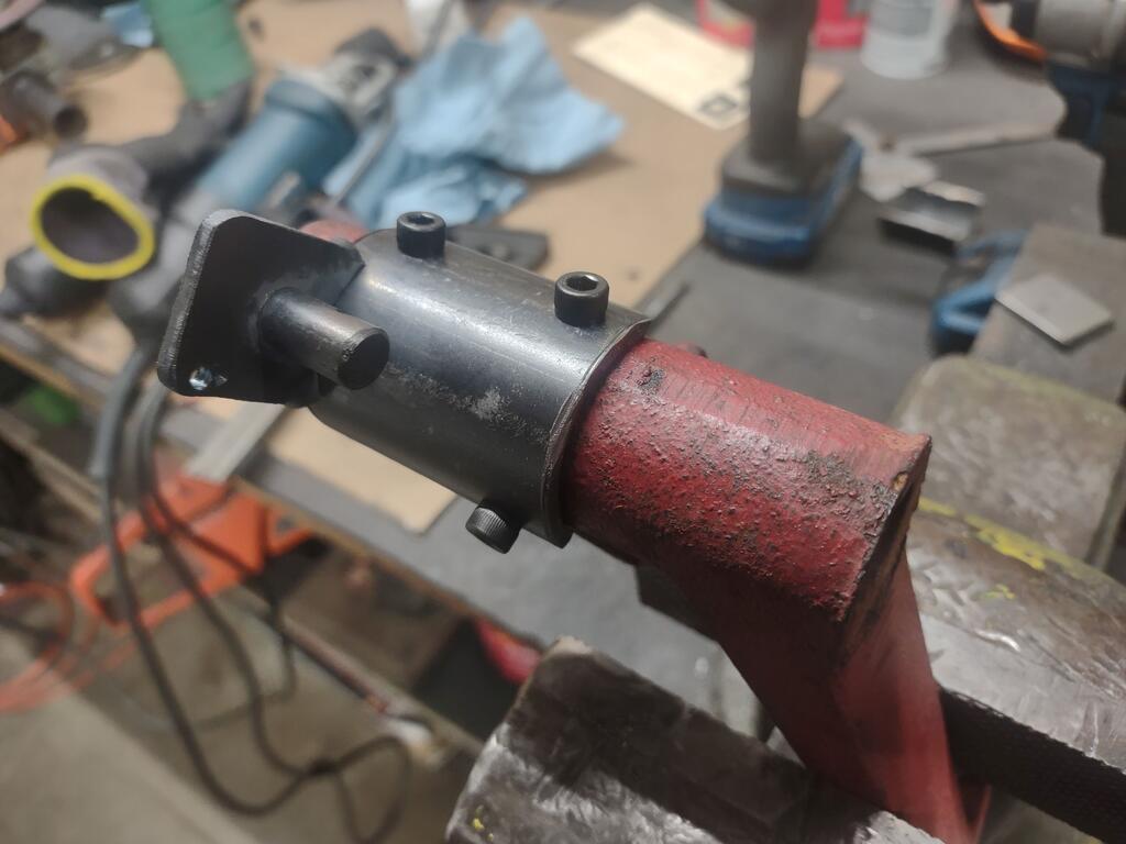

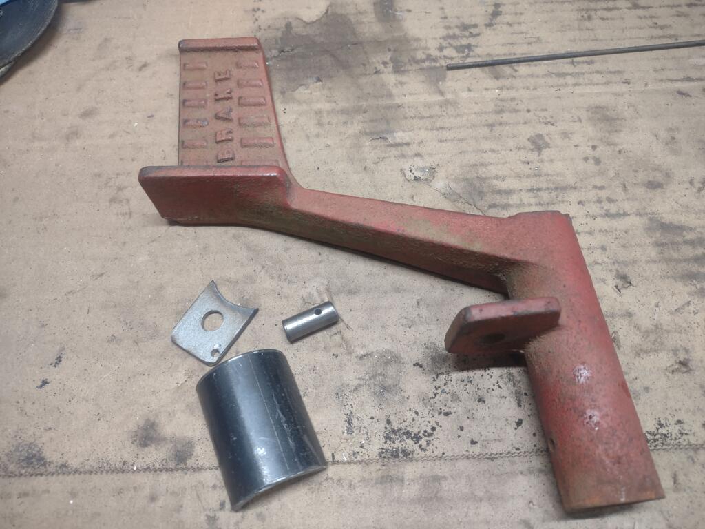

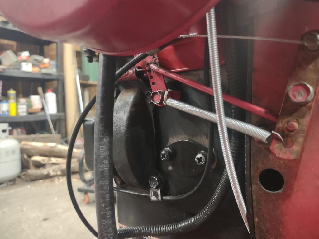

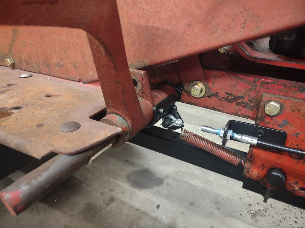

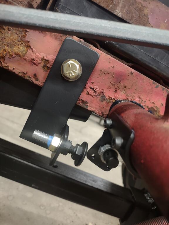

Achto 32,715 #3 Posted October 7, 2025 (edited) 23 minutes ago, carlosking450 said: Hello again everyone from Spain, I would like to put a foot accelerator on my 702. Has anyone done it or is there a topic explaining it? Here is one option. Aquí hay una opción. https://www.speedwaymotors.com/Speedway-Cast-Aluminum-Accelerator-Throttle-Pedal-Assembly,1170.html My C141 pulling tractor had a separate brake peddle that I turned into a throttle peddle. Pics are in reverse order. Mi tractor de tiro C141 tenía un pedal de freno independiente que convertí en pedal de aceleración. Las fotos están en orden inverso. Adjustable peddle stop Tope de pedal ajustable Edited October 7, 2025 by Achto 6 Share this post Link to post Share on other sites
