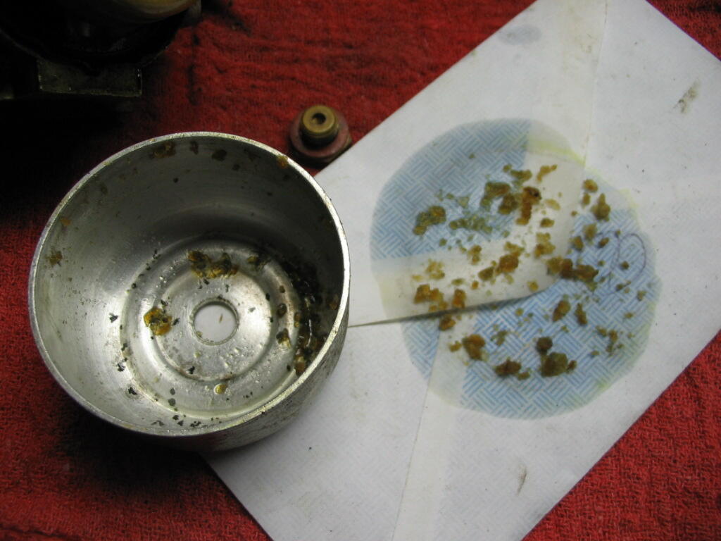

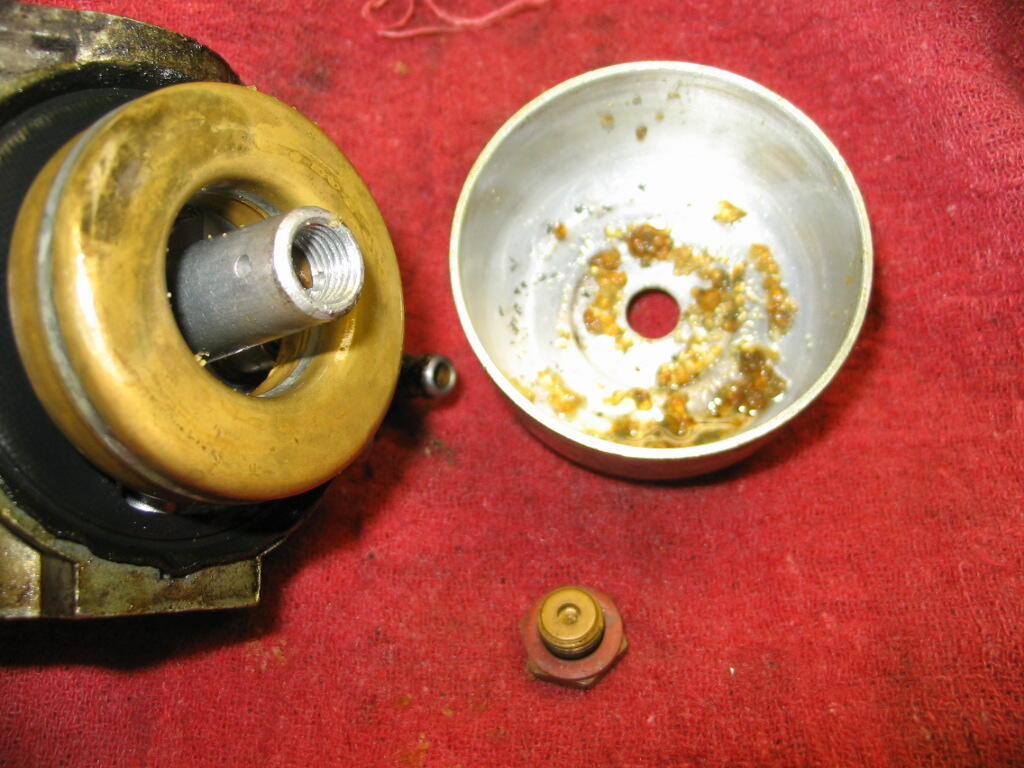

daveoman1966 3,882 #8 Posted October 6, 2025 Stabil is not very stable. Here is what the carb bowl looked like after only a couple of months. That yellowish stuff has the texture of gummy bears and really messed up the whole carb. I no longer use any sort of fuel additive...just buy non-ethanol gas is the solution. This is the carb from a K241s engine. 3 1 1 Share this post Link to post Share on other sites

RED-Z06 2,716 #23 Posted October 8, 2025 Seafoam is the same active ingredients as MMO...pale oil/Naptha..its just a petroleum distillate. Stabil can help in large storage quantities but if it goes bad in a carburetor its worse than if untreated. I use Chevron Techron fuel system cleaner, its the only product GM authorizes for cleaning the fuel senders in C5 vettes (its a 17 hour job to pull the tanks on a lift), and Techron usually resolves the problem in a few miles. I put stabil 360 in my 5.5g cans but if the fuel goes past 9 months it goes in the truck and gets replaced. I dont trust any stabilizer past 9-10 months. I use ethanol fuel in everything. I dont typically have any issues, you just have to periodically start stuff and keep fresh fuel in the carburetor, because thats the fuel that will go bad first Share this post Link to post Share on other sites
