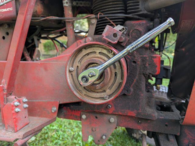

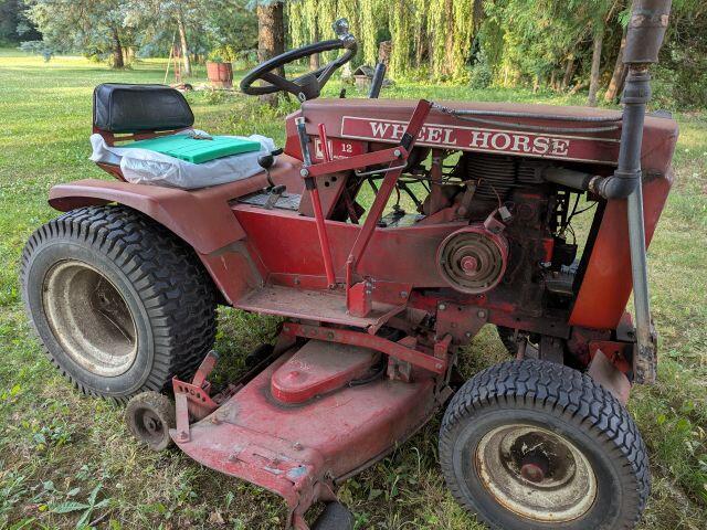

Phan 68 #1 Posted October 4, 2025 Hello - It runs pretty strong! However, its PTO the cover was removed (I still have it) - Sadly, the owner passed away. Can anyone please advise me on how to reattach it back (I tried to unscrew but was very tigh) and test if it still works. Thank you! Share this post Link to post Share on other sites

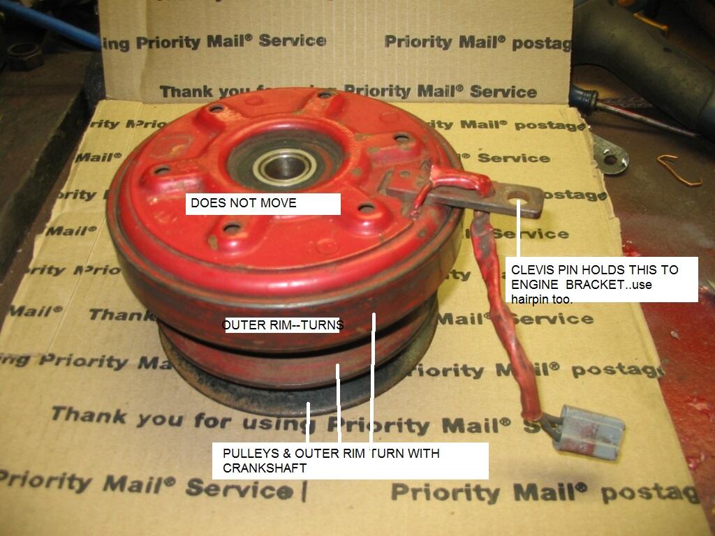

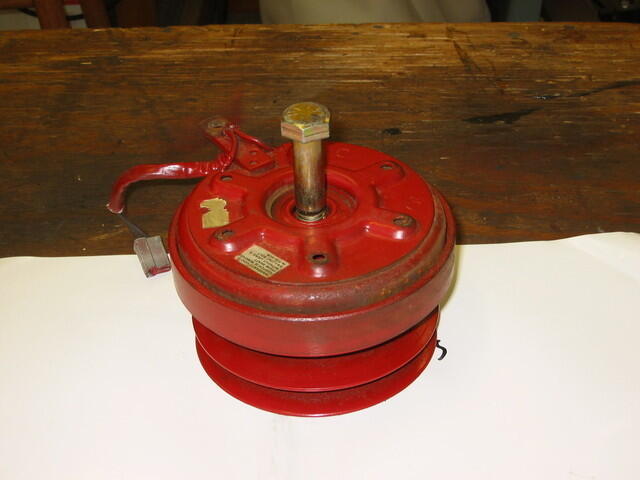

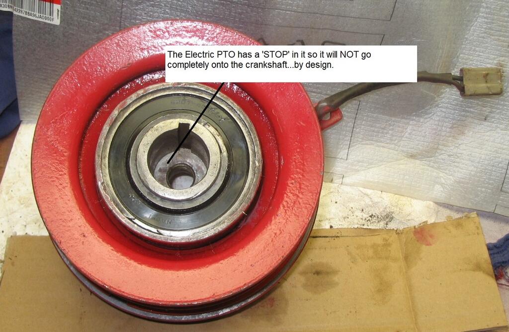

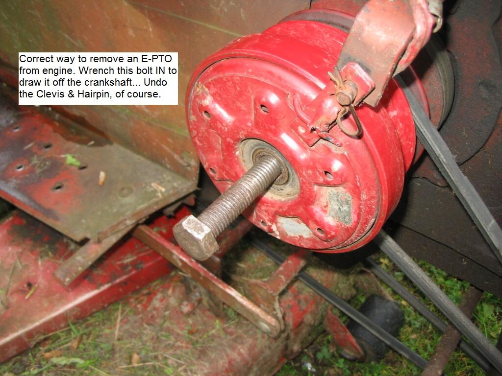

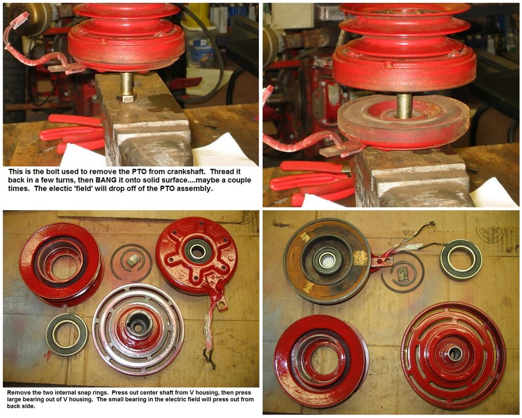

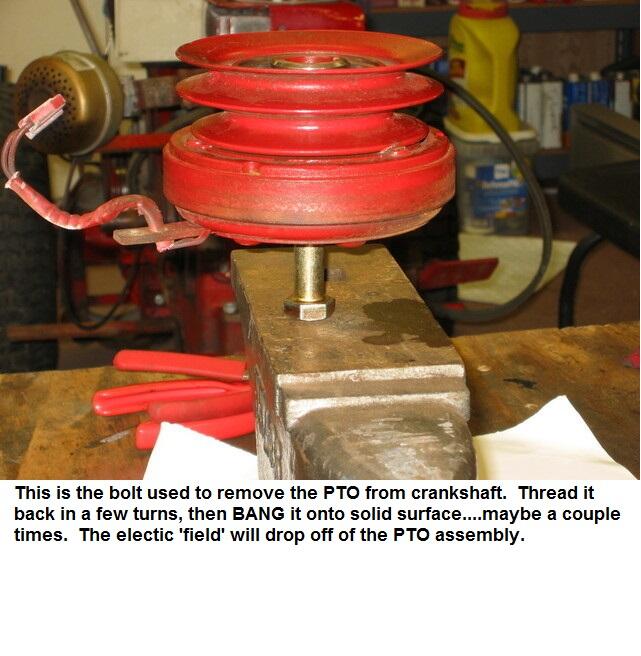

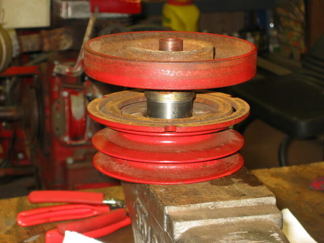

daveoman1966 3,884 #9 Posted October 6, 2025 There is ONE safe way to remove the ENTIRE Dlectric PTO clutch: here it is: Removing it with any sort of 3-jaw puller or the like will just about guaranteed destruction.. (Don't ask me how I know that.) 2 1 Share this post Link to post Share on other sites
