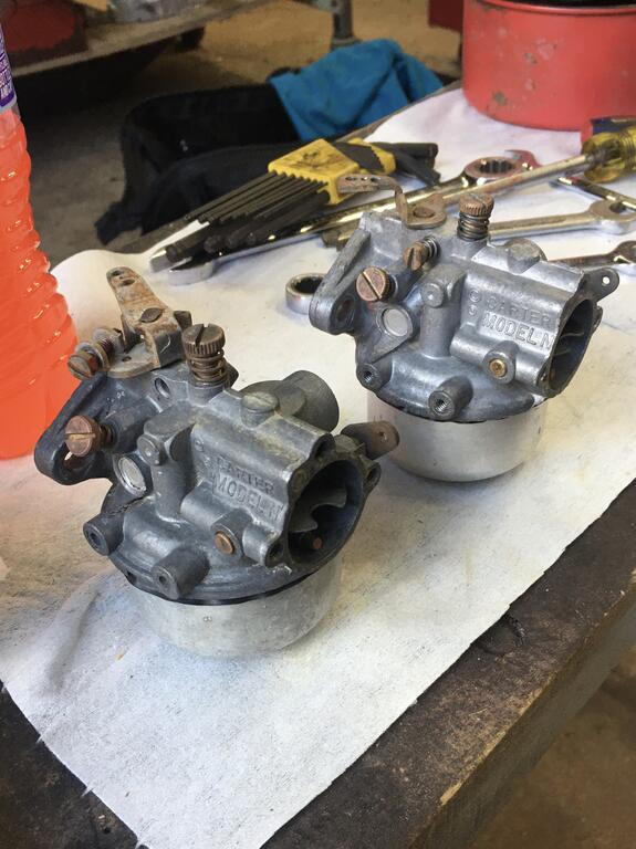

sqrlgtr
Forgot pic of the 2 N carbs. I like pics lol
Those carbs today are like gold. Hard to find a real carburetor today that will work on your engine. And if you do find one, they’re big dollars. Glade you saved them.
  • Like 1
  • Excellent 1
