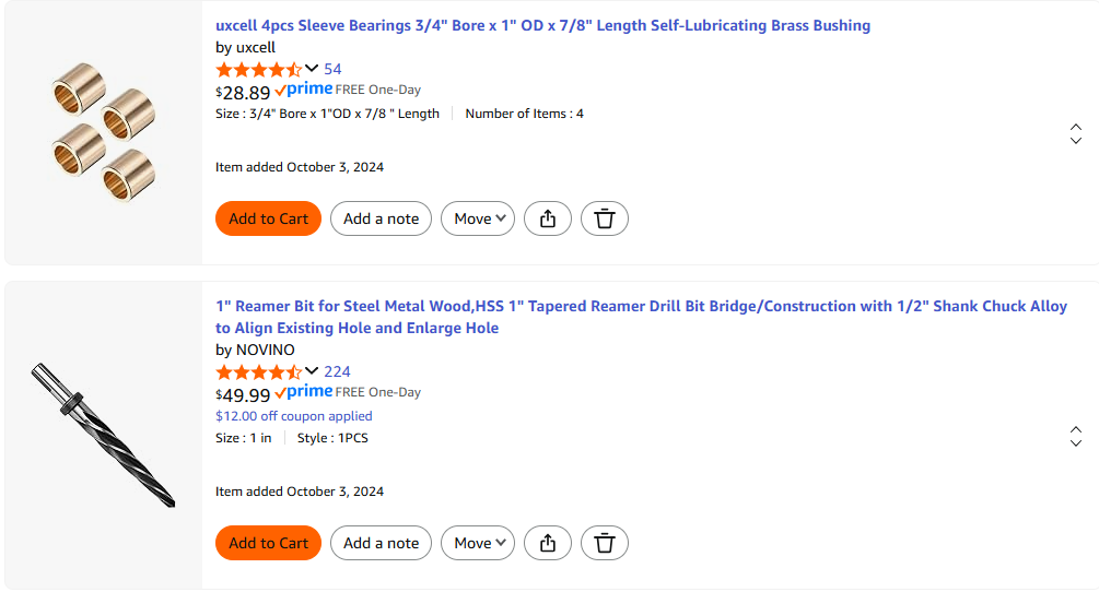

ebinmaine 80,714 #2 Posted October 2, 2025 I'm not sure I could answer you with a particular specification but you want it to be as close to zero as possible. At the recommendation of the folks here on the site, several years ago I bought a 7/8 reamer along with appropriate 3/4 ID bushings. Make sure you get the flanges as thin as possible. 1 Share this post Link to post Share on other sites
Bar Nuthin 3,242 #3 Posted October 2, 2025 (edited) 3 minutes ago, ebinmaine said: I'm not sure I could answer you with a particular specification but you want it to be as close to zero as possible. At the recommendation of the folks here on the site, several years ago I bought a 7/8 reamer along with appropriate 3/4 ID bushings. Make sure you get the flanges as thin as possible. Yes, I've been considering this. Just checking to make sure my OCD isn't causing me to overreact. Edited October 2, 2025 by Bar Nuthin added photo 1 Share this post Link to post Share on other sites
Bar Nuthin 3,242 #4 Posted October 2, 2025 5 minutes ago, Bar Nuthin said: Yes, I've been considering this. I think I'll look for a short piece of 3/4" rod to use as a gauge to decide how much of the play is from the spindle vs the axle. 2 Share this post Link to post Share on other sites
ebinmaine 80,714 #5 Posted October 2, 2025 Center pins are easily reproduced as well. Share this post Link to post Share on other sites

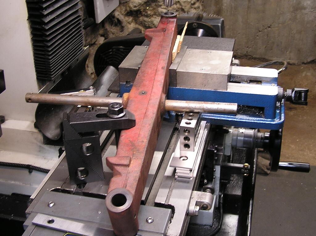

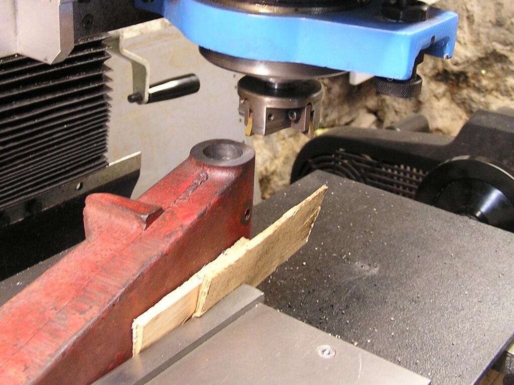

ri702bill 13,068 #6 Posted October 2, 2025 (edited) I use the milling machine to fix a front axle, with an upgrade or two. First setup is to drill / ream the pivot thru hole and install sleeve bearings from each side. I also face the the outer ends of the bore to be smooth and square to the bore. Play is taken up with shims at assembly. Second setup - I use the pivot hole to help hold the axle square for machining. As the underside of the axle wears, there is excess vertical movement. I remove material on the bottom to allow using either a flange bearing or the thrust washer / bearing stack and only leave .010 to .015 vertical movement. Next, the spindles them selves may have spots that are excessively worn - those get TIG welded up and filed for a proper fit. There should be just a bit of preload on the wheel ball bearings to immobilize the inner races so they do not spin on the shaft. Shim accordingly. Reinstall axle and install a new set of adjustable Heim rod end tierods. This allows you the center the steering wheel and get proper 1/8" toe-in alignment. Finished product is better than new.... Edited October 2, 2025 by ri702bill 6 Share this post Link to post Share on other sites
kpinnc 18,967 #7 Posted October 3, 2025 7 hours ago, ri702bill said: I use the milling machine to fix a front axle, with an upgrade or two. I think I know where I'm sending my next axle to for repairs... VERY nice setup! 4 1 1 Share this post Link to post Share on other sites
Handy Don 17,474 #8 Posted October 3, 2025 (edited) 20 hours ago, ri702bill said: I use the milling machine to fix a front axle, with an upgrade or two. I got to watch part of this process on a 312 axle. As is so often the case, observing someone having the needed skills and tooling and carefully doing the multi-step setup and preparation was fascinating. Seeing the machine taking off a couple of thousandths on each pass was almost hypnotic! 20 hours ago, ri702bill said: I remove material on the bottom to allow using either a flange bearing or the thrust washer / bearing stack and only leave .010 to .015 vertical movement. Thrust bearings (standard on the swept 520-H) noticeably eased our steering effort. Importantly, while that axle was being overhauled, I discovered that one spindle’s lever arm was bent. How'd it happen? I don’t know, but that surely contributed to the wonky steering. Edited October 3, 2025 by Handy Don 4 Share this post Link to post Share on other sites

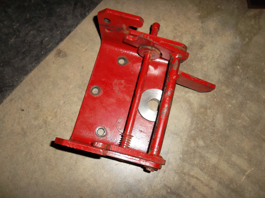

Lee1977 7,772 #13 Posted October 6, 2025 (edited) On the 1973 and later models you can take most of the axle movement by fixing the front hitch. We drilled out the front hitch and made a 1/2" thick stepped bushing that was welded in. Also made a new over sized pivot pin. Can't post pictures as the Government site I used is shut down. Edited October 7, 2025 by Lee1977 2 1 Share this post Link to post Share on other sites
