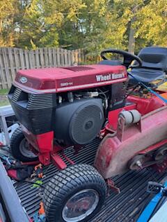

Krice58 181 #1 Posted October 1, 2025 Late 90s 520H, runs and drives just has a leaky tank, but I have some spares. Comes with 48” deck. $400, good deal? Share this post Link to post Share on other sites
lynnmor 9,040 #2 Posted October 1, 2025 (edited) Depending on condition that can be a real deal or just one step above a parts tractor. Photos would help us evaluate. Edited October 1, 2025 by lynnmor 1 Share this post Link to post Share on other sites

lynnmor 9,040 #9 Posted October 1, 2025 5 hours ago, Krice58 said: Late 90s 520H, runs and drives just has a leaky tank, but I have some spares. Comes with 48” deck. $400, good deal? Not a late 90's, possibly one of the first 520H's. Appears it has a straight front axle, if so that is a minus. Broken tab on tank might mean broken mount. Seat is spent. Belt guards on mower missing. We need real photos with a high resolution, the current one isn't very useful. Share this post Link to post Share on other sites
Krice58 181 #10 Posted October 1, 2025 6 minutes ago, lynnmor said: Not a late 90's, possibly one of the first 520H's. Appears it has a straight front axle, if so that is a minus. Broken tab on tank might mean broken mount. Seat is spent. Belt guards on mower missing. We need real photos with a high resolution, the current one isn't very useful. Sorry, I was only about to get the one photo, got dark on me. I’ll get more tomorrow. After running the number it is an ‘89. I do have the belt guards, just have to put them on. Sorry for the dumb question, but how do you put higher resolution photos on here? Every time I try to, it tells me I’m over the file size. Do I have to use like Flickr or imgur instead and post link? I’ll have to check that mount, I know they snap off sometimes. Share this post Link to post Share on other sites

Ed Kennell 47,362 #13 Posted October 2, 2025 Straight front axle makes it an '88 or '89. The good news is the motion control is NOT on the steering tower. 1 Share this post Link to post Share on other sites
JoeM 10,268 #14 Posted October 2, 2025 can’t get much these days for $400. if it runs good you did well. 1 Share this post Link to post Share on other sites
kpinnc 18,967 #15 Posted October 2, 2025 Front tires look new. If it runs, you could sell parts and make money back. 17 minutes ago, Ed Kennell said: The good news is the motion control is NOT on the steering tower. Agreed 100%!!! 2 Share this post Link to post Share on other sites
davem1111 2,356 #16 Posted October 2, 2025 53 minutes ago, Krice58 said: Sorry for the dumb question, but how do you put higher resolution photos on here? Every time I try to, it tells me I’m over the file size. Do I have to use like Flickr or imgur instead and post link? I’ll have to check that mount, I know they snap off sometimes. The answer, as @adsm08, gave you above, is "yes", that is, unless you become a supporter of the forum, which is really a good deal if you want to just post your pictures and not hassle with outside sites and links. BTW, from that picture, it looks to be worth that price to me. I've paid more for tractors in worse condition. 2 Share this post Link to post Share on other sites
