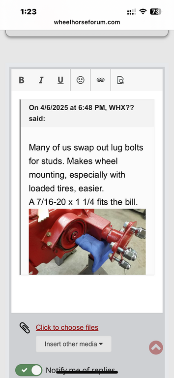

SylvanLakeWH 30,923 #3 Posted September 29, 2025 From @WHX?? post: 4 Share this post Link to post Share on other sites

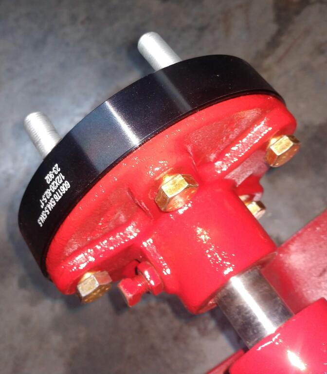

kpinnc 17,575 #5 Posted September 29, 2025 21 minutes ago, Chaz54 said: 1 1/4 inch long is longest you’ll find. No need for anything longer. I've used this size on all my tractors and they work as stud for wheels and for using spacers. One suggestion- use 4 bolts per wheel and keep one open for the OEM bolts. One hole is very close to the setscrew for the hub (see pic below) and makes loosening the setscrew a bit tricky. Use 7/16×20 bolts on the other four for each wheel from the back with lug nuts and they will line the wheel up nicely so you can add the 5th as a bolt from the front. Most lug nuts are 1/2×20. Make sure you get 7/16×20 lug nuts. The jungle site has them cheap. 1 3 Share this post Link to post Share on other sites

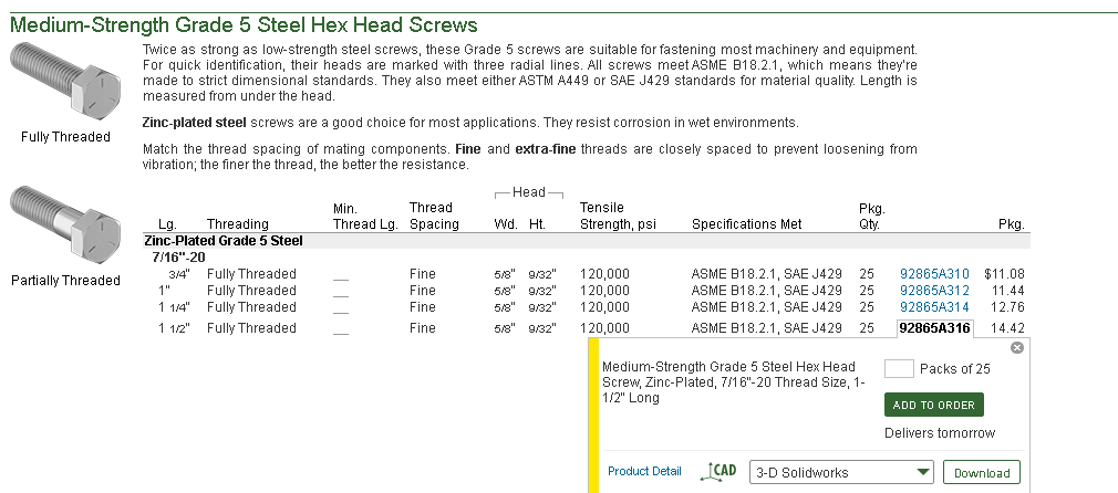

JoeM 9,709 #6 Posted September 29, 2025 I've used these 1 1/2" long ones from MMC and they work fine. Use with removable thread locker. 242 3 1 Share this post Link to post Share on other sites
ri702bill 11,617 #7 Posted September 29, 2025 An observation - the underside of the hex heads on the bolts seem to not be seated on the back of the hub, most likely due to the last thread at the head being imperfect. With the hub removed, I like to clean up the hub and chamfer the back of the hole to allow the hexbolt to bottom... 2 Share this post Link to post Share on other sites

oliver2-44 11,333 #9 Posted September 29, 2025 29 minutes ago, JoeM said: I've used these 1 1/2" long ones from MMC and they work fine. Use with removable thread locker. 242 I recently bought the above 1-1/2" bolt from McMaster. They are not quite full thread. i contact4d them and they said the 1/6/ 3/32 is what industry considers full thread. so a flat washer is required on the back side, or make a small relief in the threads on the back side of the hub (which I don't exactly care for so i go the washer route. 1 1 Share this post Link to post Share on other sites
WHX?? 55,830 #10 Posted September 29, 2025 (edited) 1 hour ago, ri702bill said: underside of the hex heads on the bolts seem to not be seated on the back of the hub, I see that Bill. Like KP's pic....I used thick flat washers too. I don't think yours are going anywhere KP ... we just being anal ... Edited September 29, 2025 by WHX?? Share this post Link to post Share on other sites
kpinnc 17,575 #11 Posted September 29, 2025 2 minutes ago, WHX?? said: .I used thick flat washers. I don't think yours are going anywhere KP ... we just being anal ... No worries at all. The washers definitely would be preferable. 1 Share this post Link to post Share on other sites
